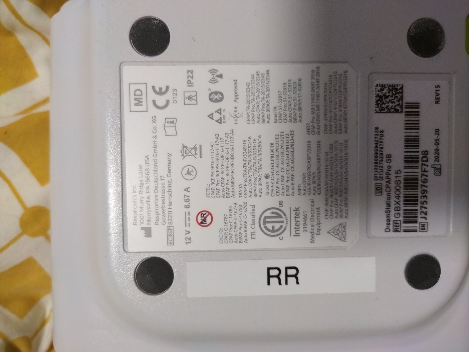

What are the power requirements of the CPAP?
Sorry.
It's been a very long day. I'm struggling...
Shoulda got grade 1 CSE Maths.
Philips say that my DreamStation should use 60W, not 80W.
So, 60W for 8 hours is 480Wh
I'm tired!
Sorry.

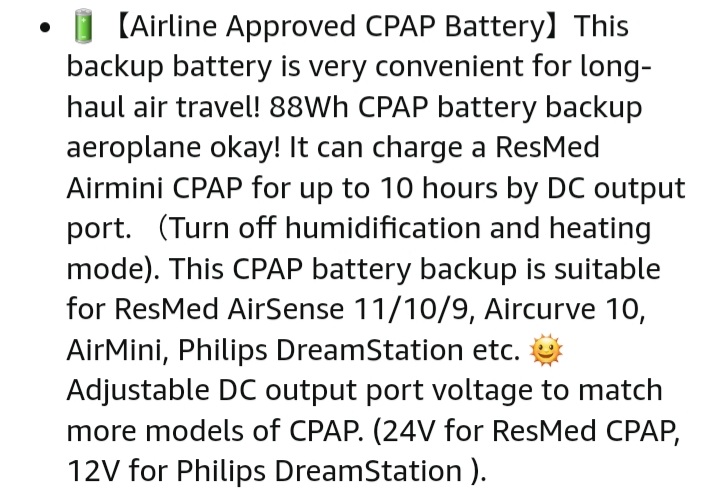

This one is not available either, but it reckons it is 100Wh and can give 24h use with a DreamStation.
This one says it will run CPAP as long as it's no more than 60W.
It also has a 12/24V adjustment. But how does it output 12/24V on a USB A?

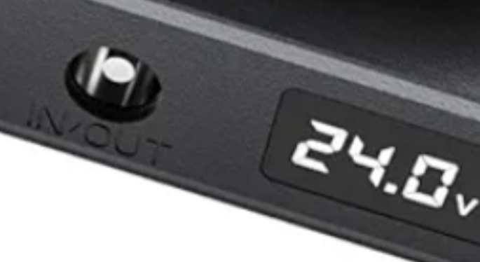

This particular unit, uses the in/out port for the 12/24V output...
And there are some caveats (which will be similar to any 100Wh battery pack) to achieve the claimed 10 hours operating time...

And measure how much current it needs rather than the plated value, 6.6A is a substantial draw if it's doing it continuously from a battery but I bet it's not
And I bet, that's why turning off the heating and humidification modes makes a big difference.
