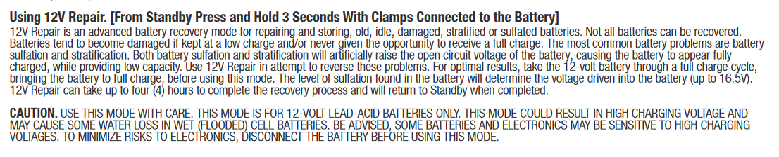

The only reason I was concerned it needed disconnecting was a video on youtube that analysed the pulse repair mode of a charger similar to mine. He mentions briefly about the voltage being as high as 16v on pulse repair, which he says "is probably not good for car electronics even though there are probably protections on the car side" (or something along those lines)....I'll have a watch through for it again
This is the excerpt from the manual regarding the pulse repair mode.
