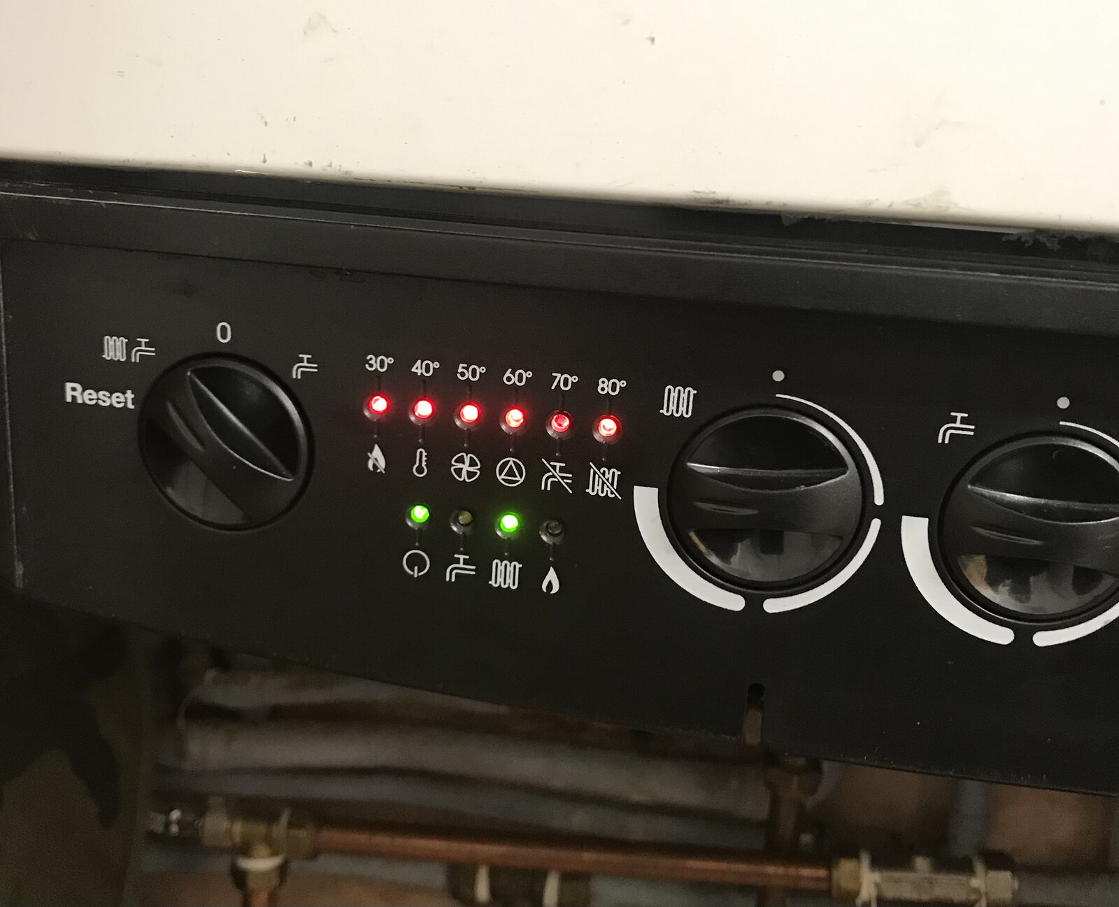

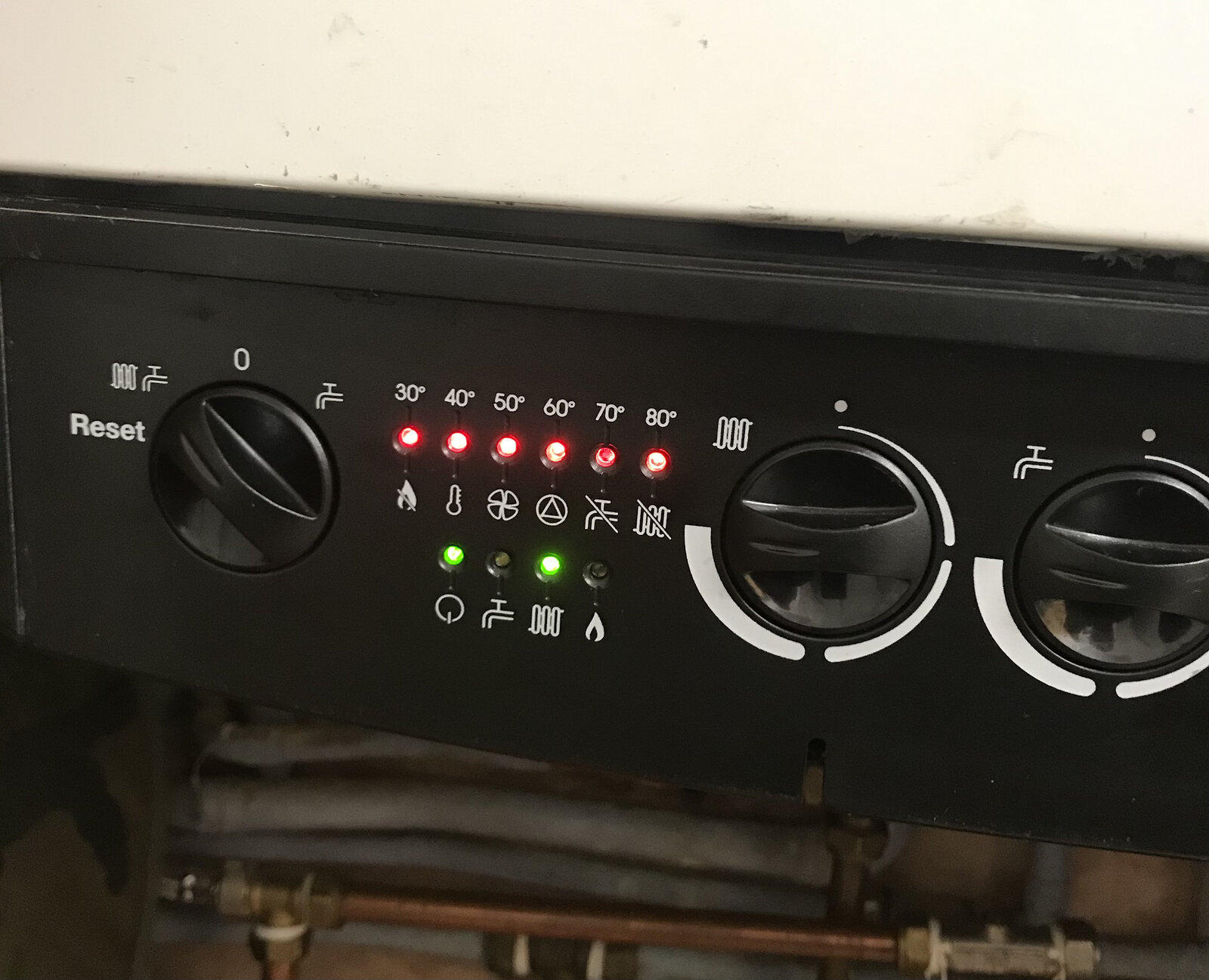

I had a pump as a spare and the pin stays up fully when it shuts off as you told me to look for
No I didnt, the pin stays fully up when the pump is running, it fully retracts when the pump stops running, if the pin is staying up with the pump off that is your problem
But the pump seems to be running and the temp lights are all on even though the burners off B013E66D-FB73-49C4-9F5D-E4AA5B42B10E.jpeg
Took it off cleaned it all up prodded the hole put all back together same thing is still happening

Turn the boiler CH thermostat down low does it still go to 80 deg ? it looks like it is cycling on the Hi limit thermostat
