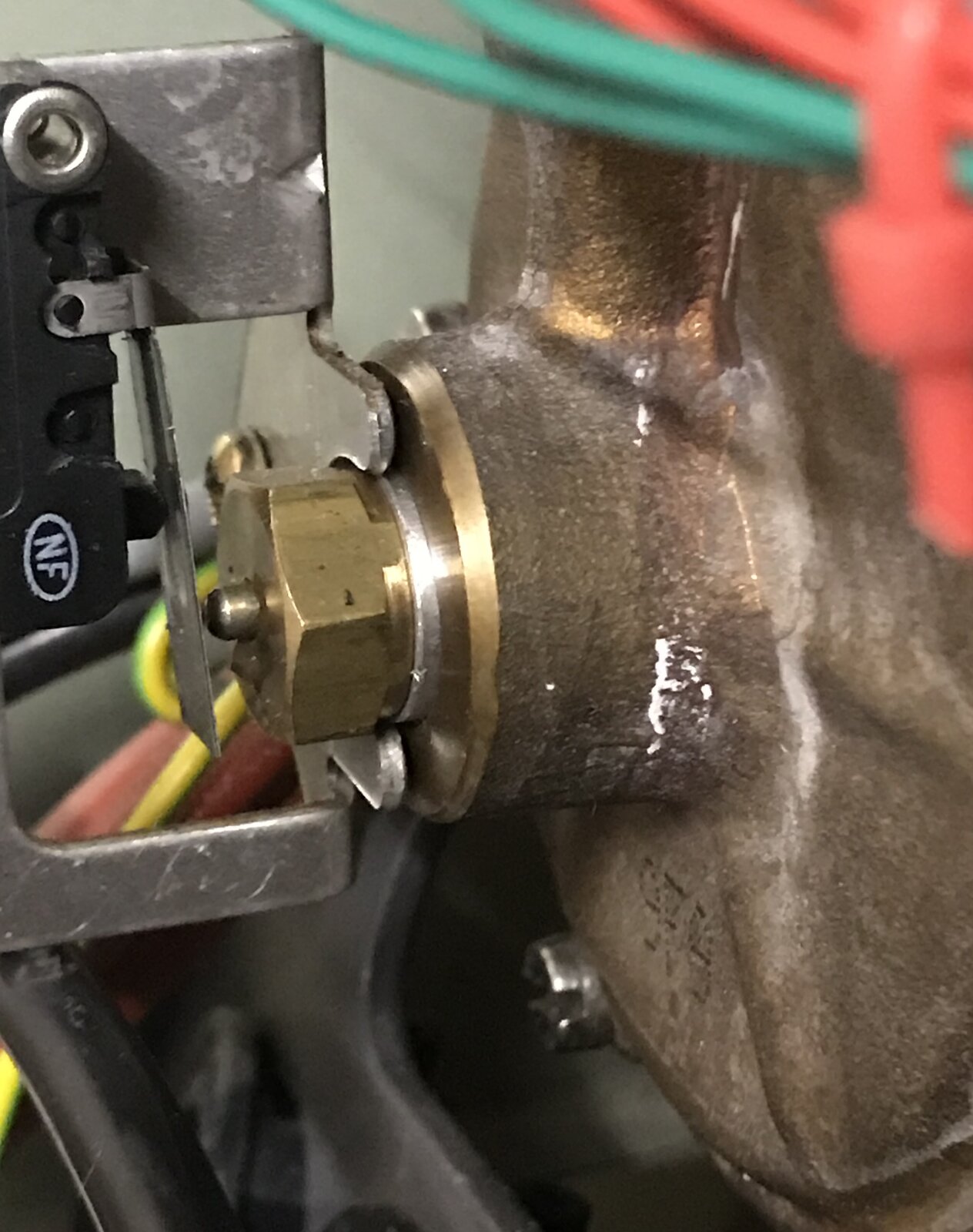

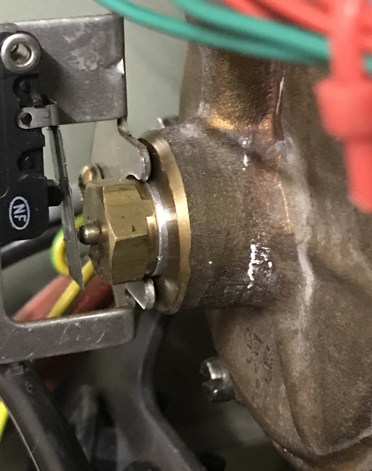

with nothing on is the pin on the FRONT diaphragm fully retracted back into housing or is it sticking out a bit but not reaching the microswitch (pic if possible)
I believe the pipe works all under laminate floors here's a pic of the pin it's slightly out but not reaching the micro switch and the valves were ok
