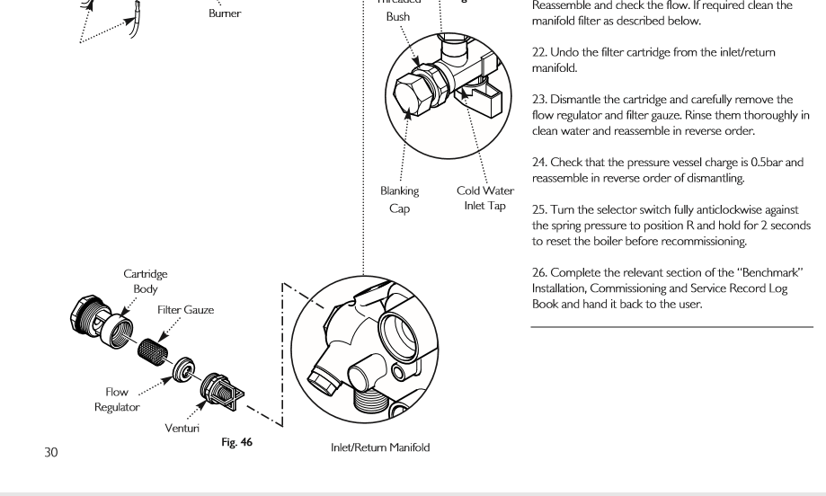

    Exact Model of boiler is Baxi Combi Instant 105HE
  15. picasso

    Then you need to have the venturi changed, its a small part inside the boiler that affects the hot water delivery, picture of the part below.

    Is that venturi change something i can do? Is it as easy as it looks?

    The boiler pressure has no affect on the hot water delivery, increasing the pressure will do nothing, the symptoms you describe are typical of a broken venturi as its normally the shower not providing hot water is the first sign, its not a difficult job changing the venturi if you have some mechanical experience.
    Go to 2.20 for the venturi...
