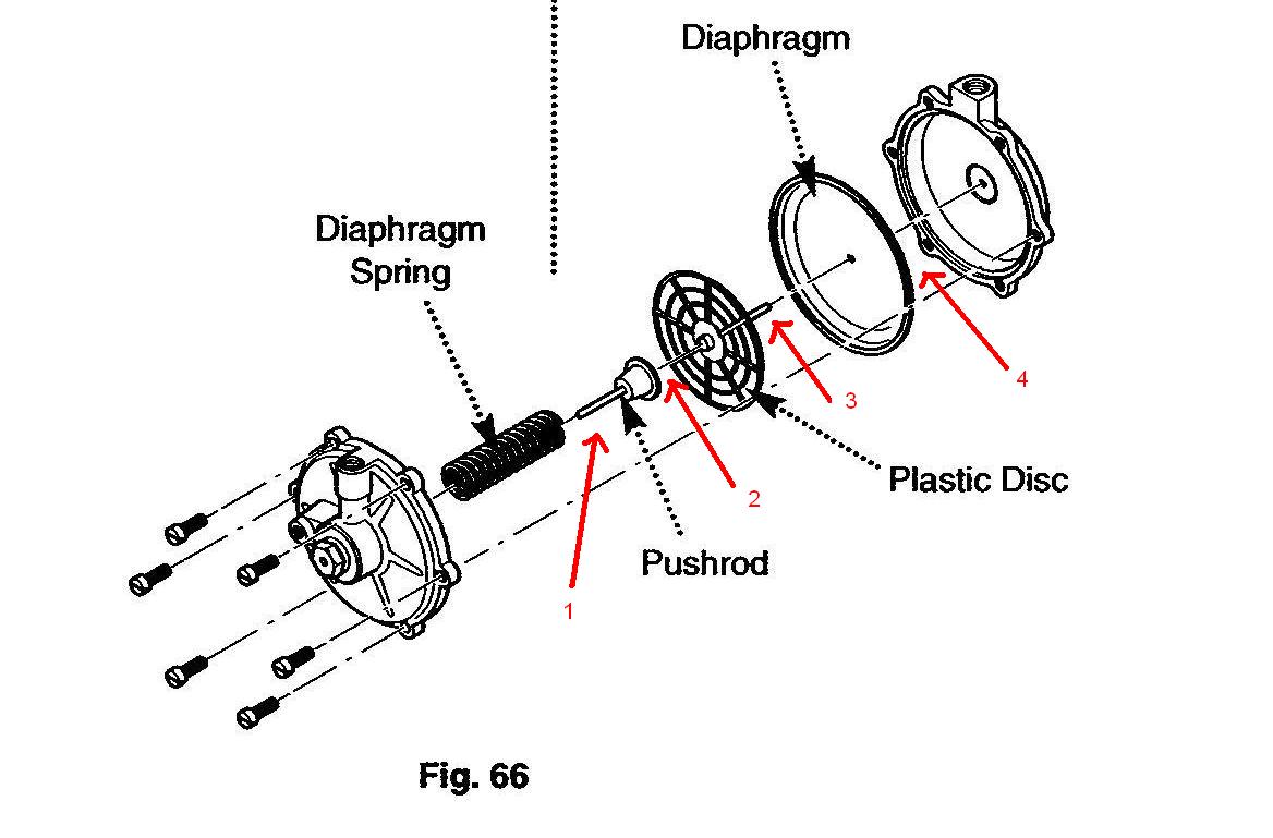

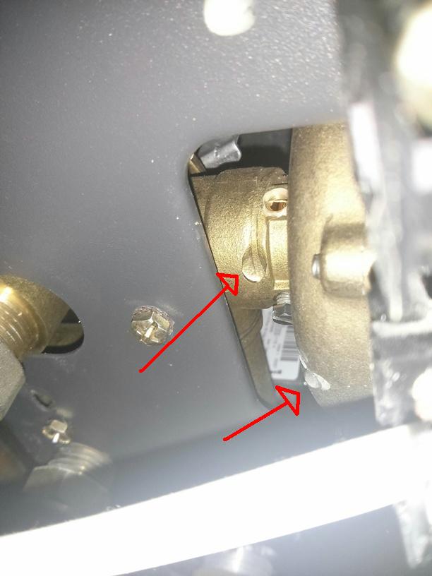

My Baxi boiler is leaking small amounts of water (dripping), it seems to be leaking at the back of the DHW pressure differential value and where the grub screws go on. I have included a pic and page from the manual of the boiler, with arrows point to where the drips are forming (see below).
Any suggestions as to what is causing the leaking of water and what i need to do to stop it please?

If pressure going down then its the fancy nut. You can get them on their own. But you must ensure the spindle is totally clean otherwise the new seal will spoil quickly.
But if pressure not going down its the tiny "O" at the back of the diaphragm assembly.
Neither are the easiest job but it depends a lot on the available access particularly from underneath.

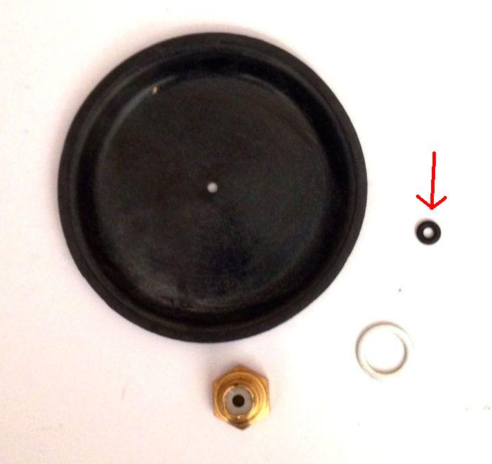

is the o ring that you guys are referring to the one in the pic below please?
Yes, that's the one that fits the rear seal of the DHW housing. Remove the hex nut, prize the old one out and fit new seal. This is best done with the diaphragm housing stripped down. Cleaning the pushrods is vital.
thanks... so i basically do what i did before when the leak as at the pushrod end.. get the same kit and replace the same parts essentially?
here is the kit i used before:
http://www.ebay.co.uk/itm/Baxi-Comb...ue&clk_rvr_id=860275030504&afsrc=1&rmvSB=true
Or can i just buy the o ring separately

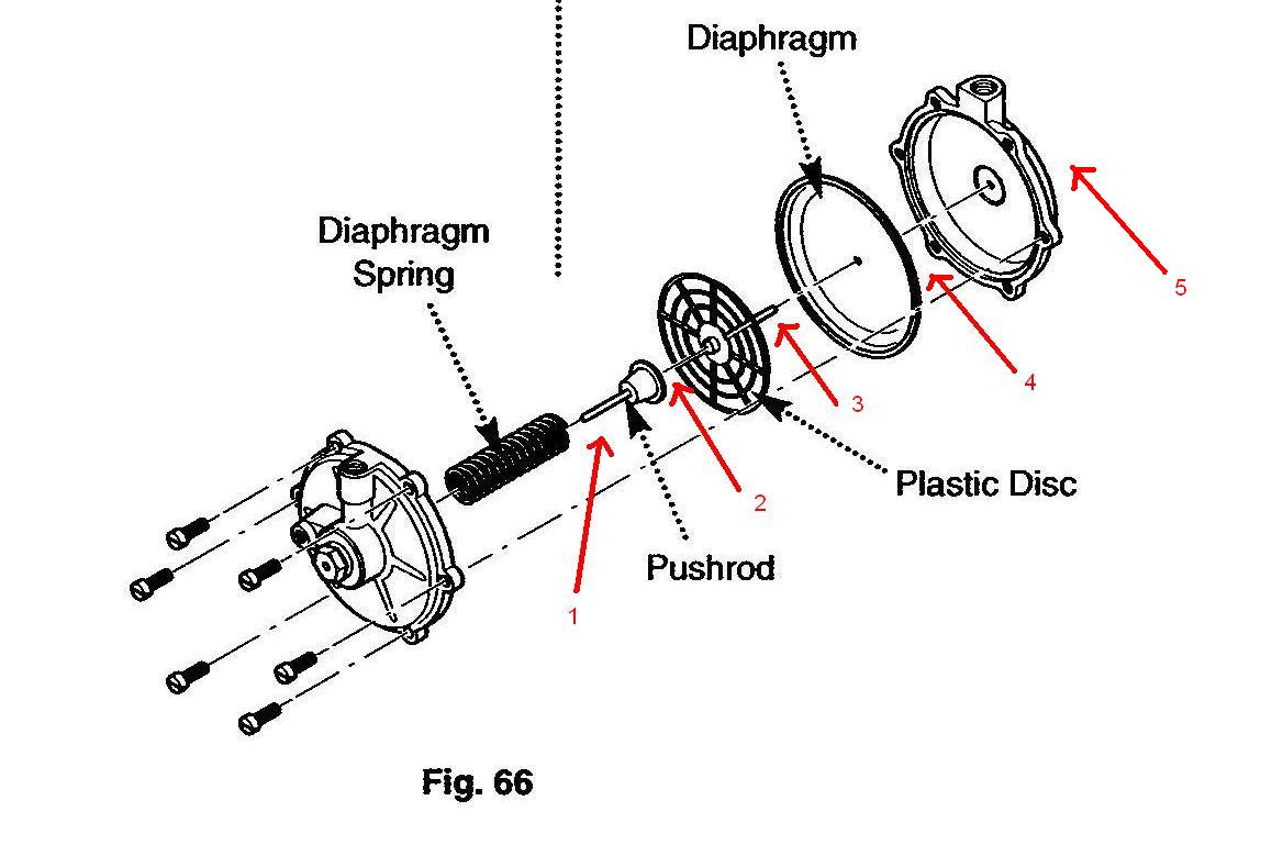

Also where does the o-ring go... position 1, 2, 3 or 4 on the pic below please?
Thanks again for all your help guys it is much appreciated :)
Not shown!
Its on the right hand side of the most right hard part !
Tony
so it goes outside the DHW pressure differential value?? Position 5 on the updated pic?
Your help is much appreciated :)
