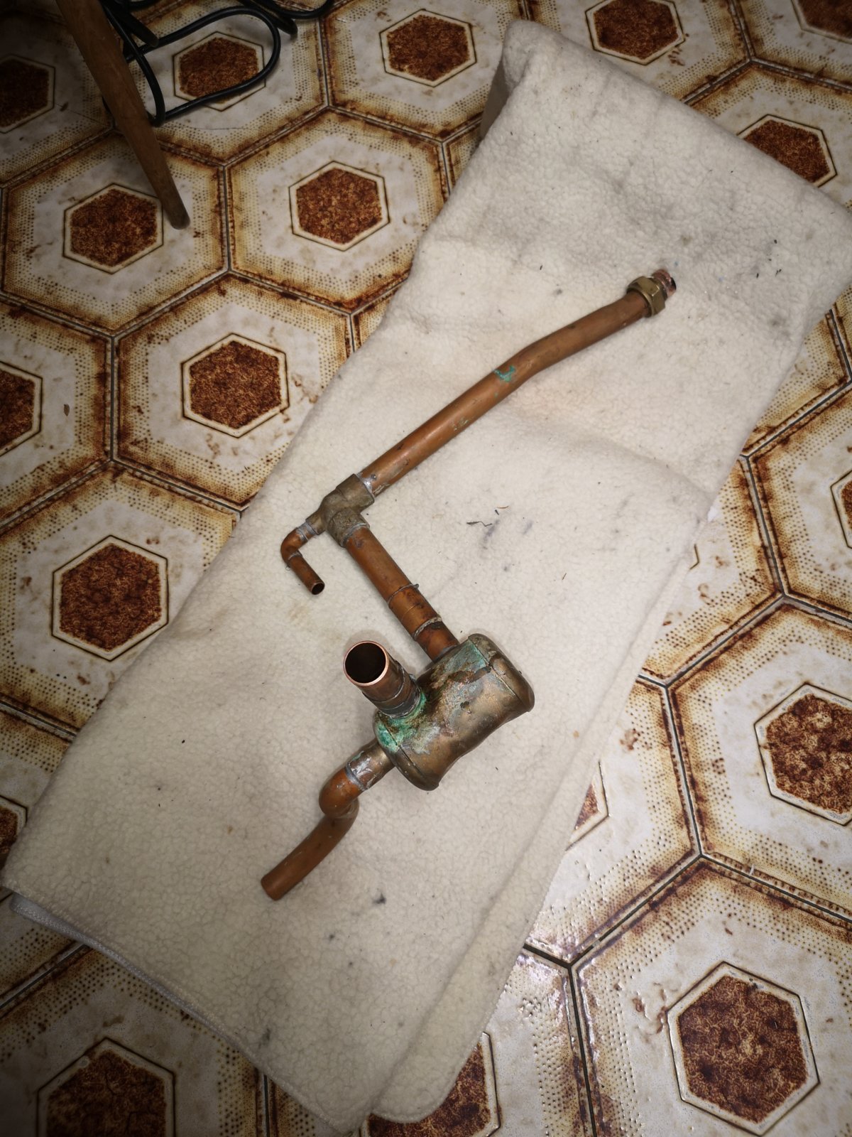

I think you will find this is the one you removed................and not 'one I made earlier'

You only have to look at the kitchen floor tiles to guess when the CH system last had some professional attention! :eek::ROFLMAO:
Ok and there I was thinking I was getting advice from genuine people. For your information, on examining the old pump, it was knackered. The changeover valve was also jammed solid. The F and E was emptied and all the slimey crap flushed down the bog and tank cleared. One of you advised the balancing, which apparently now is bulls**t. Cheers guys, but by all means carry on giggling if it make you happy
