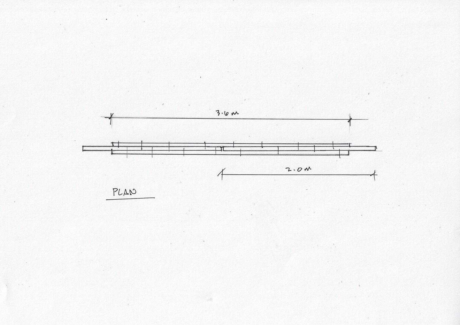

So I want to run a timber beam beneath them and put posts up from the beam to support the purlins. The beam needs to be 4m long.
I want to make the beam from laminating lengths of 2x12 together rather than using steel as i am working on my own. The longest length of timber i can get through the hatch is 3.6m. (Beam needs to be 4m). So my question is , is there a way of bolting say 4 lengths of 3.6 together to make a 4m length beam with comparable strength to full 4m lengths. I can make a hole in the gable end easily enough and that seems best but was just curious if bolting shorter lengths to make a longer length is possible.

What about this design ?
"You could splice 4 together with a 400 offset on alternate beams to give you 4m. This would be fine as the bending strength you need is not at the ends."
As long as you've got 2 thicknesses at the middle of the span (where the bending stress will normally be greatest) it doesn't matter that there is a split in the middle section of the built-up beam.
At the ends where there is only one thickness, bending stress is insignificant - only shear stress matters there, and a 2 x12 timber will be more than adequate.
Thank you. I think the beam will be good.
