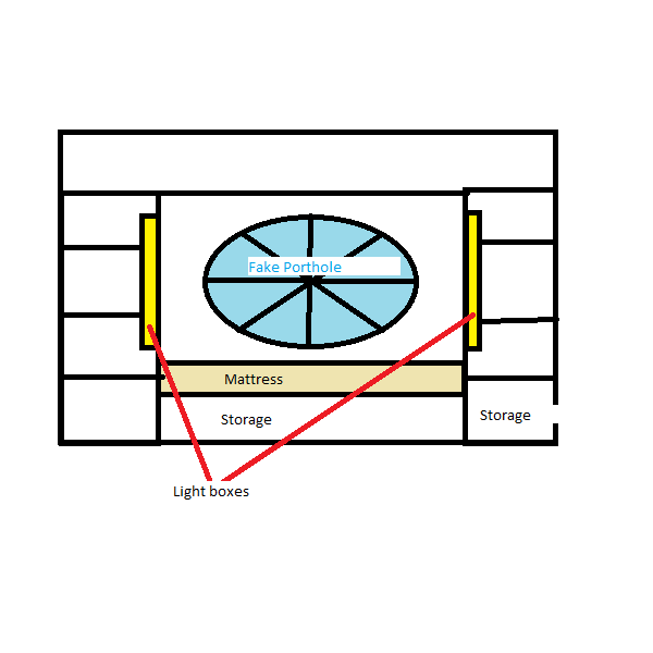

I'm moving house soon and I'm looking to make my 4 yr old son the most awesome bed ever: He got diagnosed with autism back in January so we are going to town on his room with sensory displays etc. but in a spaceship/rocket/star wars theme.
Anyway the bed idea I have has storage built in underneath and to both sides of the sleeping area - to either end of the sleeping area I plan to have a light box with RGB colour changing led lighting (yellow area on diagram) - the light will be diffused through frosted acrylic and shine through holes cut in the side of the sleeping area to get something like the wall lights in this picture:http://www.wallpaperup.com/40314/St...orridor_movies_interior_film_sci-fi_tech.html
Anyhow, obviously I want this to be safe - I'm assuming I will need to vent the lightboxes at least at the top - drivers etc. will be mounted on the 'roof' or rear wall of the bed - well out of small arms reach but is this kind of setup even allowed - I'm assuming at the moment it is (having seen beds with TV's built in) but maybe with some restrictions?
I doubt LEDs will create enough heat for heat to be an issue.
As long as the drivers, wiring etc are kept well away from little fingers and any mains stuff is in proper enclosures I don't see a big issue. Just don't use cheap Chinese stuff off ebay.

Cheers - that is exactly what I'm planning on using.
