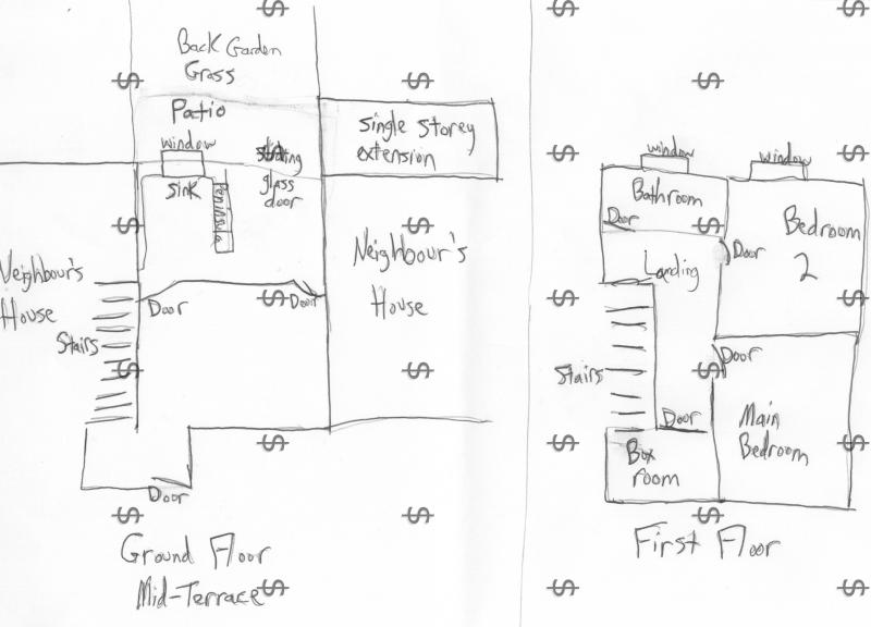

Hi,
Attached is a drawing of current house layout. Excuse my feeble artistry skills and also the $ signs (pre-viewing some scanning software!).
Neighbour's fences are on either side of our garden and neighbour to right has a single storey extension. I guess most likely place for ours is on the back.
We'd love to have extra bedroom but not sure how weird it'd be to have it right behind kitchen and dining room. Double storey extension would probably do the trick by putting it upstairs but that'd be megabucks and not sure about neighbour's light issues.
I think it's 3.5 meters deep and 6 meters wide roughly so probably about 21 meters squared so roughly £21K as a guideline? I thought about a conservatory which would probably be cheaper but it's north-east facing and I've heard they get very cold in winter or else you use lots of gas/electricity to heat it.

Well... there is scope to extend out the back, whether it be single or double storey is another question. You're right in as much as the neighbours would loose light if you were to erect a two-storey extension and some LA's use the 45 degree rule where the maximum depth of a two storey extension is goverened by the centre line of a neighbours window (to a habitable room) to prevent loss of daylight.
To get professional guidance and advice, it may be worth speaking to your local planning authority for their comments. You'd be building right on the boundary line too so you would have to look at serving a party wall notice, which a surveyor/building control officer can advise further. It's a shame your property wasn't extended the same time as the neighbours. Were you served with a party wall notice when the neighbours carried out their extension or was it already there when you moved in?
