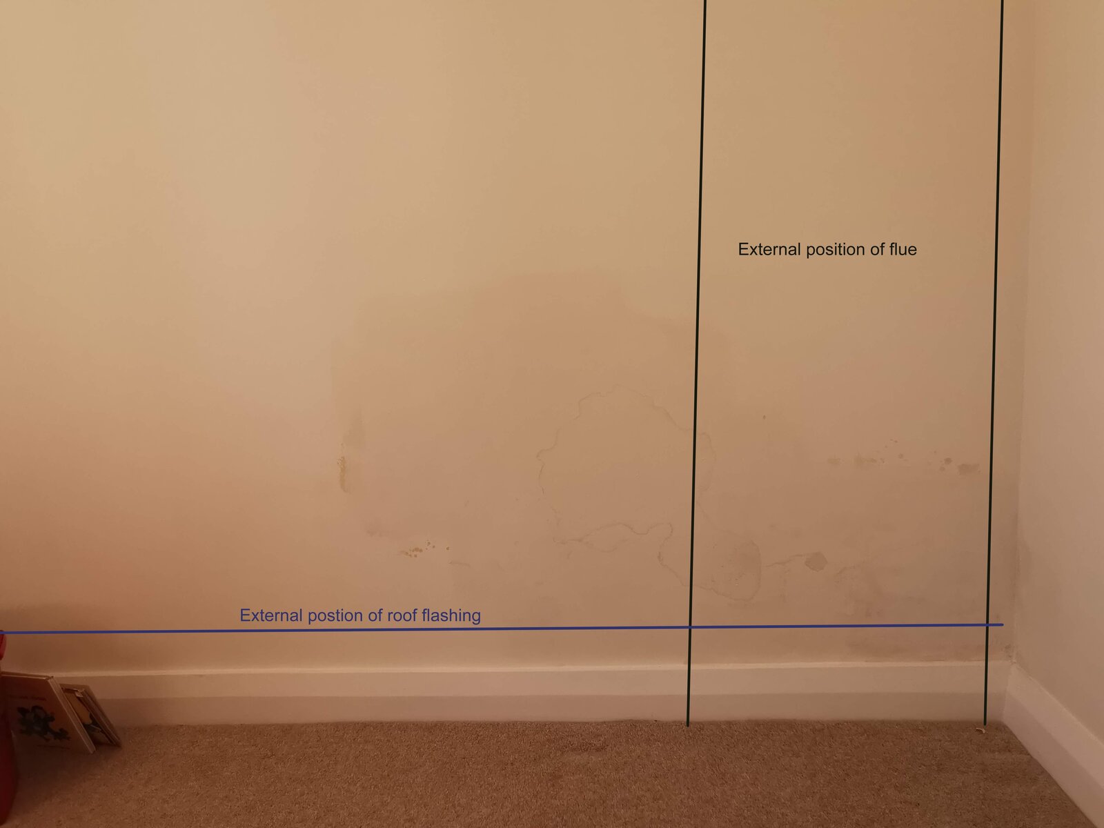

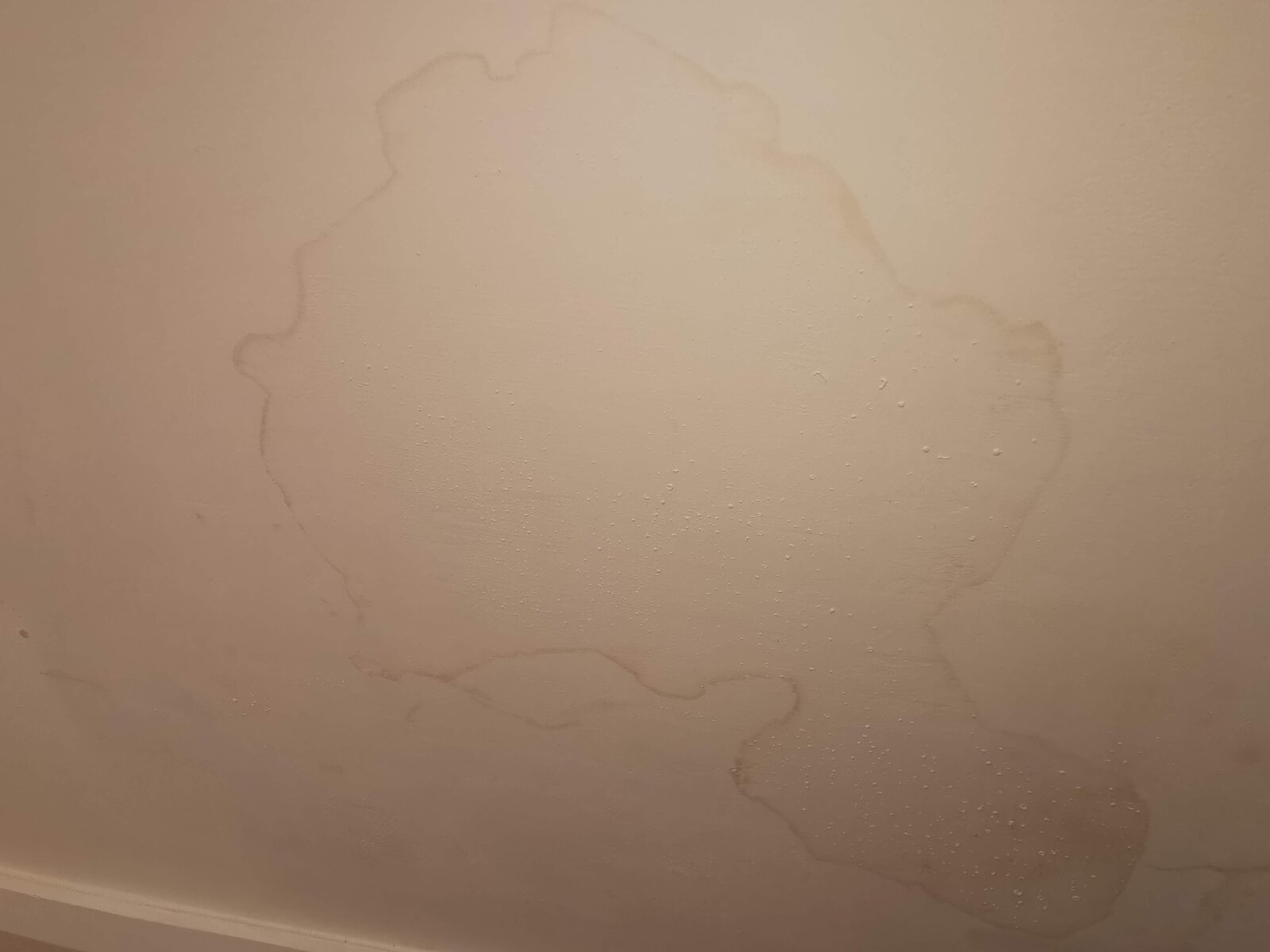

I've been trying to get to the bottom of this problem for years - and hoping someone might be able to throw some light.

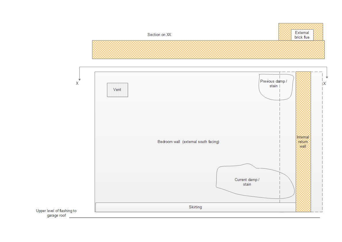

We have a damp /stained patch about 1m sq in an upstairs bedroom that starts just above the skirting. Its a solid external wall with painted pebble dash rendering externally. I figured possible cuplrits are:
1) Flashing where garage flat roof joins the same exetrnal wall at about the right height. However the patch is random in shape and not consistent with position or run of flashing.
2) External boiler flue chimney. This is not used and is now open at the top (although not open to weather) and capped at the bottom (in kitchen). Its position does overlap some of the damp / stains but again does not follow a consistent position. I am pretty certain the flue is dry as there is no evidence of damp where it is capped at the bottom.
3) Moisture trapped behind the external render.
3) Ventilation issues.
I have attached a rough sketch.
4 years ago the problem was mostly at the top in the corner of the room so I was blaming leaking roof / gutter / flue chimney flashing. I removed chimney & extended tiles, checked gutters etc. Not the slightest bit of difference (although it didnt seem to get worse after rain anyway).
So I hacked the internal render & plaster back to the brickwork and applied a solution to neutralise possible salts resulting from flue. Waited 6 months. Had wall re rendered (with sand & cement & waterproof agent) & plastered.
Top corner is now dry - and problem has now moved to lower area as per diagram.
I have used stain blockers of every type and they just bubble up & stain comes right through.

At the moment you are moving the damp penetration from place to place.
Looking for damp signs, have you carefully examined the ceiling and wall in the room directly below?

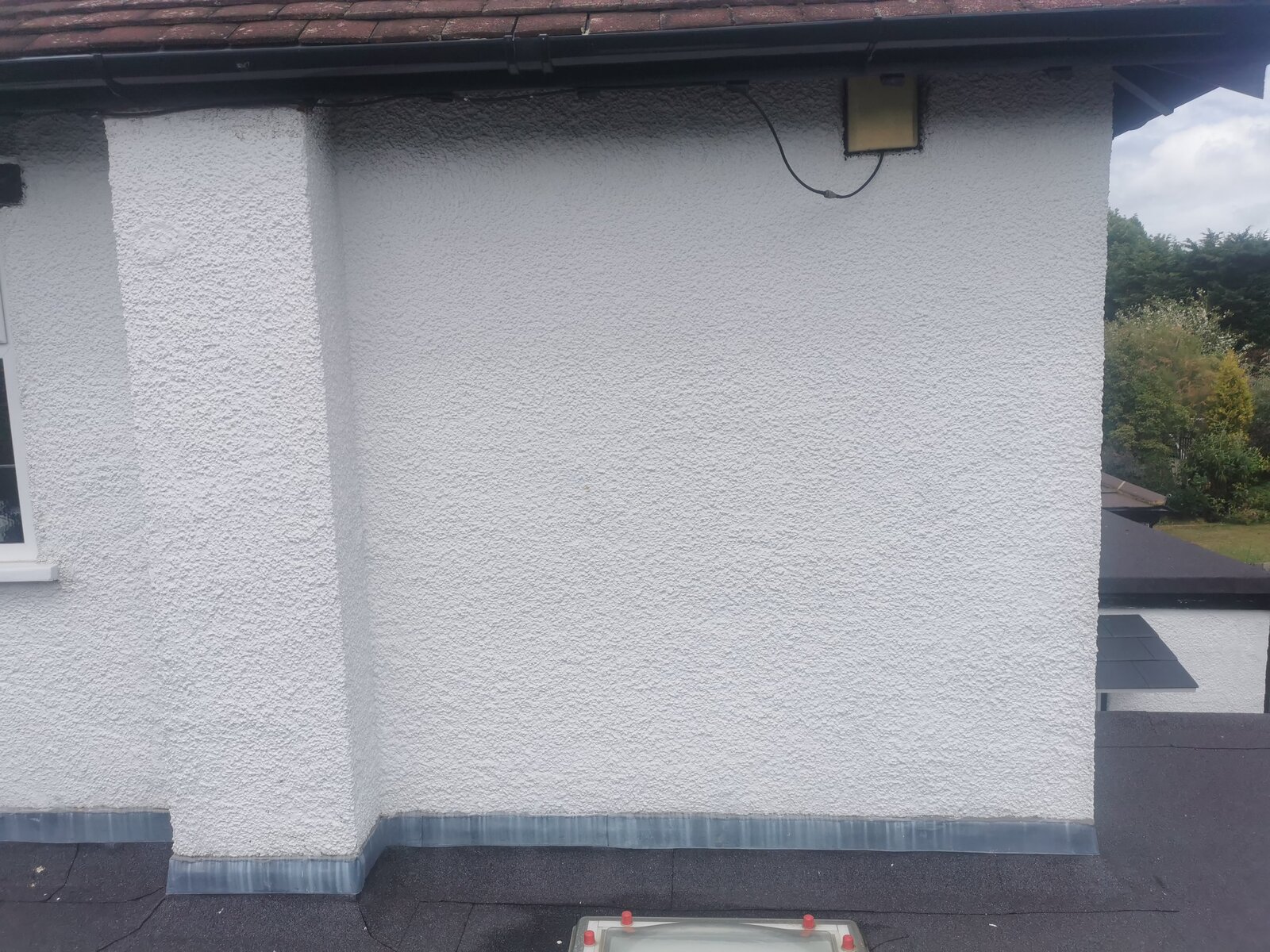

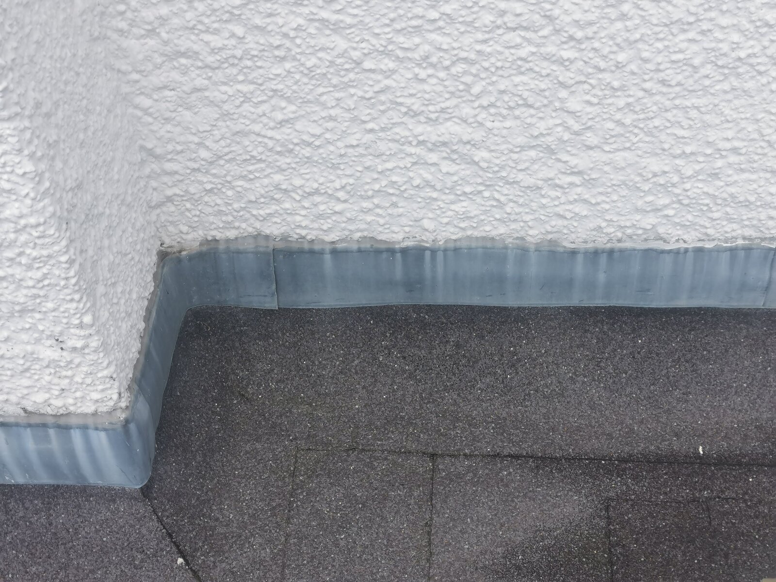

Why not show a pic of the outside of the wall - pic the flat roof abutment with the external wall - a pic of the external chimney breast - and pics of the flashing and flaunching/capping of the chimney terminal?

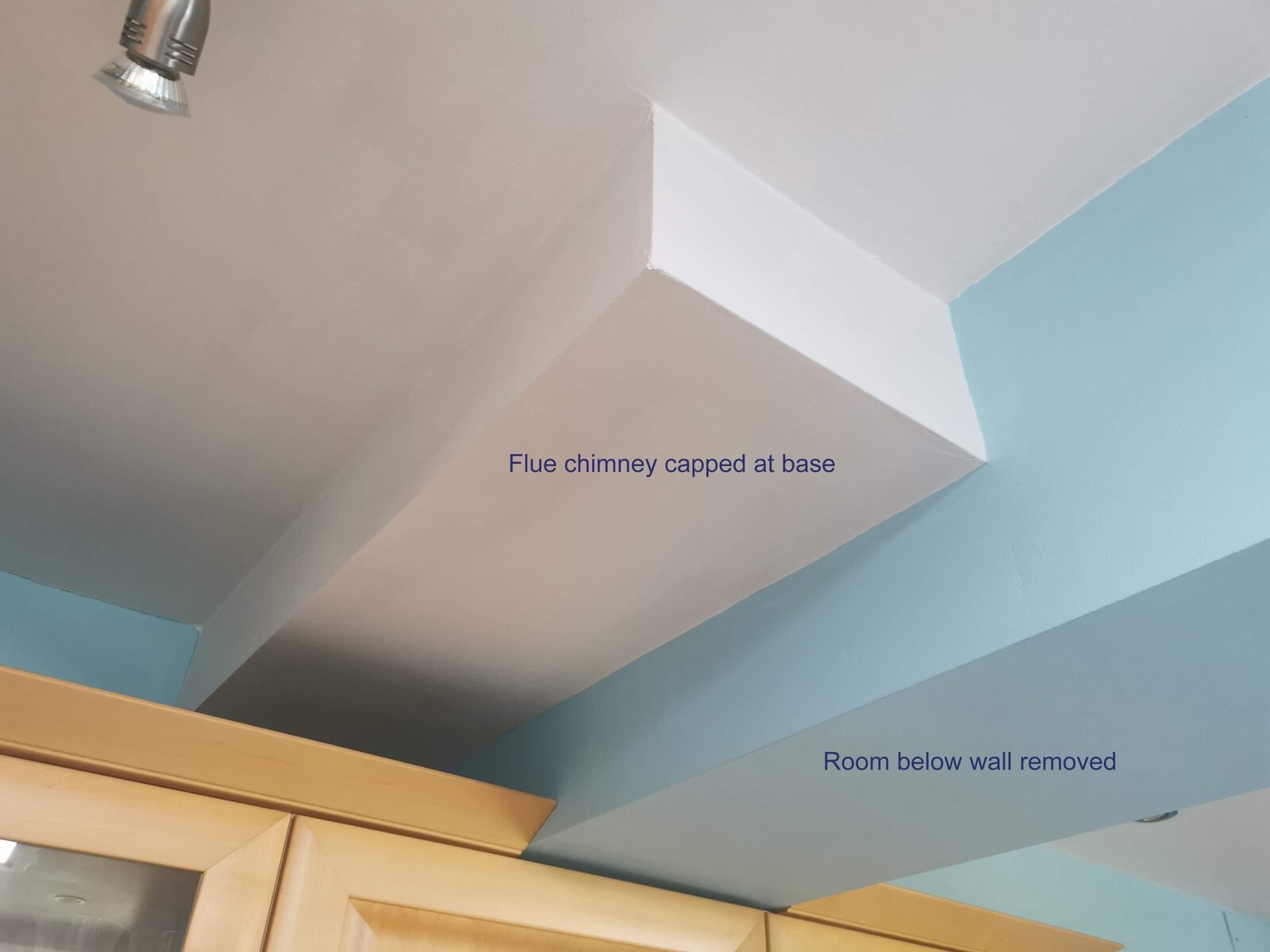

I have attached a few more pics. They do seem to point to the flue chimney as being the culprit. I am 99.9% sure water is not getting into the chimney but have had my suspicions it could be condensation as it is only open at the top (inside roof). It was capped at the base 20 years ago at ceiling height (as per pic). Perhaps an air brick at low level in the chimney might help - or else complete removal...?

2. it seems the kitchen previously probably had a solid fuel fireplace.
3. why they left that remainder of capped flue chimney breast "hanging" below the ceiling i dont know?
4. In the long run (or whenever you decide) it would be best to remove the whole of the old chimney breast from kitchen ceiling to eaves soffit.
5. Hygroscopic salts from the abandoned and partially vented flue are probably penetrating the solid wall.

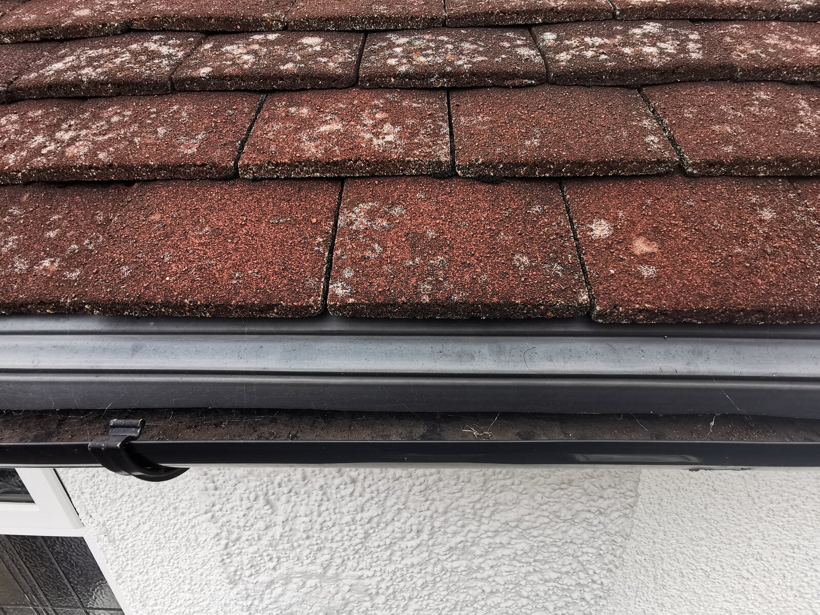

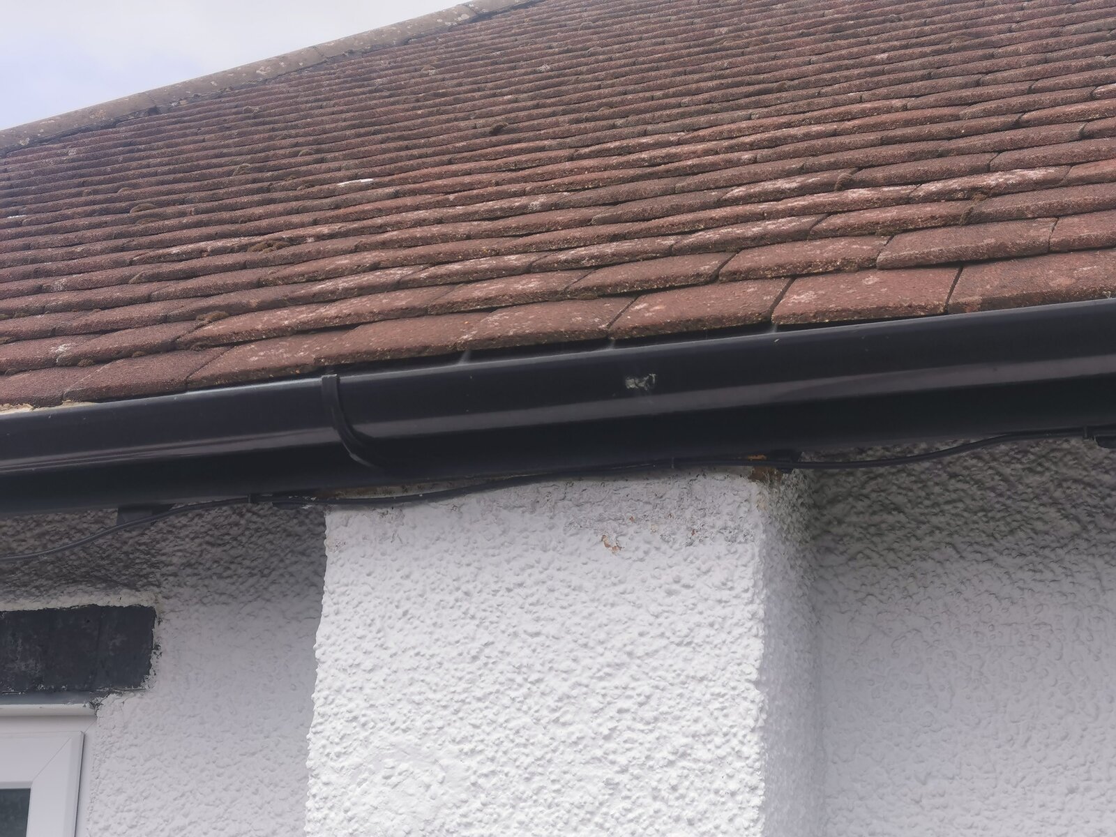

8. standing on the flat roof with a selfie camera & stick you could pic the gutter and first course of tiles?

3) We had the kitchen wall removed to enlarge kitchen. Yes we should have had the chimney breast removed at the time but it wasnt in budget - hence just capping it at the base.

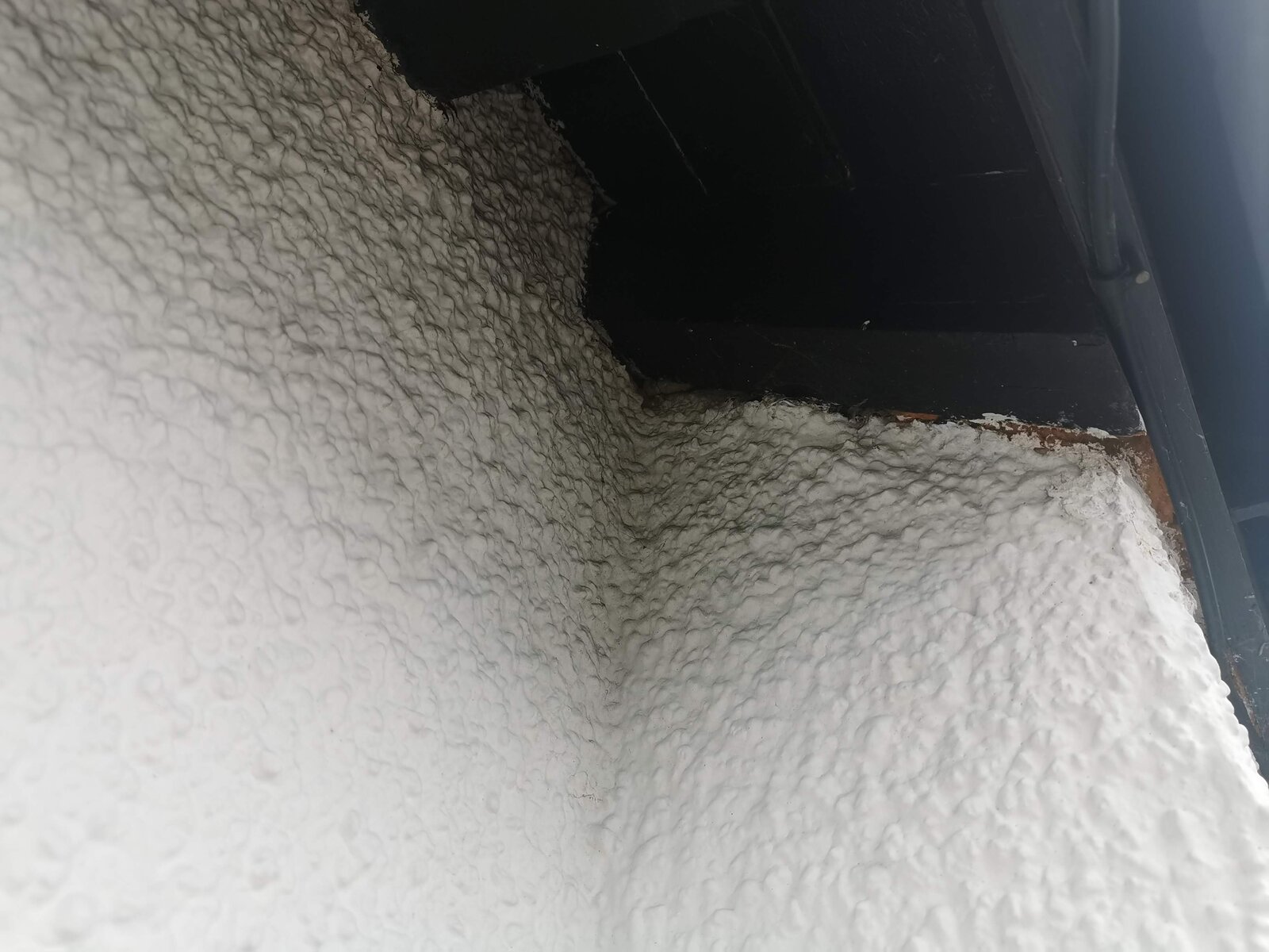

8) The grey plastic diverter is inserted between 1st & 2nd row of all tiles. (I have done this for the whole house as roof didnt extend far enough into some gutters). Coupl eof extra pics showing chimney breast running up between roof timbers.

Yes, thats the position for an air brick.
The roof felt is supposed to go over the "plastic diverter" (AKA a felt supporter) & discharge any moisture into the gutter.
Your gutter is 1/2 full with debris.

Have I missed a picture - I see no debris in the gutter ?

Re gutter - its just a thin layer of dust washed off the roof - although agree might look a bit deeper. FYI the roof has no felt - its tiled directly onto timber slats. Makes for a dirty loft...
