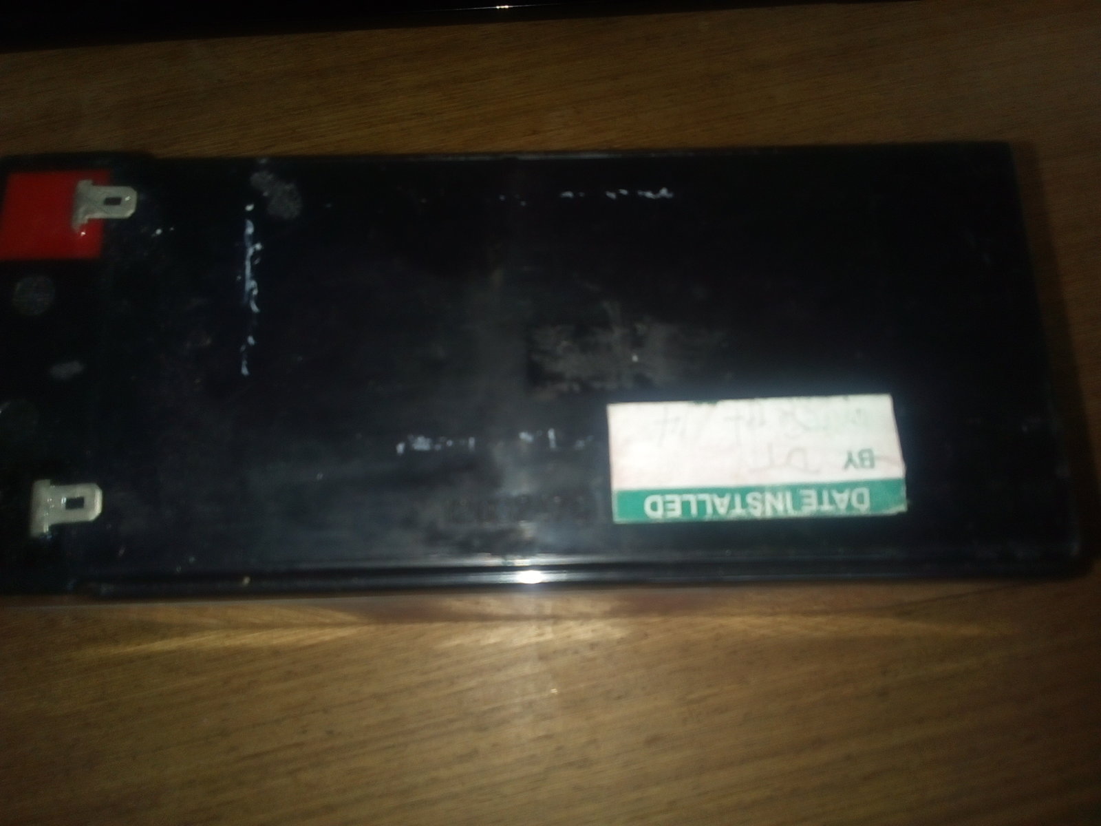

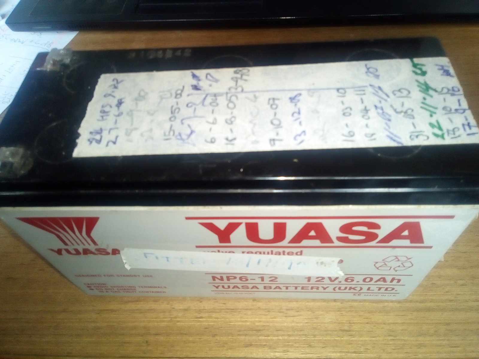

Batteries on trickle charge if done correctly should have a long lifespan. I replaced one in a UPS last week so it's still standing here.
Tha annual test of the 170VA UPS is with an ACT battery tester to ensure the capacity is above 80% of original then load with 160W of lamp bulbs (4x40W) and ensure it lasts for 10minutes. This battery still passes that test.

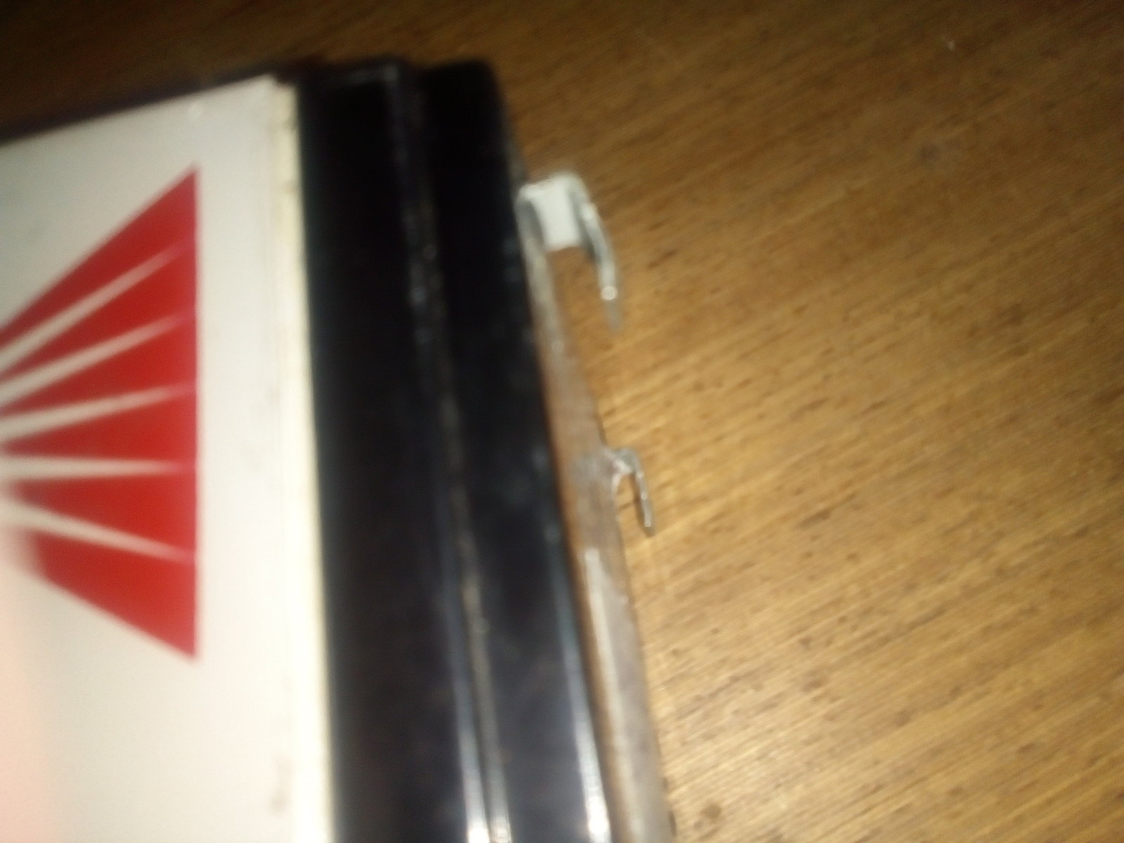

I pulled it from service because there is now a significant white deposit on the +ve terminal, the remains of which shows less in this pic than I expected.
I felt quite sad that I pulled it just 6 weeks short of 18/11/19 or 21 years so it didn't come of age:cry:

That particular battery was taking 7mA of trickle and 4.7A after discharge
The mobility scooter with VRLA did around 25 years, and father-in-laws chair lift around 10 years, but my mothers stair lift would need new batteries every 2 years, measure the voltage with mothers it was around 30 to 32 volt, but I would have expected no more than 28 volt, more like 27 volt, I think the idea was a average of 27 volt when lift used 6 times a day, but it was only used around once a week I would put all the bins on it to take them down stairs.
28V is too much for this type of battery on constant trickle, I think the spec sheets say something like 14.2 but in my experience that will make them fail in about 2 years. At college some 35-40 years ago we learnt 2.27V per cell or 13.62, the battery in the pic was set to 13.64 (2.273V) and at the end of the 10 minute test it was at 11.82V having been discharging at >15A (by cheap clamp meter and known to be inaccurate).

The charge current was 4mA at 13.63V and the ACT tester indicates >6.5AH capacity:
