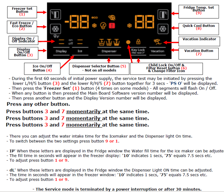

I recently purchased and installed a replacement ice maker into my Beko ASP341X American style fridge freezer. It is making ice as expected, but the water fill time is too short, so is only filling about a third of the ice tray. Not the end of the world, but clearly is taking a lot longer to fill the bucket.
I've heard and seen ways to adjust this fill rate using a menu within the panel on other models, but can't seem to find how to do it on this particular model.
Can anyone help?

probably a float switch that may have some adjustment on it, the mechanism or switch will be near the ice tray
Thanks for the suggestion. There doesn't seem to be anything that I can adjust on the actual unit i'm afraid.
Thanks in advance for any more suggestions from anyone.
To anyone who may also have this problem, I have managed to get Beko to send the following instructions. Worked for me so hope it helps others.
