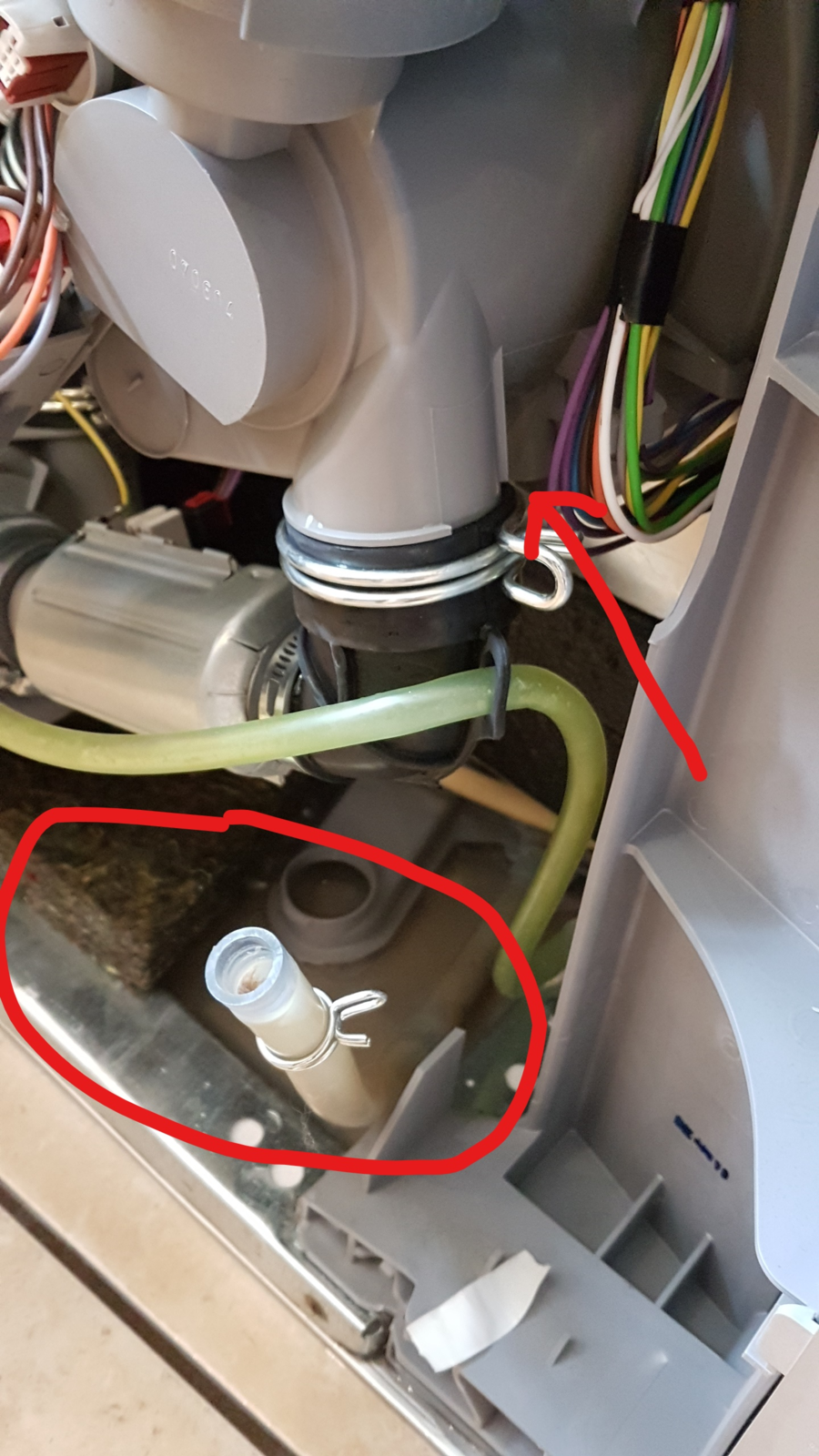

Mine too is a DW602 and tonight I have fixed it. I removed the bottom front panel, 4 star screws. Then I found that the following pipe was not connected. I cleaned both the internal of the flexible pipe and the part it attaches to as they were quite greasy.
2 minute job to fix but a pain to put dishwasher back in. All working splendidly now.

View attachment 97991 Mine too is a DW602 and tonight I have fixed it. I removed the bottom front panel, 4 star screws. Then I found that the following pipe was not connected. I cleaned both the internal of the flexible pipe and the part it attaches to as they were quite greasy.

Had same problem with Beko DE 2542 FW inset dishwasher. Ran constantly but no water intake and would not shut down (had to pull plug).
slid DW out, put it on its side and removed base plate(4 screws on base, loosened 2x side panel screws at rear bottom).
As others have stated I found a hose disconnected. (wasn't too obvious as behind larger black hose)
CONTITUBE's picture above is almost identical to position of mine.
Seems a common problem. (The plastic hose boss should have been manufactured with a ridge and the spring hose clip is clearly poor quality as not much spring too it).

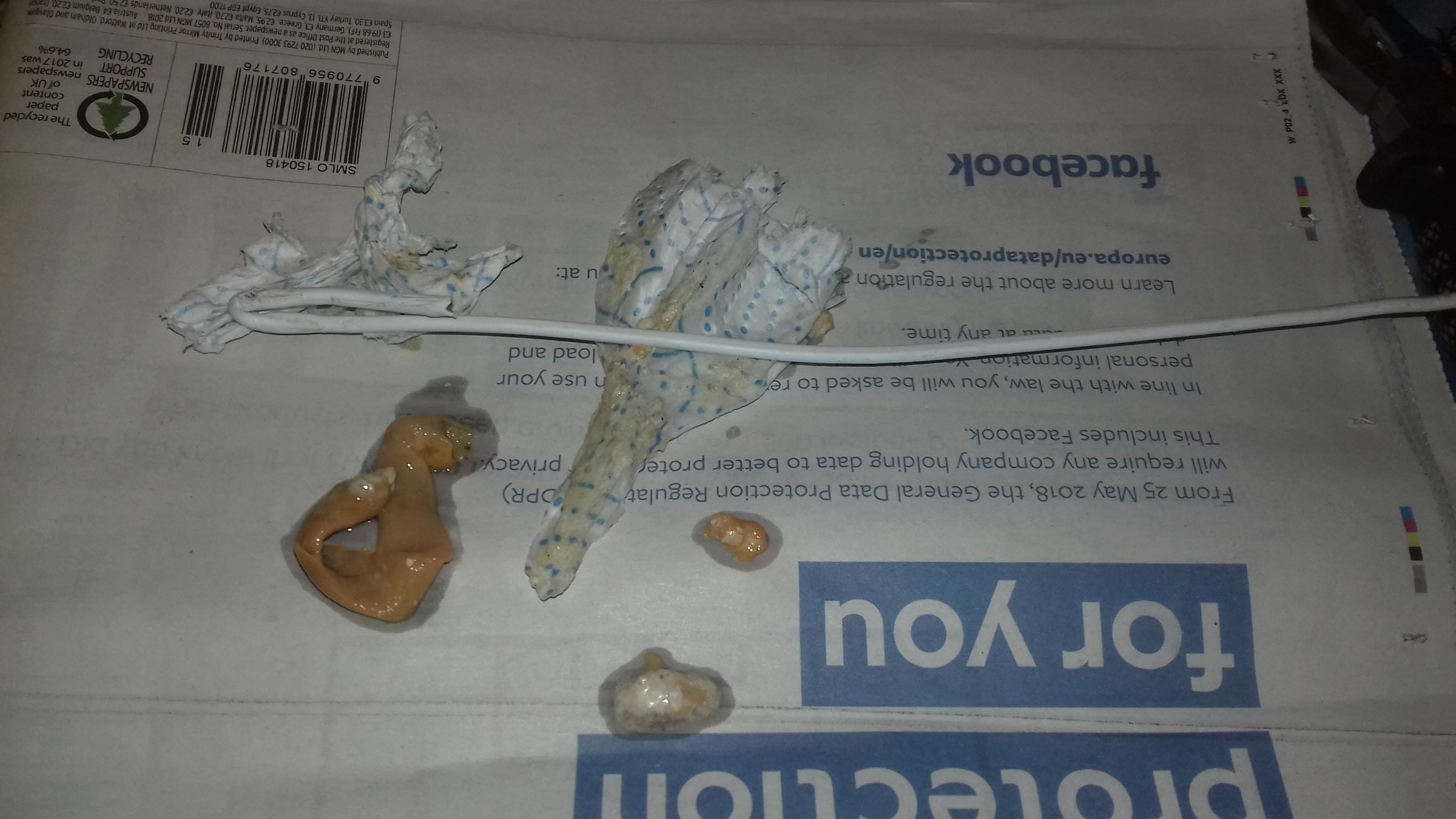

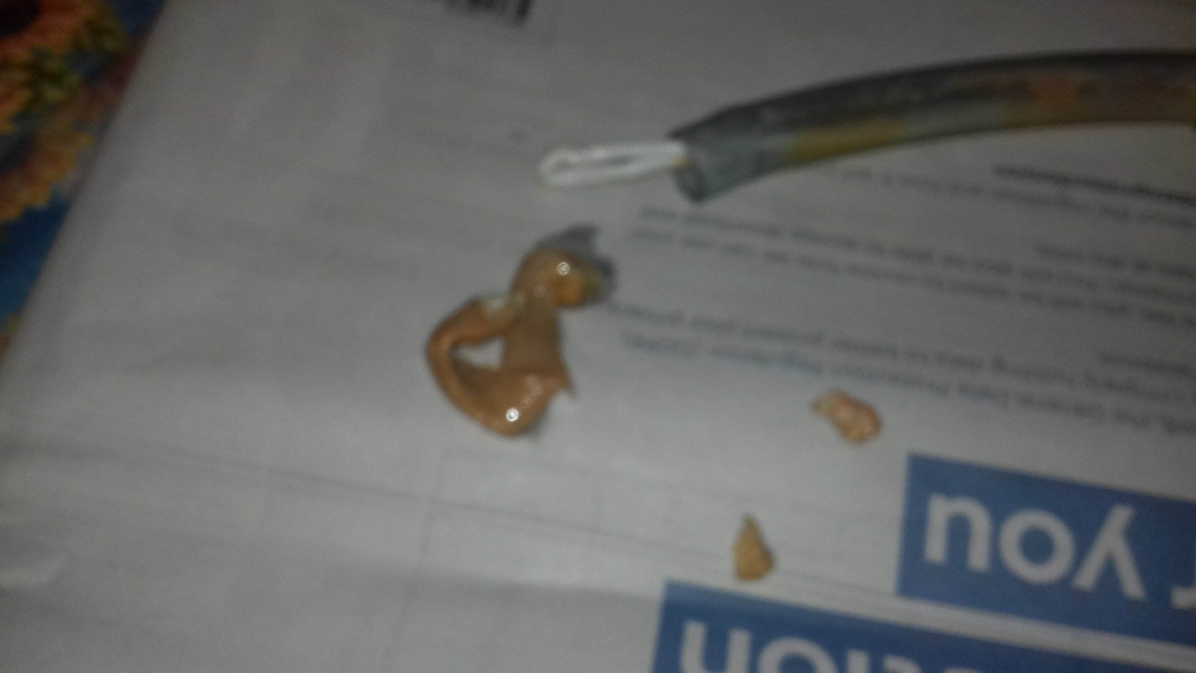

Had the same problem for a while on a Beko DL1243W Dishwasher. Flood switch was activated so tilted machine back and water came out. Small pipe had popped off so I refitted it.. A few weeks later same thing. Fitted pipe back with Jubilee clip. That lasted another week then same again. Refitted it and 2 days later water in base but the pipe was still fitted so I decided to take off the side panel to see where the pipe was connect to. Could see brown gunge in pipe so took it out of machine and cleaned.. Hopefully problem sorted, I can't make out what this pipe does as it connect to the transparent cavity which goes to a hole near the inside top of the machine. At the bottom of this transparent Cavity there is also a large open hole for water to drip into the bas of the unit so I can't make out what the pipe it for and why there is so much pressure to pop it off.
And here are some pics of the gunge..
