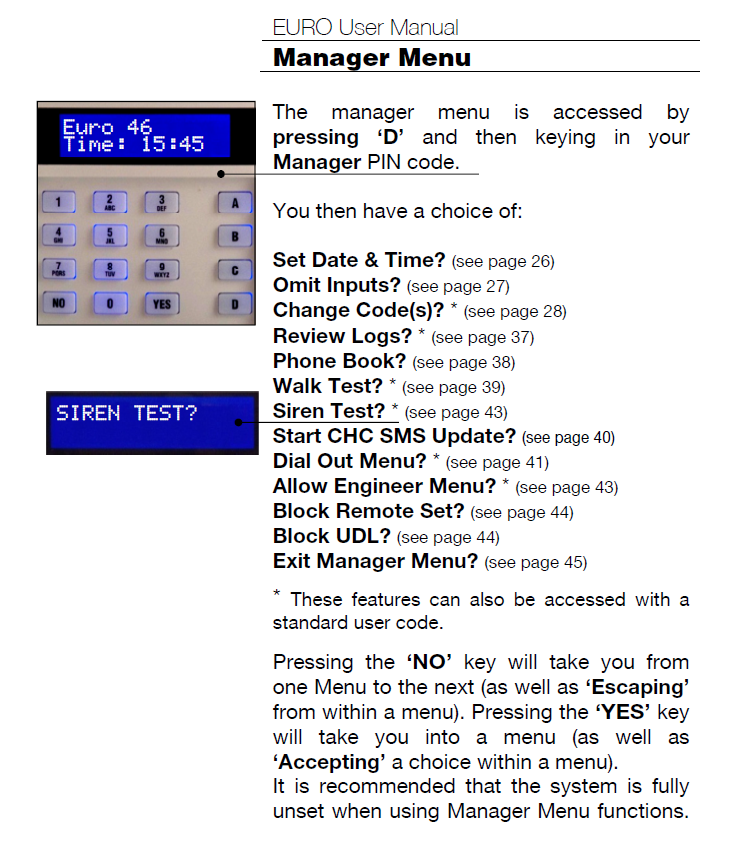

I would do a manual bell test to see if it fires off and annual strobe test to see if that fires off.
The LEDs would flash normally if there is power
The wiring is nothing special.
How do I do a manual strobe and bell test please mate? Don’t want to fiddle about to much in case I make things worse
Taken from the user manual:-
