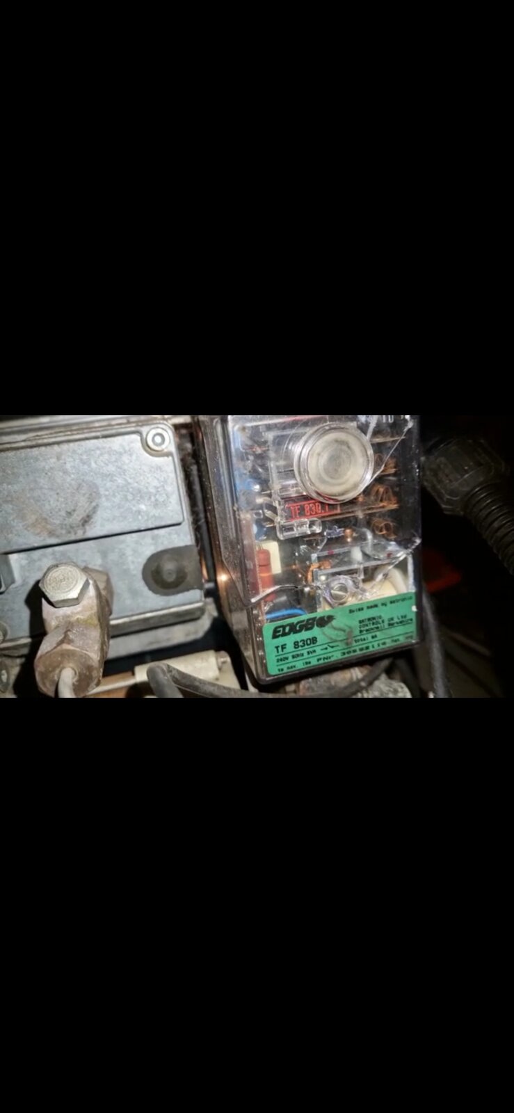

Hi I've a problem with my oil burner and I'm trying to find a download for the user manual to try to resolve.i think it might be my ht leads or transformer.
Unfortunately not mate as I can't see the b11( if that is indeed my make lol) make.i was on that site. Thanks for your reply btw
This is a picture of what's happening. Won't let me upload video..you can see the flash/spark where I think the ht lead is damaged and shorting off metal casing

There's nothing particularly outrageous about the B11.......can you give us the symptoms please?
Basically when you want the burner to come on, the following happens:
The motor starts spinning, the ignition spark is present . This purges the flue with fresh air.
After around 8 sec, the solenoid coil on top of the oil pump is instructed to open, oil flows to the nozzle and ignition takes place.
The photocell sees light, and the oil flow is maintained.
The ignition spark stops.

I'm afraid I can't see where the errant spark is occurring, but for sure it needs to be at the electrode tips, nowhere else!

The motor comes on then this sparking occurs and a smelling off burning.(.not oil burning)it doesn't ignite.

It's not at the electrode tips that's why I think it's the ht leads maybe damaged..these haven't been changed in over 25 years o think..thanks for your help btw

If the leads are arcing out then that obviously needs to be sorted! The leads often just plug into the igniter unit, but some are moulded in.
Knowing the length of them is helpful!

If you remove the blast tube by loosening the 2 captive allen screws, you will expose the electrodes. If you then isolate the burner and remove the control box and put a temporary bridge between the live feed and the transformer feed, when you reconnect the power supply there should be a spark at the electrodes. You will also be able to identify any short circuits in the leads.

Thanks for all your help.got a repair guy out..new transformer ,leads and control box required..hopefully not too dear or if its cheaper a refurbished one
