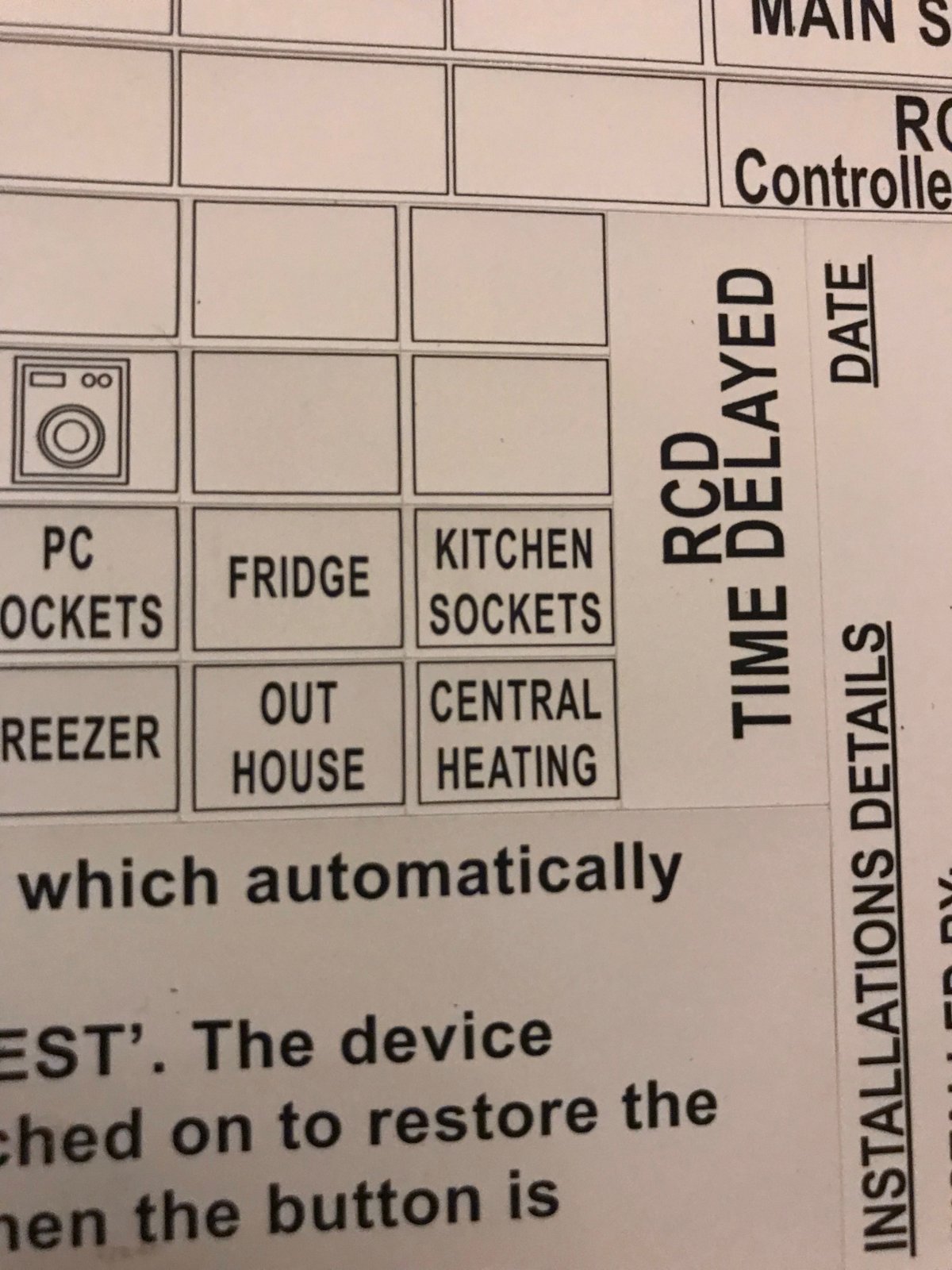

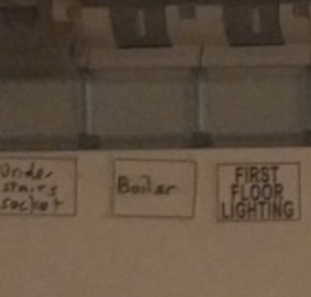

It was more that there appears to be a cable which has slipped down, as you can see the inner cores? Or am I seeing things (entirely possible!).
Your eye sight is good, I actually went and looked at it then went back to edit the original post! I still can hardly see the issue on the screen.
You're right, it's for the outside socket that's not connected yet. Only the sheath is stripped at present because it makes life easier to do it first.
Makes sense! I did wonder how it would manage to slip down if it was connected.

I looked at it, and couldn't see any way of telling whether it was a single-insulated cable with bare copper showing, or a DI/I&S one with the outer sheath removed.
Yes.
It still cannot be determined, either from the photograph, or what JD said, whether it is a single-insulated cable with bare copper showing, or a DI/I&S one with the outer sheath removed.
Ok makes sense didn't realise the context, for the record it's just standard t&e but I've stripped 6 inches and sleeved the CPC (and not taped it in place securely enough)
