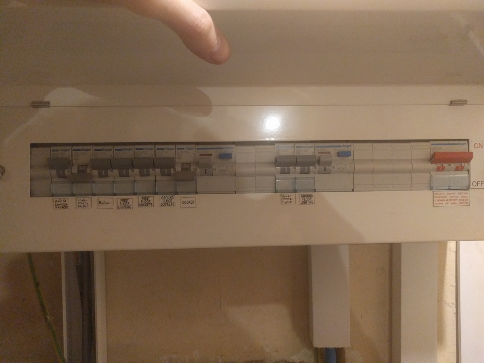

I have a Hager design 10 high integrity with 22 positions ie 16 spaces for mcbs.
The extra cost of the spaces was minimal so I bought the biggest.
Everything seems fine, plenty of space and the MCBs are cheap.
Only issue is the din rail bends down making it hard to put the lid on
On reflection it might just on a down hill, either way it's hard to get the lid on. I didn't mean the rail itself is bent, I just mean it bends relative to the unit.
The lid is hard against the top lip, and the bottom is pretty much in the right position.
The wall may not be flat for all I know though!
Make your own mind up. I'd still recommend it though.
Yea it's likely the wall twisting the body. Had this a couple of times, once you work out where the wall's not level you'll fix that - unless you've overtorqued the screws and totally bent the body :whistle:
I'll go with igg on this one.
Slacken off all the fixing screws and see how the lid fits then. If the fit improves, try tightening each one bit by bit and see if you can see where the distortion is coming from. Then you can pack out the one(s) causing the problem.

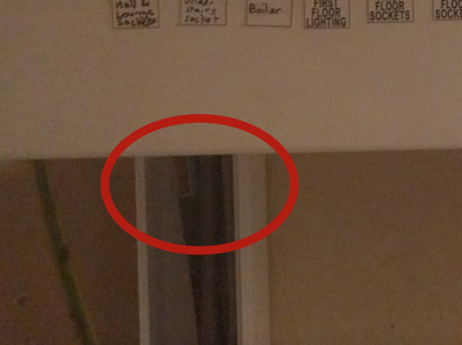

More importantly, what's going on here? There's a printed label for the boiler on the sticker kit
What's going on here?!
Oh sorry pulled that one off when I was adding a front outside socket, still haven't replaced. Agreed the IP rating is not up to scratch without the trunking front on correctly.
Edit oh your eye is ahead of mine, that one is ready for the outside socket but not connected yet. Easier to strip the sheath before inserting. It must have moved.
It was more that there appears to be a cable which has slipped down, as you can see the inner cores? Or am I seeing things (entirely possible!).
