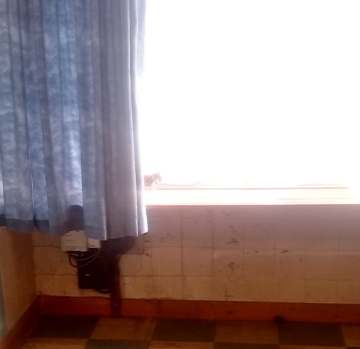

About to under take a total house refurb
This consumer unit for the property is under a bay window in the living room
Having never come across a consumer unit in this location, i want to know whether it would be a good idea to get this moved to perhaps a cupboard under the stairs?
If so, what is the justification?
I also plan on having an EICR and changing the consumer unit
What would be the best order to have these works done?
1. EICR
2. Move consumer unit
3. Get it changed in conjunction with 2?

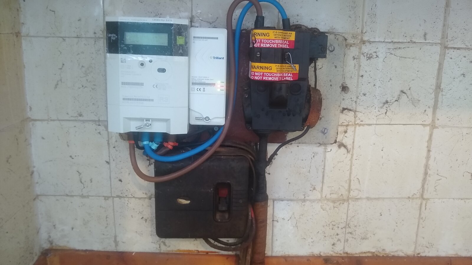

I'd say the first thing to do is to get a general idea of the age and condition of the installation. To determine whether you are in "replace CU" territory or "rewire" territory. There isn't any point paying for a full inspection and test of the wiring if it's clear from a quick visual inspection that the property needs a rewire.
I could be wrong, but I think that box at the bottom is a *really* old-school fuse box and is feeding old rubber cables. If so and if that is representative of the installation as a whole then it's rewire time.
Regarding moving the CU it's IMO pretty pointless to move the CU without also getting the suppliers equipment moved and getting the suppliers equipment moved is not going to be cheap. I suspect most people would just keep it where it is and build a cupboard round it.
If that item under the meter is the 'consumer unit' then there is no point in any EICR.
Call the DNO and arrange to have the meter and cutout moved outside into a cabinet.
While that's being arranged (weeks/months), the property can be rewired and the new consumer unit installed wherever you want it.
The more major part of the job will be moving the electricity board's mains and the meter. When you rewire (which looking at the age of what is there, you will be doing as a part of a major house renovation) the new consumer unit can go wherever you want it to (within reason). Get in touch with the power company sooner rather than later, though, to talk to them about moving the meter and the incoming power cable.
Over £2K was the indicative cost to move the supply
Me thinks that we will be building a cupboard around this :D
With a bay window directly above the supply, meter and consumer unit, will this pose any issues with the rewire?
Will this mean that there will be lots of unsightly trunking?
you could leave the meter and head there and put the consumer unit else where (they will be a lot bigger than that fusebox!)
Ideally within 3 meters of the meter.
You could put it on the other wall (and at head height). (I'm sure someone will give the regulation guidance for the height of CU's!)
