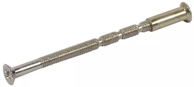

I never understood why sashlock handles were quick and easy to unscrew.
It would be straightforward to use security screws—even if they merely added a little time to breaking in.
The screws are on the inside only (y)
Lever handles for sashlocks are screwed from both sides
Ah getting mixed up with the euro cylinder.
But then once you have unscrewed the handles all you will see are 2 holes in the door so you are at no advantage as to breaking in. Unlike when you expose a cheap euro cylinder.

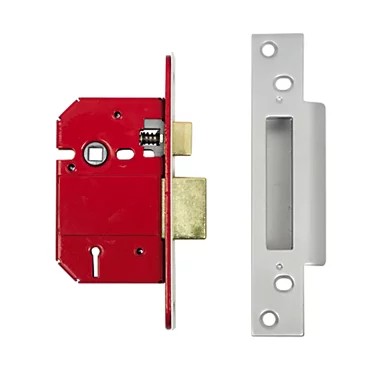

Yep but can you guarantee the through screws avoid the case of the sashlock? At least MPLs have cut outs or holes specifically for the handle screws
Yes, all the sashlocks I've seen recently have two cutouts for the purpose.
Example
The oval shape accommodates small differences in rose size.
