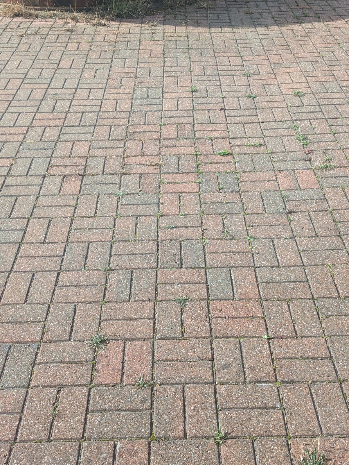

Hi all.
Lots of little dead weeds on our driveway that need removing.
Ordinarily I'd simply use a long-handled weed scraper, but the position of the bricks means I'd have to do a bazillion little scrapes to clean it all up.
Is there a solution that would remove the dead weeds over a wide area without multiple passes of a weed-scraper, that anyone could recommend? E.g. electric rotary weed brush?

Wolf weeding brush with pole, amazon cheapies for th3 replacements. Pour building sand over and brush in. It also cleans up the brick.

I've just cleaned a block paving area with exactly the same problem and used a Nilfisk pressure washer with their Turbo Nozzle which cuts right through the weeds. You will have to think about re-sanding to replace any that's been blown out of the joints.
PS: We also blew over them with some weedkiller a day or so before so that the roots were weakened/killed.
Go away and do something else. They will soon dry up and rot away.
