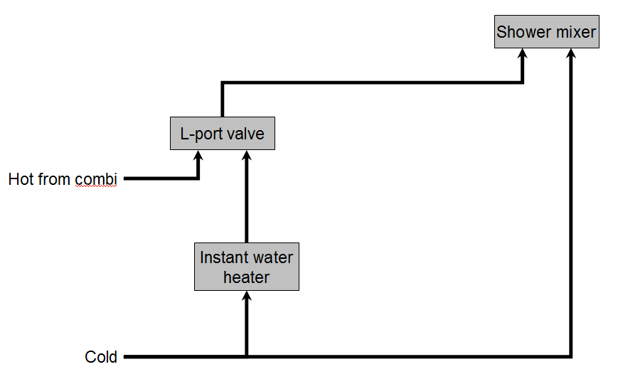

I'm thinking of doing the same, but replacing the electric shower with one of these:
https://www.electric-heatingcompany.co.uk/shop/bonus-instant-water-heater/
installed in a cupboard, and plumbed with the hot from the combi and the electric heater going through an L-port diverter, like this:
Then if ever the boiler has a problem I can still get a hot shower.
12kW - can't get a larger single-phase one. It's more powerful than the biggest shower you can get (only 10%, but more is more), but in the same price bracket (compared to a good electric shower with proper thermostatic control), and as it has no controls on it, it doesn't have to go on the wall in the shower.
Presumably fairly high to get a shower but I like the idea

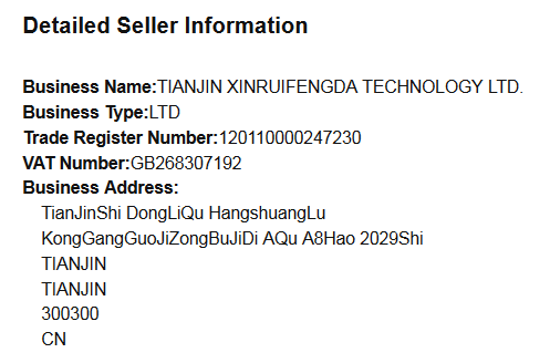

If you've not bought the cabinet yet, I strongly advise that you don't.
