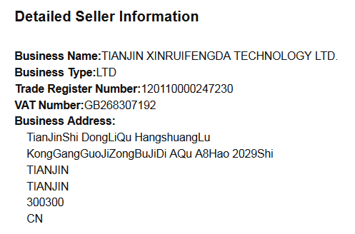

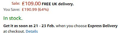

Yeah. FWIW according to the listing the item was dispatched from the UK so technically pre-imported. But anyway not worth the risk of the quality being shoddy. I know exactly what you mean with regard to the difference between where it's made and how it's made!
We've gone for one that's IP44 rated and suitable for use in zone 2 areas anyway, with the socket inside the cabinet.
Not what I understood this to mean:
I find it very hard to believe that this is going to be despatched from anywhere other than the UK (captured a few minutes ago) ...
