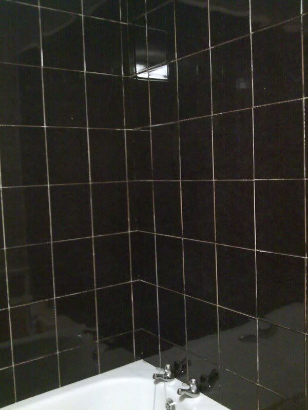

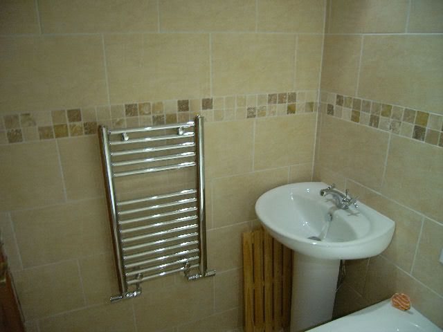

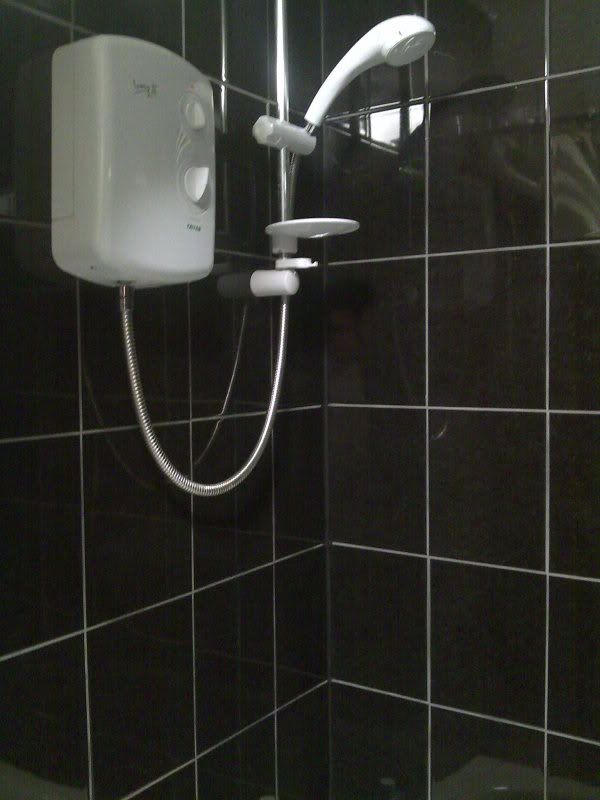

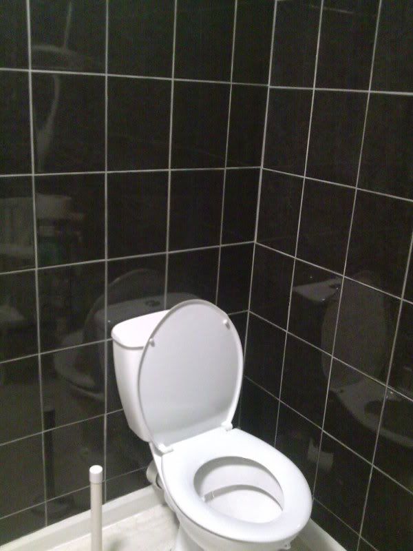

I used travertine
i have used travetine, limestone, granite etc mate with no problems at all
just a few examples
DROOOOOL!! <plip>

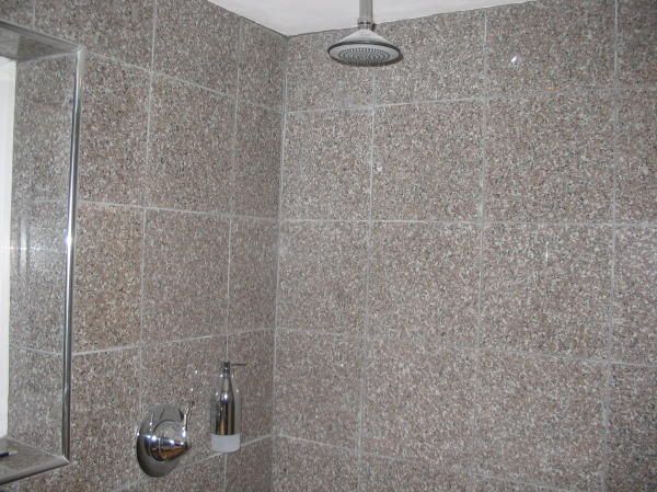

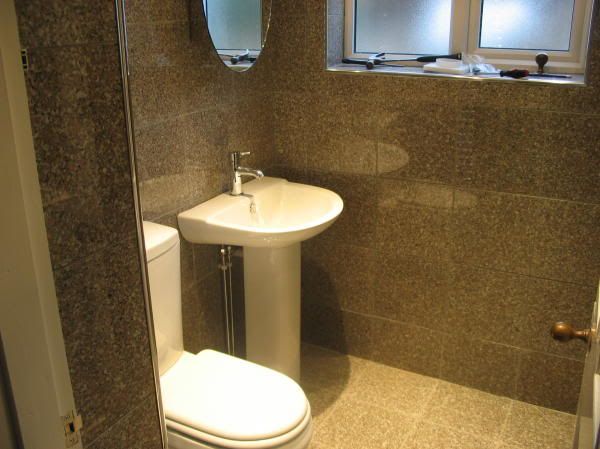

the granite bathroom i done ( walls and floors) 3rd and 4th pics from the bottom of my post were/are NOT slippy at all mate. There is also a sealer/impregnator you can buy that gives the tiles a non slip surface.Sorry i cant remember the name of it, but it was made by " Lithofin"
Much obliged to you mate. I think I know which lithofin it is, I think its is called MATT something or other.
That slippy thing really put me off before. :rolleyes:

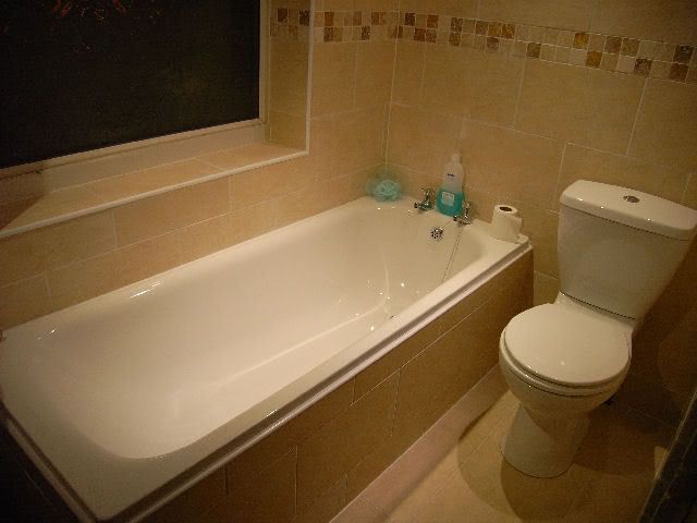

Hi,
Admiring your work there jctilingservices. Can I ask, on the bottom photo, what did you use to build the case around the bath? Also, is there any facility to remove the panel in case of leaks etc?

Hi,
hi Mate, the panel is just rebated 2x2, but the board is 19mm marine ply, the reason for marine ply is that i was getting it cheaply from a friend.
Yes there is a facility to remove the panel, its actually screwed to the frame through the tiles, but i made small inserts from offcuts, to plug the holes so the screws are not seen.
