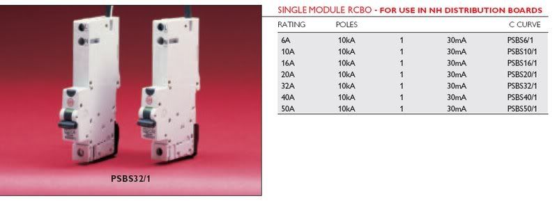

On that basis, I would like to add some RCD protection on the 4 power circuits (up, down, kitchen, cellar). These currently all seem to have 32A MCB's fitted-serial no. NSB32). Whats the best way of going about this-can I just fit Wylex 32A RCBO's as a straight swap for the MCB's, or is there a better way of doing it? Would it be better to put in-line RCD's on each circuit?

I think Wylex RCBOs are Type C so overload protection would need to be verified. Also, changing the protective device raises the Part P spectre.
Wylex do both type B & C. So if you were wanting to change say a 32A MCB to a 32A RCBO it would be NSBS32-B1. Whereas a 'C' curve would just be NSBS32.
Hope that clears it up for you. :)
Not according to their catalogue :?

Thanks, could I just get clarification on one more point? Are the Wylex RCBO's (part no. NSBS32/1) compatible with my Wylex NS consumer unit as well as the newer NH units? TLC's website says they fit both NH and NS, but when I asked them to confirm this, they said they couldn't tell me and referred me to Wylex...Wylex (rather vaguely) said they would not fit NS boards and I needed to use the 2 pole versions (NSBS32/2), however I can't do this as I want to convert 4 circuits and there isn't enough space on the CU.
Only to say ring Wylex again & double-check:
0161 998 5454 Ask for Wylex Technical.
