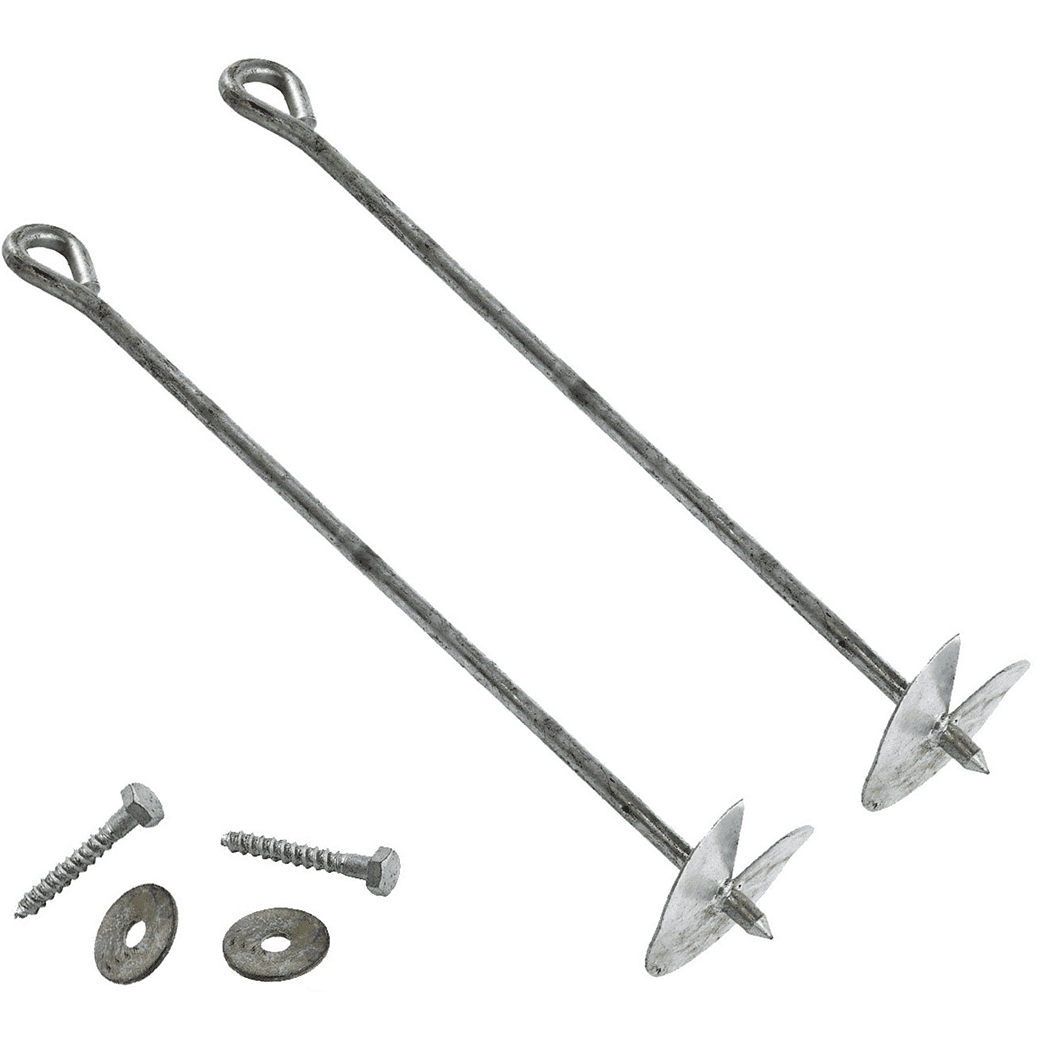

Haven't received any useful advice from Stratco - so trying to come up with a few silly solutions.
e.g. dig a hole into crushed granite base, fill with concrete, thread a metal U pin over the shed flooring and into the concrete hole
But perhaps there are some better ways?
Any advice would be very appreciated

How about "climbing frame anchors".
They are a Metal rod with steel disk on end.
Doing a Google search their price seems to vary a lot.
This is cheapest I could find
Also , knowing how sheds and climbing frames rot at their base I would not screw the anchor into the bottom most price of wood.
I would screw whatever anchor you get into say the corner upright wood a good 10cm above ground level.
