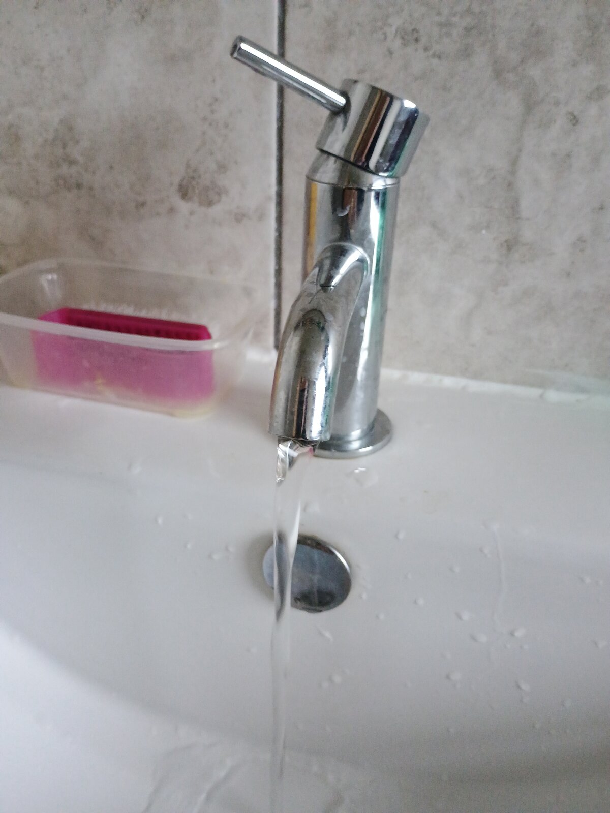

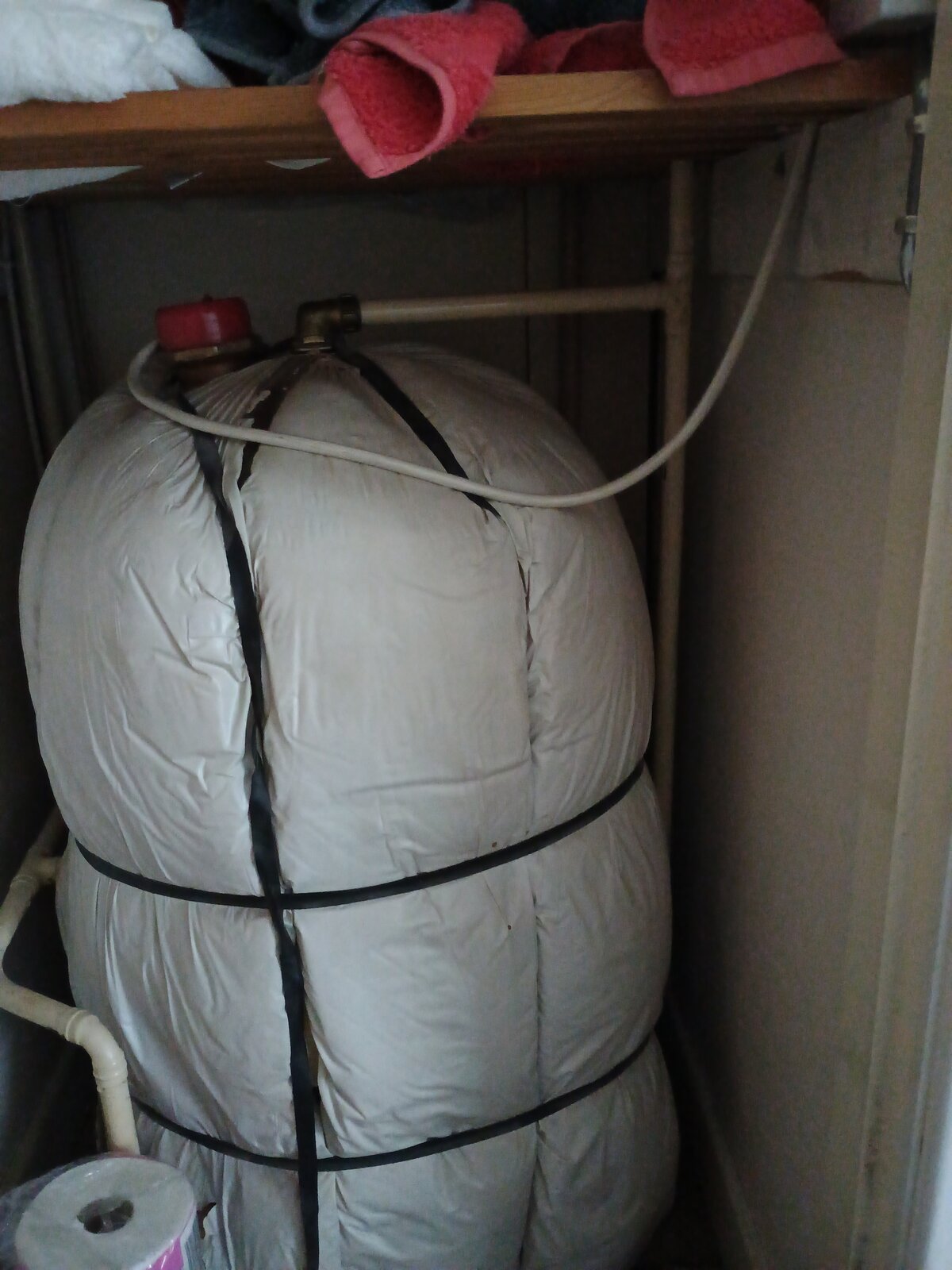

We have recently moved to a house with a conventional heating system and the tap at the bathroom sink is about a foot below the top of the hot water cylinder which is in the airing cupboard next to the bathroom.
The flow rate at the hot tap is a piddling 1.8L/min and I am considering installing a pump to increase this but I'm not sure which pump to choose or where the best place is to install it - under the sink or in the airing cupboard. Has anyone done this successfully?

Are other hot taps such as bath / shower valve etc flowing significantly better than that basin tap ?
If so ,check the supply pipes to basin tap for restrictive isolation valves ,braided flexible hoses that are constructed / twisted etc. that tap may not be suitable for low pressure systems
The flow from your tap is not dependent on its distance below the top of the HW cylinder. It is dependent on its distance below the water level in the CW storage tank that feeds your HW cylinder. If other taps are similar distances below the CW tank level and provide better flow then, as terryplumb suggests, there must be some sort of restriction in the supplying pipework.

Yes, of course, it's the HW feeder tank level that determines this, I was forgetting that. This is in the loft. Should that give a sufficient head for a decent flow rate at 1st floor level?

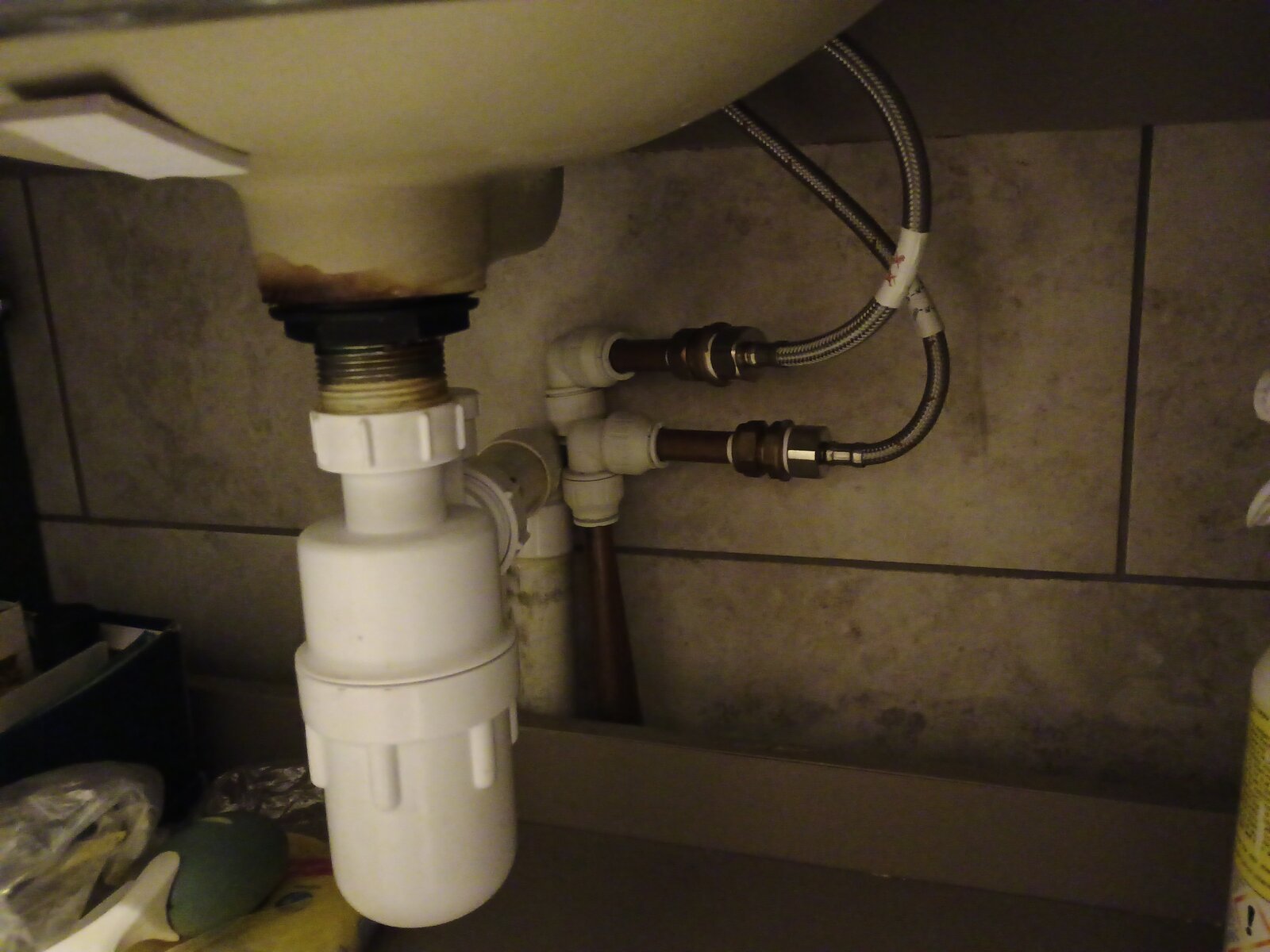

The taps are fed through 15mm copper but they do have 90° plastic bends near where they attach to the braided pipes. They don't have isolators. The CW seems OK with this at mains pressure but maybe not so good for the hot?

Getting those supply pipes direct to the tap will help flow.
The restriction is the small bore inner tube of the Flexi hoses. Fine for mains pressure and rubbish for gravity fed hot water where the tap is closed ,height wise,to the loft tanks base.

To be frank most monobloc taps with flexible hoses don't perform very well unless the water is under mains pressure.

As suggested - Gravity supplies are notoriously bad when run through mono bloc mixer taps with flexible hoses - both are extremely restrictive to flow and should really only be used with mains water supplies.
You won't be able to get rid on the flexi's for that tap as that's the only inlet hoses that will fit it. Most flexi's for that type of tap are M10's being 10mm at the connection to the body of the tap. Best type of tap for a single hole basin would be one with screw down compression valves, being the ones that would offer the least resistance to flow.
