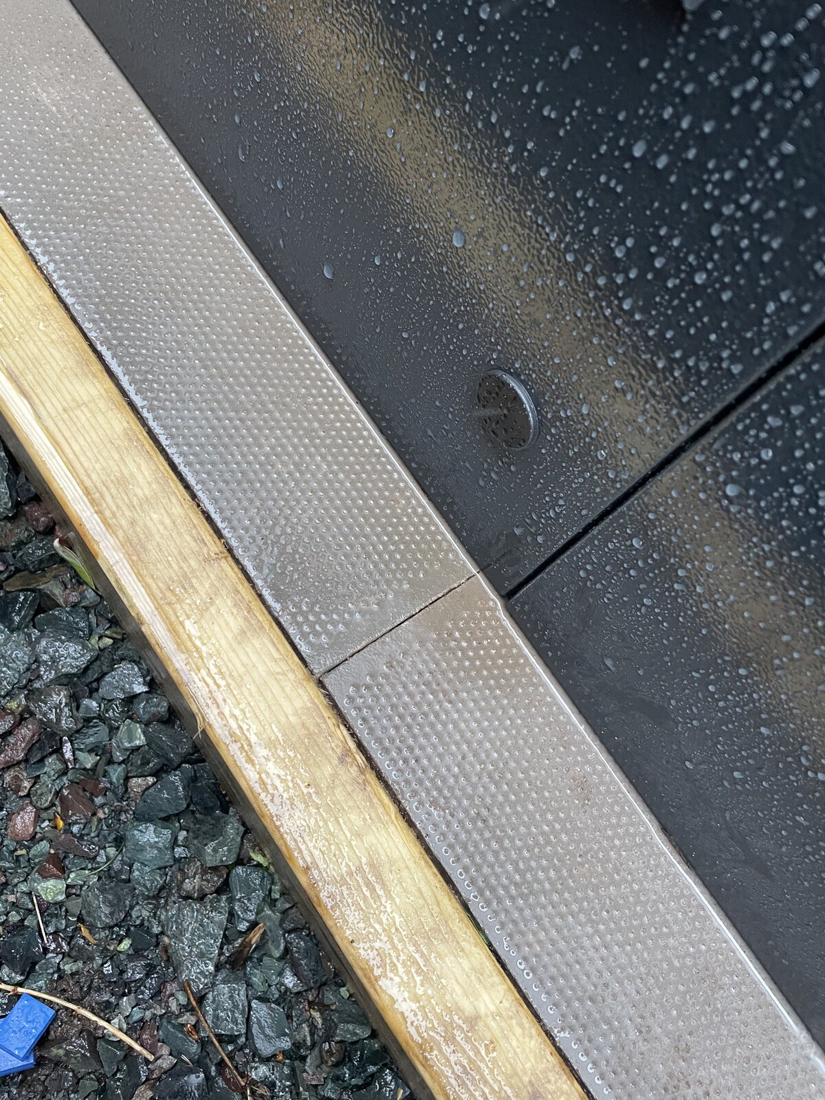

Hi guys.
The title may be a little misleading but essentially sums up what i need to do.
Please take a look at the picture attached. I need to drill or make a neat hole big enough to fit 20mm conduit in the slab below the rubber grommet, with the edge of the hole only a few mm away from the wall of my shed.
I have a 90 degree drill - the chuck makes the hole too far away from the wall unless i drill at an angle (trying to avoid).
I have a 90 degree chuck attachment - same issue as above.
I considered using a multi tool with a tile bit, but unsure if that will do it, and if so, if it will leave it neat.
How would you guys do it?
Is there a special tool in existence?

drill at an angle till though then nibble below the surface with a rasp or file/chisel/buzzy toy narrow blade sandpaper to finish
keep in mind clips or other fixings may space off the wall
buy yourself a 600mm long drill bit, then it would be pretty close to 90 deg

Yes i want to drill down through the slab. I will start off with a small diameter drill without hammer action and gradually work my way up to 20mm. Its been done before. If it breaks because it is so close to the edge i will simply re-concrete.
Drilling downward means i can run conduit down from the junction box straight into the ground.

If you say your willing to re concrete any damage then I'd stitch drill across the concrete take a small section out, get the conduit in place and finished as you want then concrete it all in place nans make good the surface

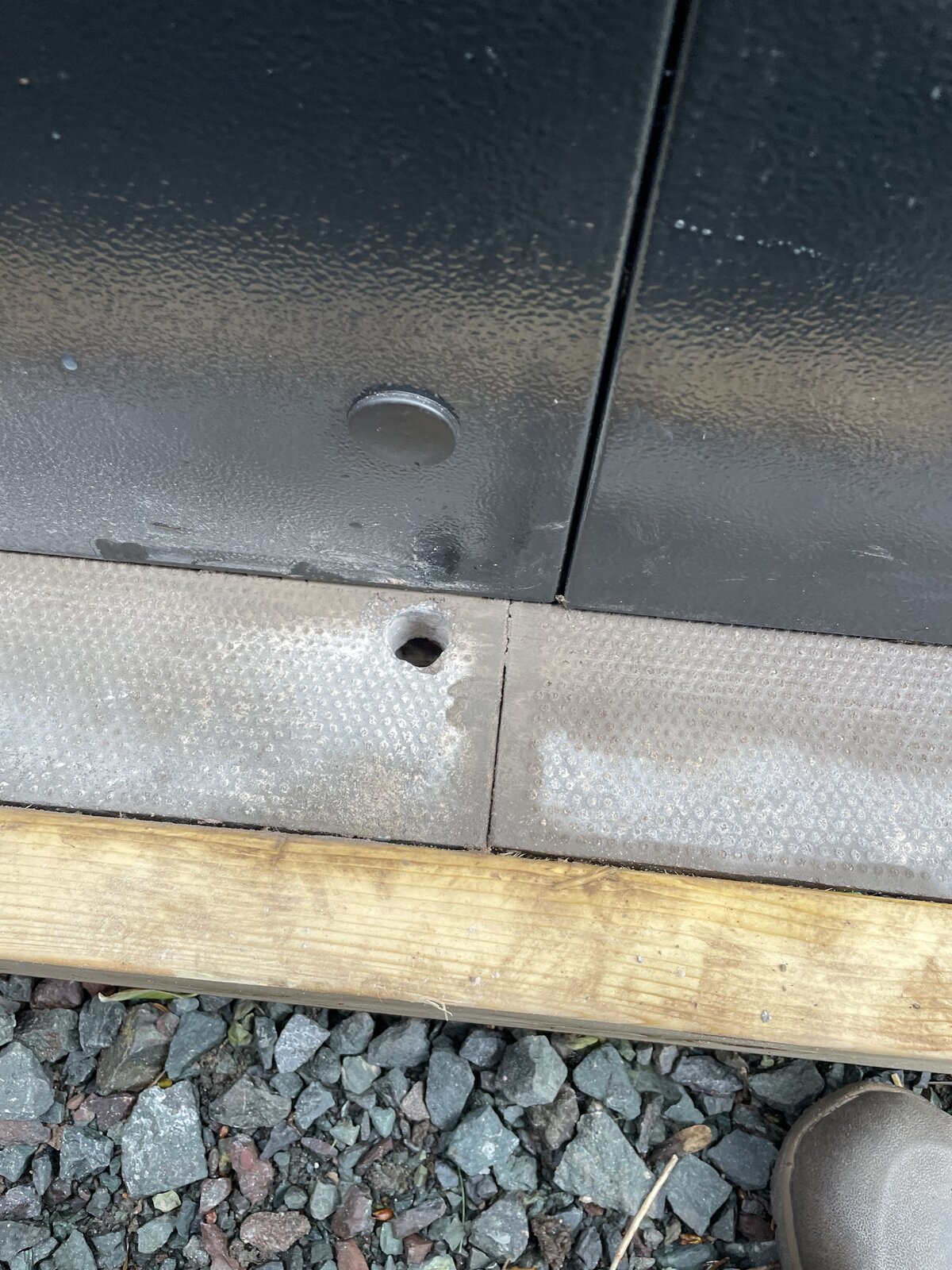

I did it using the long drill bit method. I found i had 4x 400mm sds bits in my drawer.
I did the initial hole 8mm the stepped it up to 16mm, 20mm and finished off at 22mm.
This was a lot harder to drill through without hammer action than i have experienced in the past. I did it with hammer action, on a slow drill speed with very light pressure to avoid it breaking.
If the angle isnt vertical enough or its too close to the shed ill file it out.
