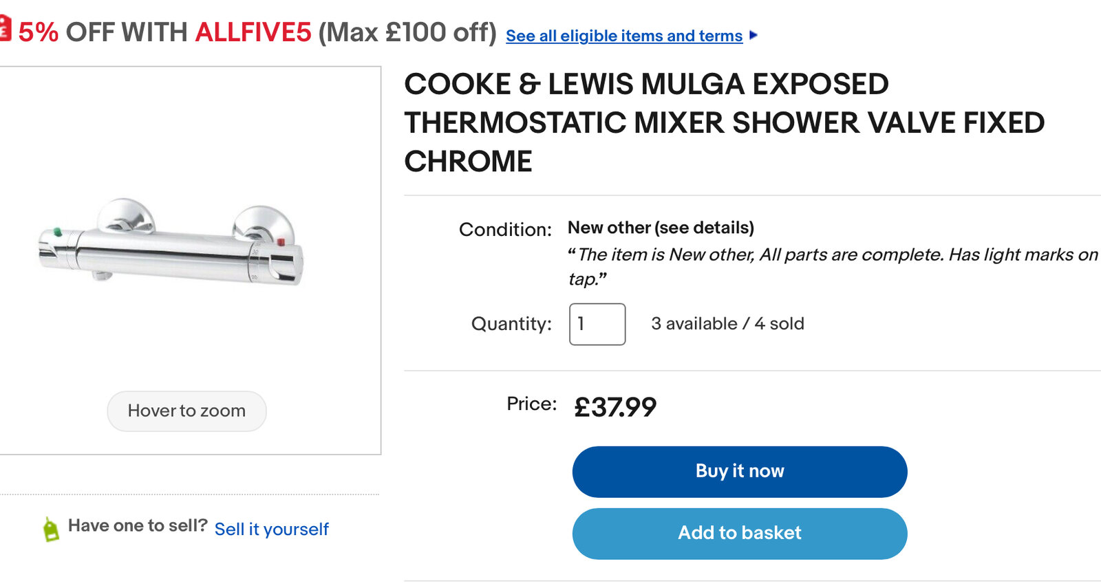

I'd like to fit an external tap for car washing.
Occasionally, I'd like to mix in a bit of hot to make the water warm. Obviously, I need to run H&C pipes to where the tap will be sited.
But what is the best mixer to use?
Thanks.
Thanks.
Is there nothing like the item I posted, but with easily adjustable temperature, so you can have warm or cold?
If it’s to be adjustable, the adjustments will need to be outside. Something line this, feeding a normal outside tap?
I have a panelled timber frame either side of my up-and-over door, so the mixer device will go on the inside, with just a bog standard tap on the outside.
You wouldn't usually use a TMV for a location that could be at risk of freezing, in fact any type of Thermostatic valve as in a shower, they will break if they freeze.
Thanks.
I use one just like the above, as a mixer to my downstairs toilet, washbasin's single tap. In summer, I clip an hosepipe on it, to bath the dog outside. It works well, mixing our mains CW at 2bar, with hot from our open vented cylinder. 60C water, comes out of the basin tap at around 40C.
