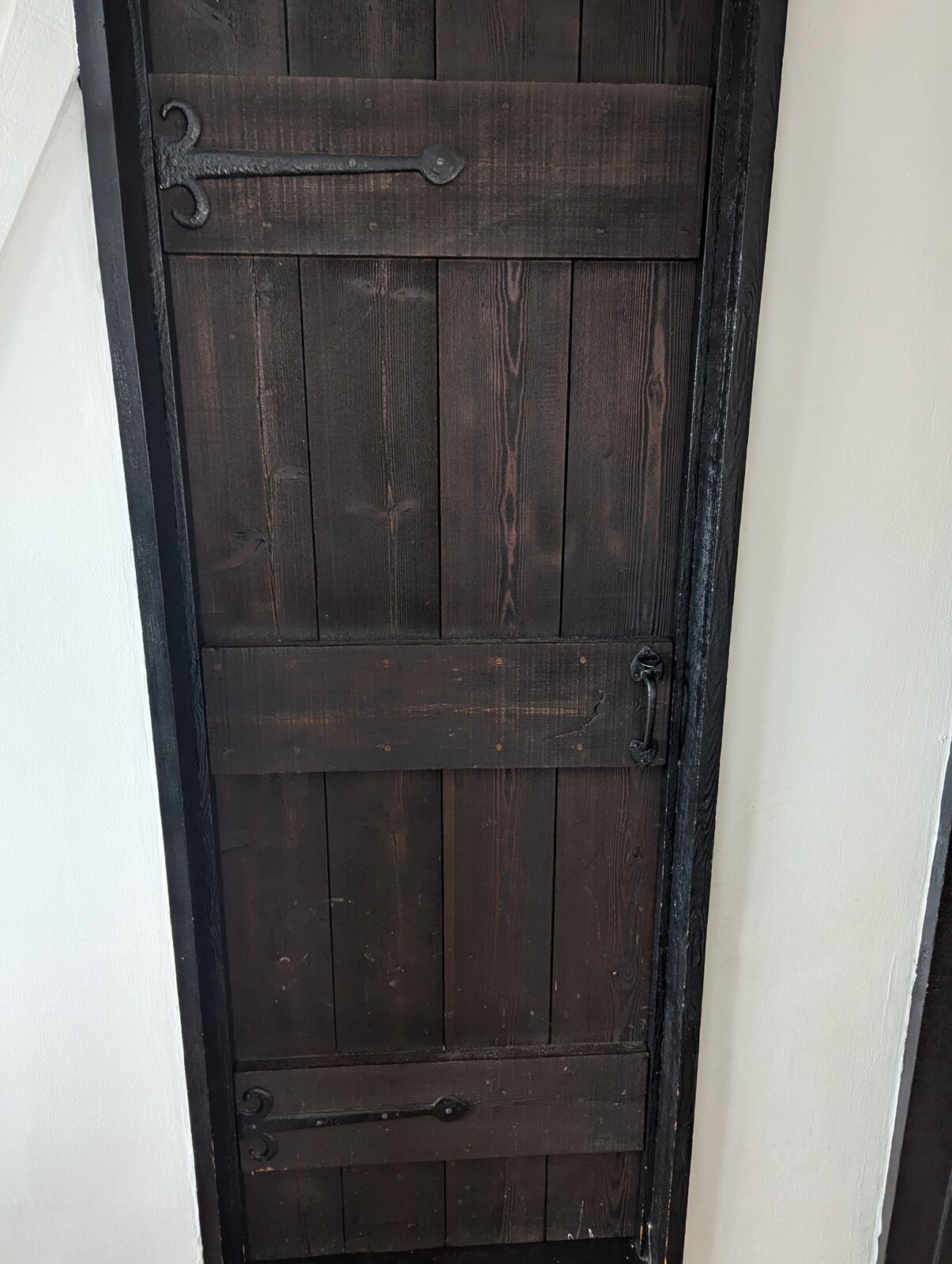

I have these dark wood doors in my house which I would like to paint white and keep the metal bits on the door black.
My question is what paint do you think would be best to do this? I know it will take a few coats and was thinking of putting Zinsser 123 on and a satin white on top of this but wasn't sure if this would be best or if anyone else has tried to paint doors like this before and had any recommendations.

Assume all inside? Zinsser BIN 2 coats. Then an acrylic primer undercoat. Then your top coats...
The 123 you mentioned is not a good stain blocker. You could try it but I'm sure it will fail on those doors.
Yes all interior doors. So to confirm it will need Zinsser BIN, plus undercoat, then top coat?
I would use bin , 2 coats
Then a oil based undercoat which in my view would give better coverage than an acrylic primer undercoat
That being said you would need 2 or possibly 3 coats of even oil based undercoat to cover dark wood doors
Then your top coats ......again x 2 , minimum
Also it's quite rough wood would you still thoroughly sand down prior to Zinsser BIN?
Yes, the more sanding the flatter the end result. I would start around 60 grit work through to at least 180 if 240 grit.
You could try putting on a sacrificial first coat of bin , let that harden off and bind the surface.....then sand off lightly
Then proceed with bin x 2 etc etc
You will probably get a better finish that way
