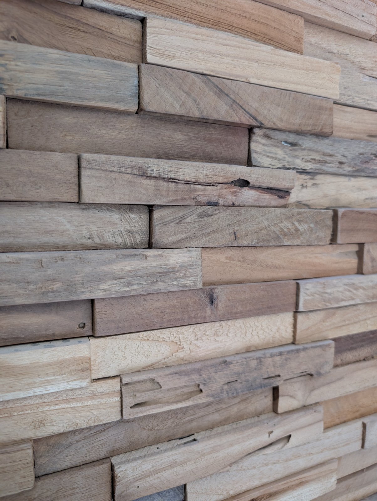

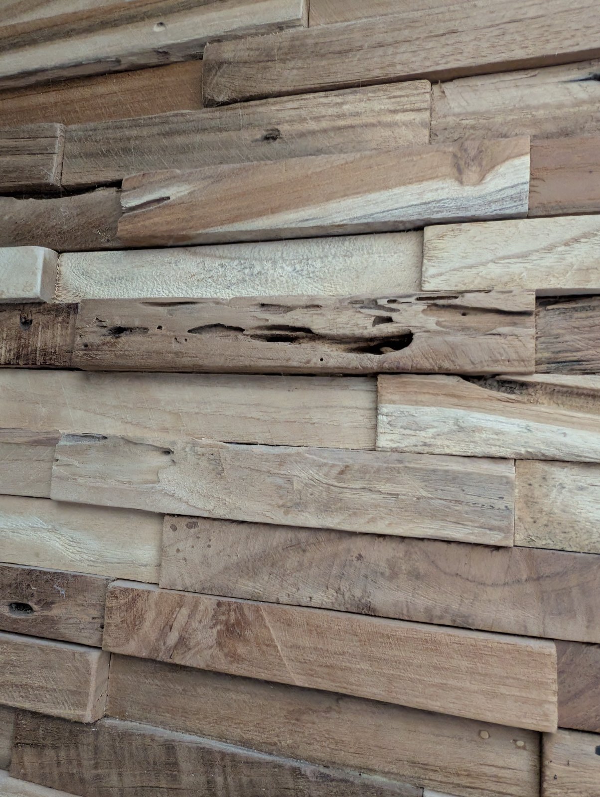

Hi,
I have some nice wood tiles left over from a bedroom project that I would like to fit on a small wall behind a wash hand basin in a downstairs toilet.
I am a bit worried that if I don't waterproof/seal them they are going to get damaged from the splashes from the basin.
What would be the best way to seal/waterproof them?
To protect them? I would prefer to avoid changing the colour or the finish as much as possible. I believe the tiles are constructed from offcuts of different types of wood so I am not sure how pourus it might be.
Thank you
If it were me, I would ring some decent trade product manufactures like Sika or Permagaurd. They all have technical helplines with people in their technical departments happy to speak to customers.
Thanks for the tips so far, I have just discovered that these tiles are made from Teak, so I am not sure if that makes find the suitable product easier?
Osmo oil is ideal , do not use Danish oil it’s not up to the job.
Teak is naturally water-resistant, so you don't need to add anything, at all. I fitted teak, around our bath 40 years ago, one piece, forming a level fill-in shelf, between bath rim and wall, with no protection, regularly getting wet, and it's fine. They use teak for boat/ship decks, because it's so robust.
