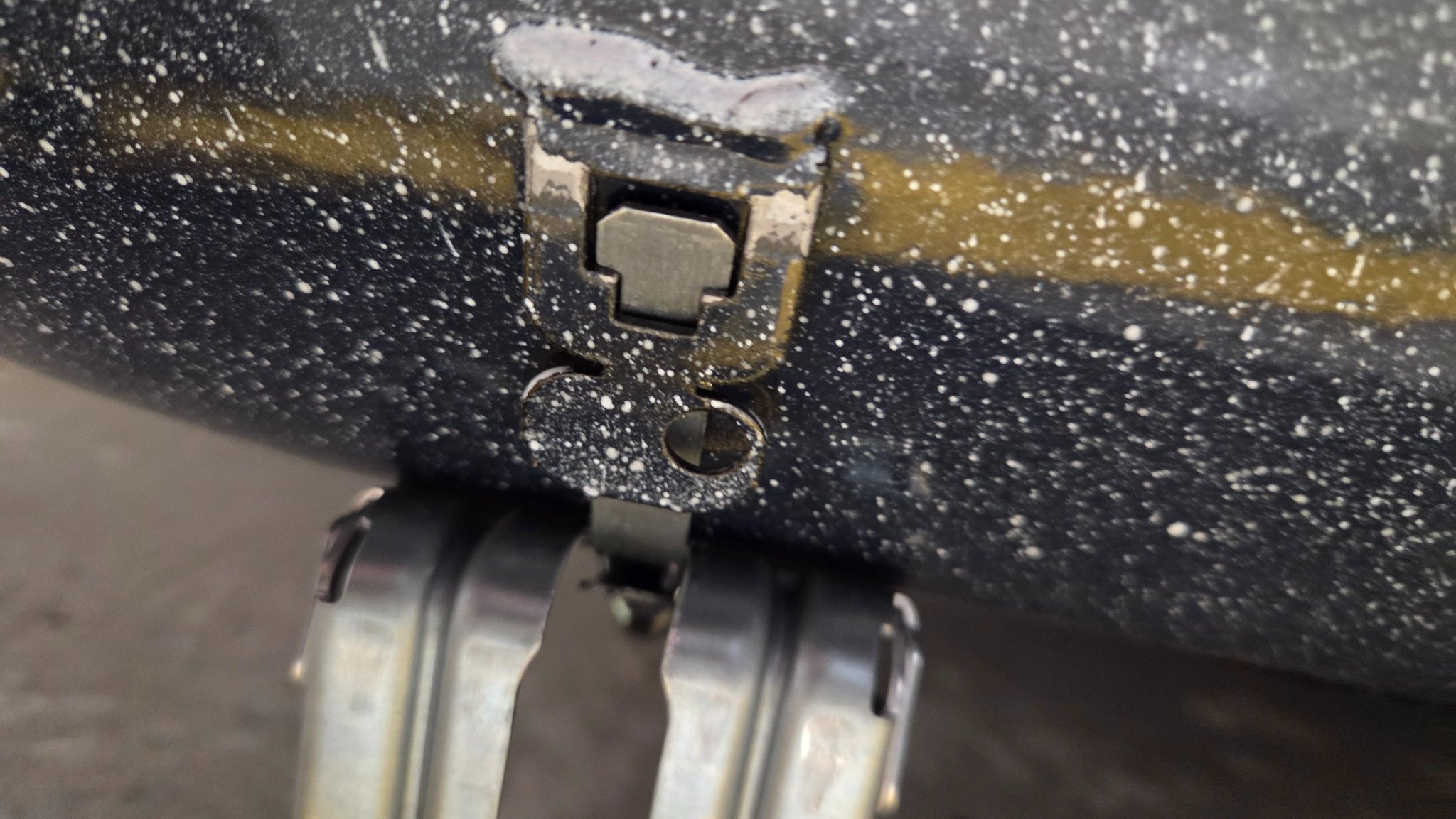

Just put the bath feet onto a bette select.
First leg set went on, tightened up, the nut came off....then went to so second leg and noticed i should have the metal belt within the notches on the side of the bath so it tightened against it.
Dipsht didnt on the first set! I was confident with the fact the belt was tightening up which is probably why.
Typical but its the corner if the bafh where i will be getting in/out.
For the sake of 70 quid for new legs is it worth the worry or Is this acceptable with also a wood frame in and likely to never cause issues down the road with it coming out/loose?

I think I would be bending that down a bit so it catches on the notch more securely, what does the MI say?
I will try that in the morning but its clearly not tightened i think.
Its annoying as the legs wouldnt budge when i wobbled them around.
Manufacture videos show it notched in so i think the writings on the wall and i need to buy legs again.
Answered my own question already, legs are not secured enough and they've moved out of position due to not being tight enough.
German engineering works but it aint for idiots and you should always read there fking manuals to the death lol.
50 quid of mistake but you live and learn don't you.
Just put the new leg replacement on. The old legs came off spinning the bath around lol.
