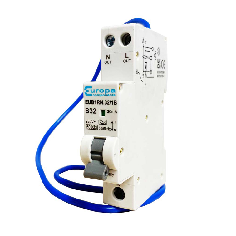

I have looked at the pictures, and I fail to see how one can know if the RCD or RCBO is Bi-directional, the ones @flameport shows still show out on them, so if doing an EICR how does one know if correct one is fitted?
It seems most rely on the output switching off to stop current flow through the test button, if tripping does not remove power from output then current can still flow.
