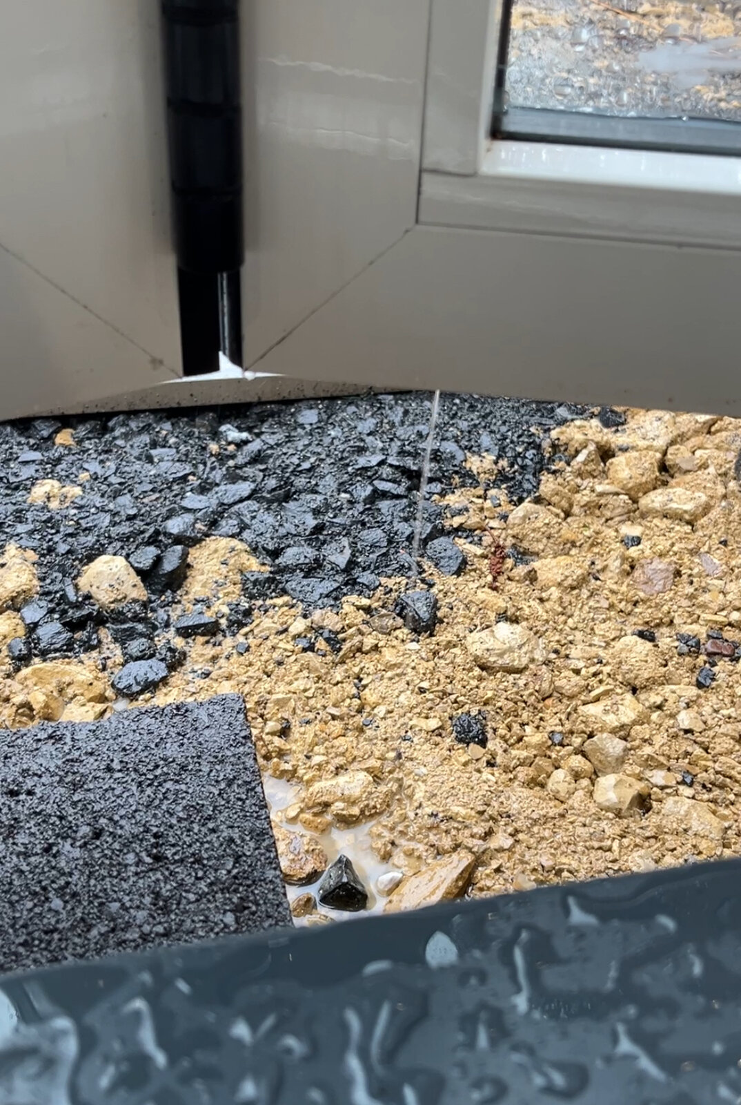

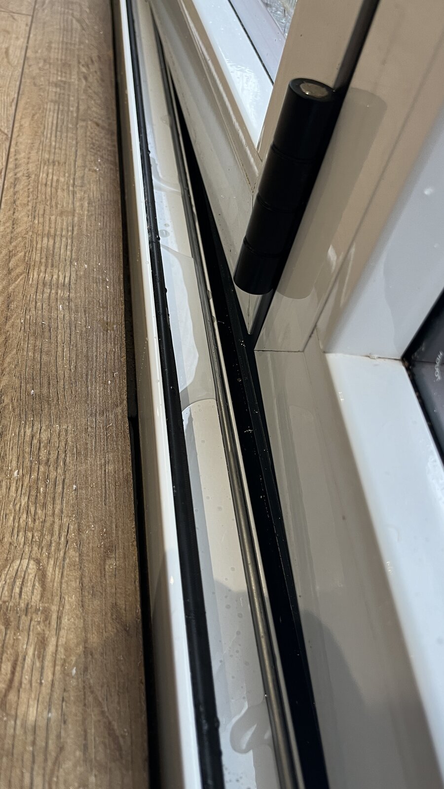

Hi ,
Fairly new fitted bi fold doors
Issue I have is finding water inside the inner Chanel as shown in photos , I’m pretty sure this should happen . When I open doors water drips out as you can see from 2nd photo and this I’m guessing is how water is getting into that Chanel .
Please help me and confirm if there is something to be fixed here ?
Thank you

Get the fritters back in.
I have contacted the fitter, he said he will drill some drainage holes in the white channel, is this normal ? I worry he's not addressing the issue of how water is getting there in first place? Thanks.
It's probably draining out of the doors when closed hence why it's sitting in the threshold but the threshold should already have drainage holes to deal with this
HI, thanks for reply, didn't notice you had. I am still getting this issue despite replacing the seal, thinking water was getting in. I understand these doors can take in water and leave at bottom, as my tracking has weep holes in the outer track, but not the inside track. Surly its not normal for water to enter the inside track if there are no weep holes?
