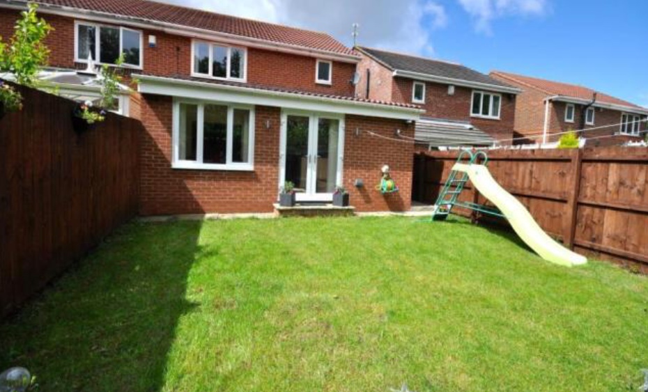

Hi
Just bought a house with an extension on back, 4m depth with sloping roof and velux windows. Currently has a set of french doors and a window, would like to replace with bi fold doors.
Opening would be 3.8m. Current construction has inner skin built from blocks with 150mm concrete lintels over doors and windows. Roof joists sit on wall plate on top of this lintels. Outer skin brick taking no load from joists. Facia board bottom sits right up to door and window frames.
Anybody on here now if it would be possible to replace this lintels with one to cover the new opening? Steel obviously, but would like same dimensions so roof line doesn’t need to be lifted

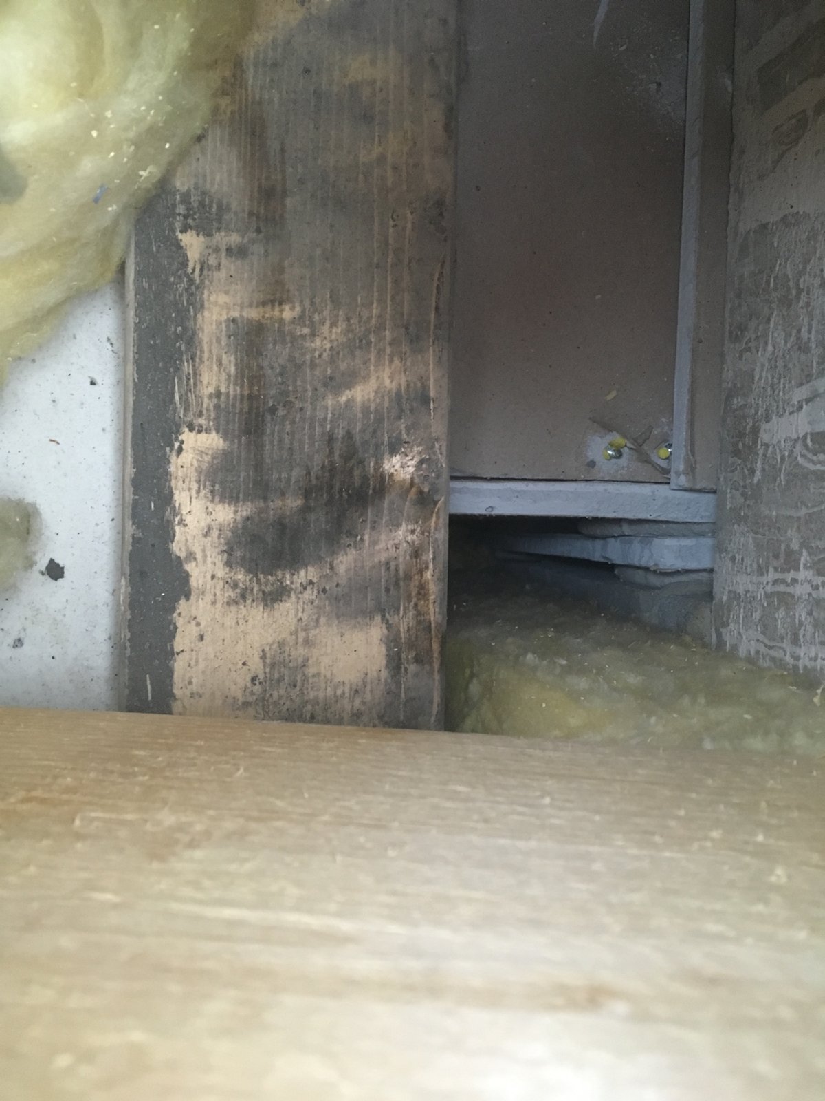

I doubt you will have room for a catnic type lintel as I'm certain it will be a 3 course fella.
You may just squeeze an engineered steel e.g. 178mm x 102mm x ? kg's into the available gap. S.E. input will be inevitable with that sized opening.
Just wanted some reassurance it was feasible, as if the roof needs raising it won’t be viable.
Next issue would be how do you get it in!
