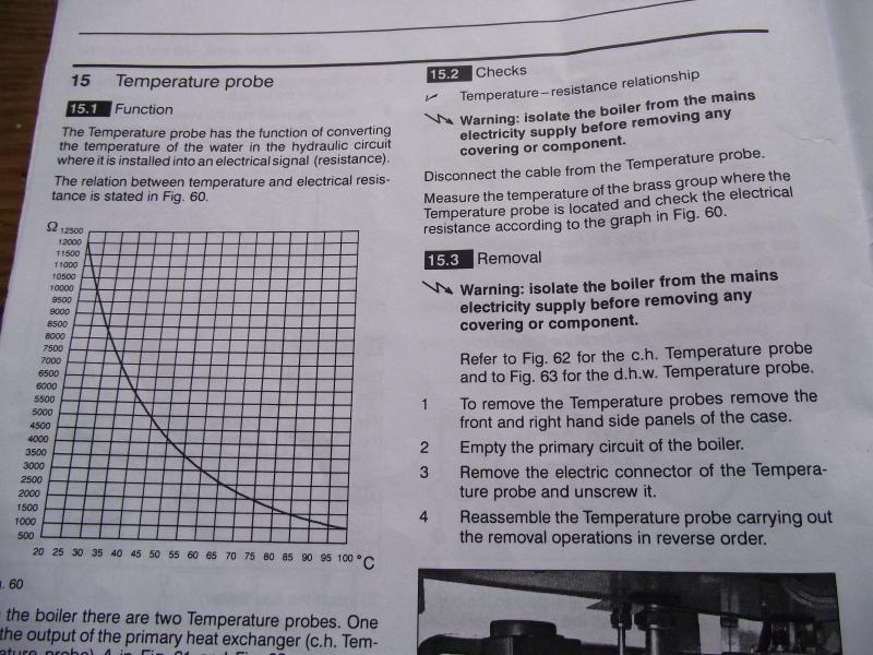

Checked DV temp probe - removed connector and burner carried on past 80 degrees - replaced connector burner switched off at 75

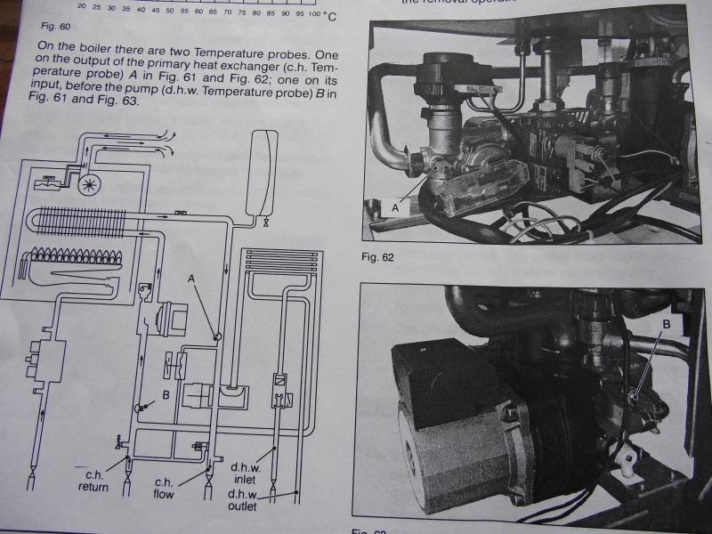

Which is main temp probe - one attached to diverter valve or the one clipped the flow pipe in sealed compartment?

Also removed TP connector forces burner to stay on longer and reconnected TP turns of burner at just below MAX - wouldnt this suggest TP OK?
Can DHW & CH temp probes swapped around to test?

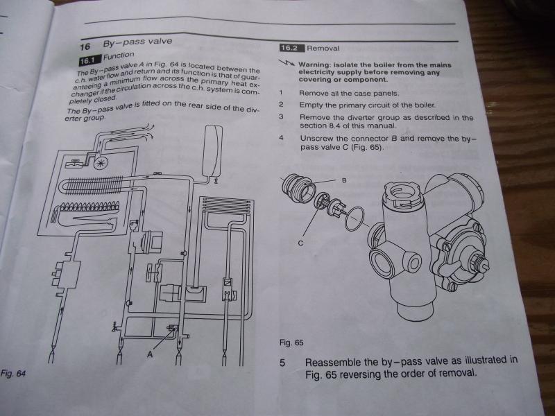

Can I clean / service the BPV?
I have checked the manual and will swap the Temp Probes as they are identical.

I could not take the pipe off to remove BPV i.e I took the spring clips of and expected the pipe to pull off but it wont budge. I cant get much leverage on it due to it being so close to the wall and I dare not use any tools as crowbar it off.
According to the manual, its simple - remove the clip and pull the pipe off

You suggested blocked By-pass valve - does that not come in play if the circulation is completely blocked - But I have 5 out of 8 rads warming up so there must be some circulation - However it does lock out after several hours of heating and cooling in quick succession
The By-pass pipe is that a push-fit secured with wire clip or is there anything more securing it?
