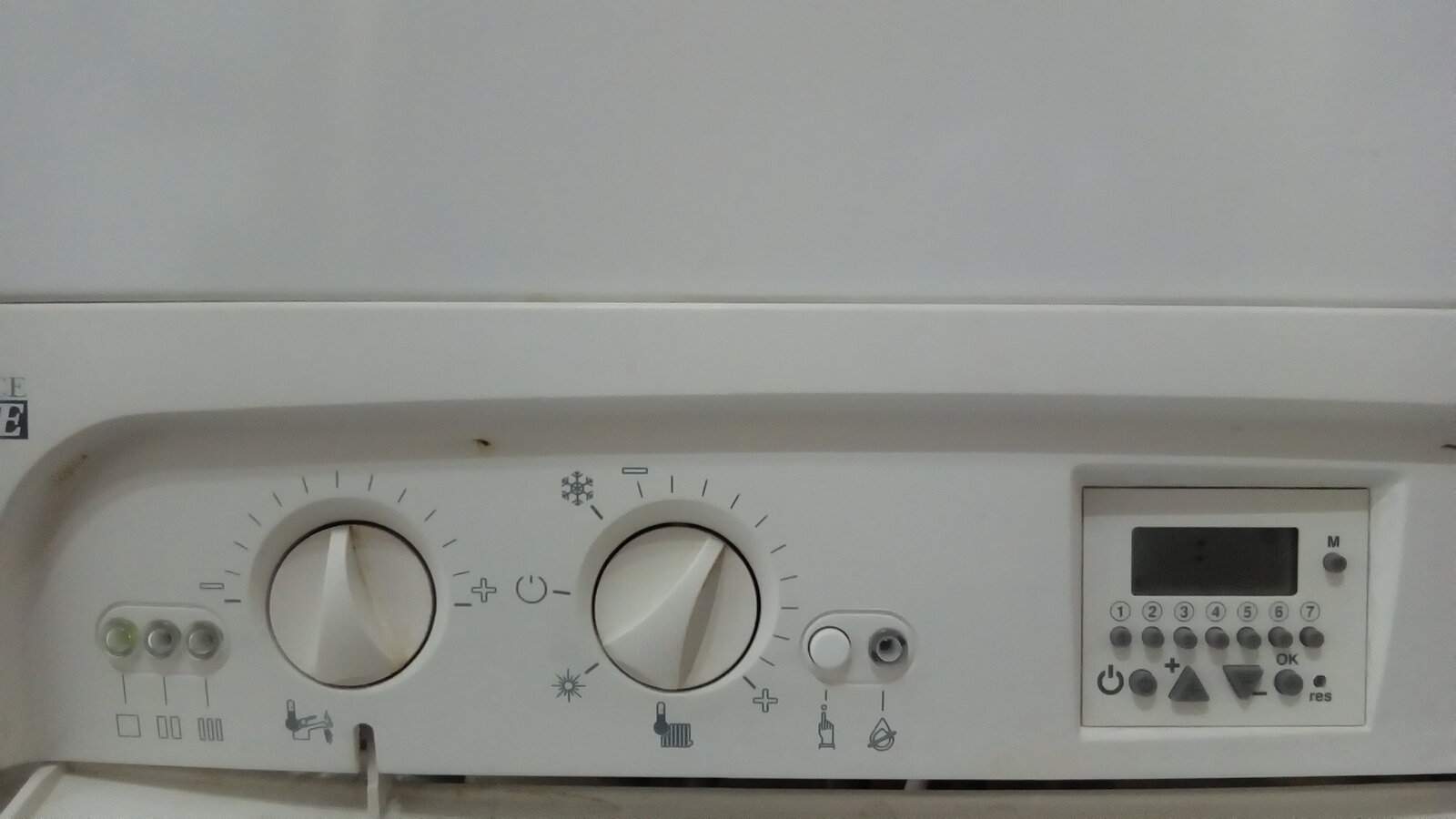

The DHW NTC has just been replaced. Drained down, fuse removed before starting the job. Refilled, fuse replaced.
So now just the left light of the (3) status indication lights is flashing slowly, which says the boiler is ok.
I have hot water again.
But now no CH, and there is this big LO message on the timer etc display, nothing else, just LO?
Any ideas?
Thank you.
(I pressed reset and the LO message has gone but still no heating)
You probably need to set the timer. Do you have the instructions ? Did you press the timers reset button and hold it pressed for 3 seconds ?
