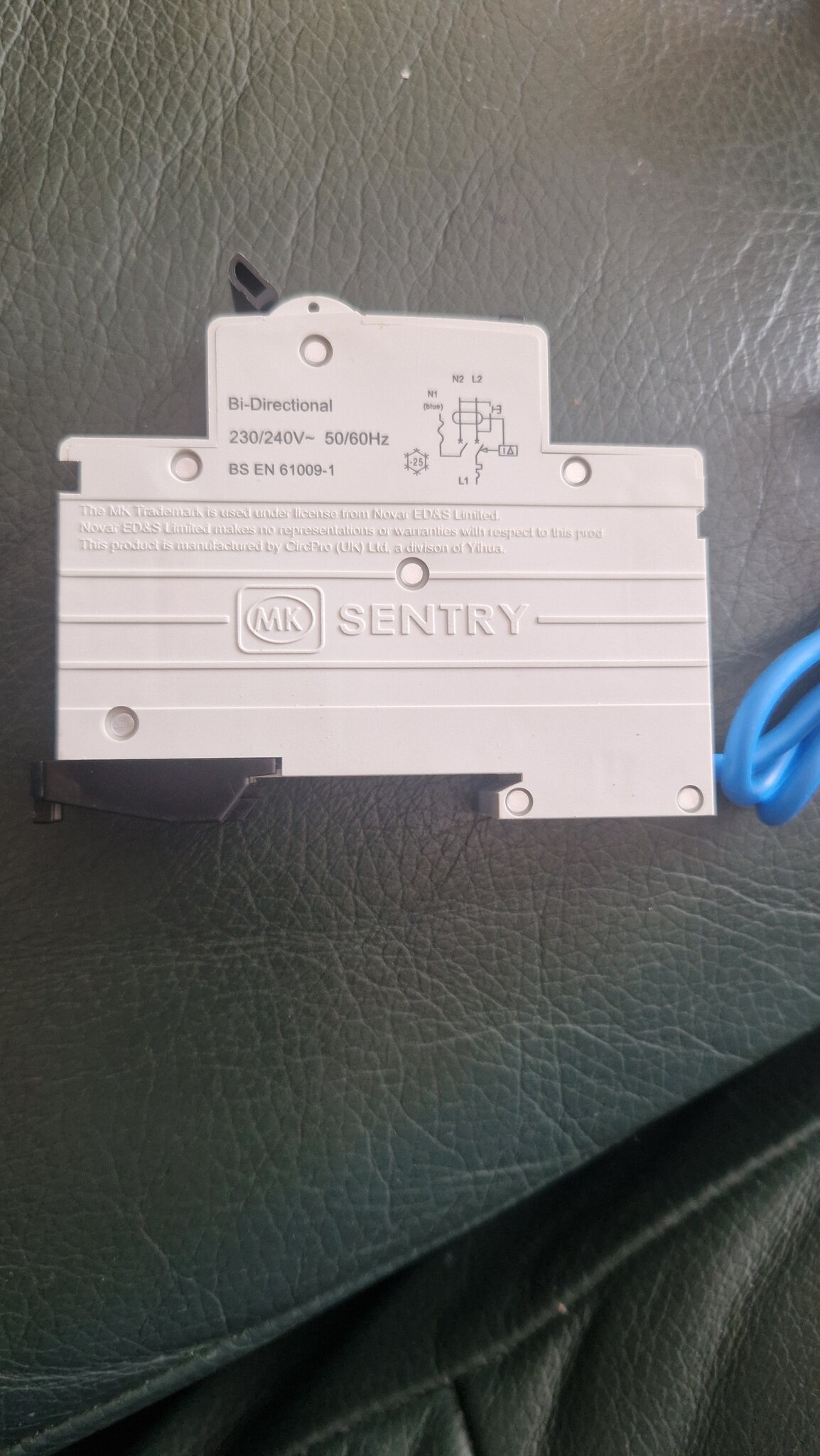

With the first raised problem with uni-directional we were told if it did not state load, input, or other on the RCD we could consider it as being bidirectional, so what is L? Is that load, line, or live? 1779027568645.pngSince in the main bus bars connect to the bottom I would assume it means line? I have seen boards with the RCDs either end, so the line would be on the other side, but since no earth connection, why would it matter which side is neutral, and which is line?
In the absence of any indications of 'in' and 'out' one would presumably have little choice but to treat it as 'reversible' ('bidirectional'), wouldn't one?
