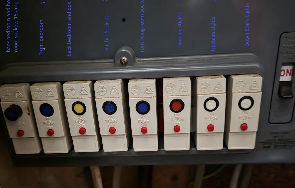

On another forum someone wanted to fit balcony solar with an old Wylex fuse board with MCBs fitted, it was pointed out to have 230 volts outdoors it needs RCD protection, but I simply could not find a single FCU or socket with an RCD which says bidirectional.

If the someone has money with which to buy 'balcony solar'' kit, it sounds that there are probably much more appropriate ways he could use the money to 'upgrade' his/her electrical installation :-)

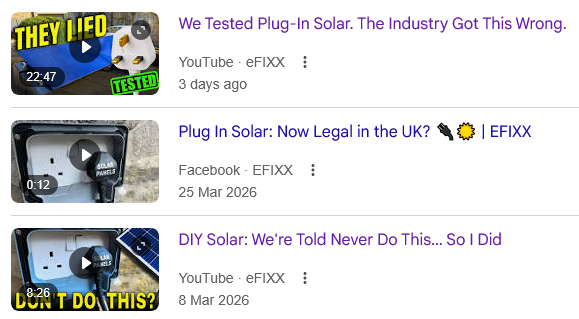

The efixx guy has also fitted 3 inverters with his plug in system, not just the one, they have done at least 3 videos now 1780705344687.pngand they seem to be saying there is really no problem, which I find surprising, as it was also them who did the test with the unidirectional RCBO and showed how fast it failed.
I have no intension of testing a good RCBO on solar panels by pressing the test button when the panel is producing solar, and I can see the problem if they had done that test in his rented home, but the way they did not even say do not test with the test button when the solar is producing, but is you want to test use a plug in tester is a bit sneaky, we have realised it is the built-in test button which is the problem at least they could point this out.

The efixx guy has also fitted 3 inverters with his plug in system, not just the one, they have done at least 3 videos now .... and they seem to be saying there is really no problem, which I find surprising ...
As I've just repeated, I do think that this discussion is very premature, but it certainly is possible that any perceived theoretical 'dangers' may actually be so small as to be of minimal cause for concern, despite ....
.... , as it was also them who did the test with the unidirectional RCBO and showed how fast it failed.
Both you and I were very surprised by how quickly their bang and smoke appeared, so I'm a little sceptical. If we assume that RCCBs born many years ago were probably 'unidirectional',then countless of those have been in service for very long periods without us having heard of any problems. In fact, looking around here, my three up-front Type S RCCBs have(for convenience) been installed 'upside down'(supply at bottom) from how they would usually be installed in a CU but, despite the fact that their test buttons have all been pressed regularly for many years, I've yet to experience any bangs or smoke :-) ...

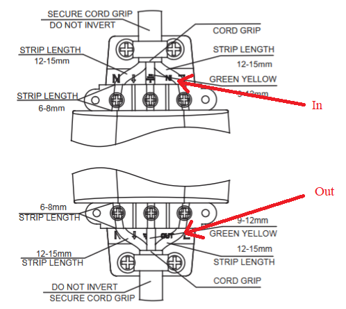

So I have looked at the instructions 1780741936319.pngand if you look carefully it is marked in and out so unidirectional so as it stands the adaptable box with an RCD in the box seems the only option. Or of course no RCD protection.
