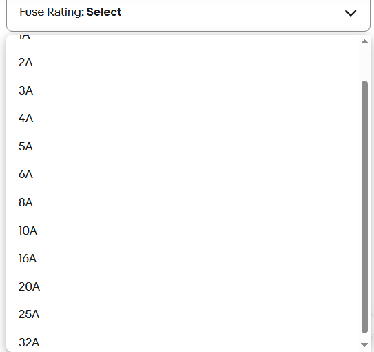

As I keep saying, I think we are wasting our time with this very premature and speculative discussion. In the meantime, there will undoubtedly be people who find ways of doing things which are not actually 'allowed' by laws and/or regulations, but that is true much more widely than in the context we're currently talking about. Let's face it, it takes only the click of a mouse button to buy (in the UK) things like ...
