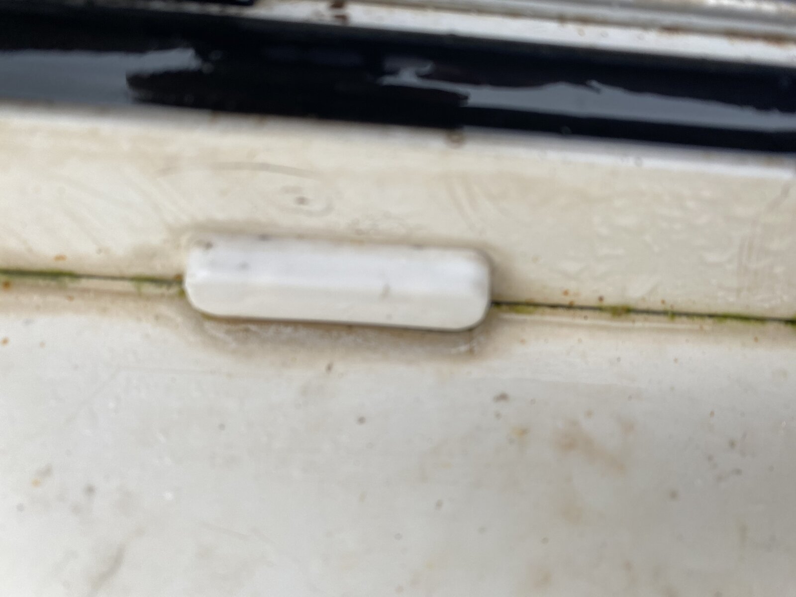

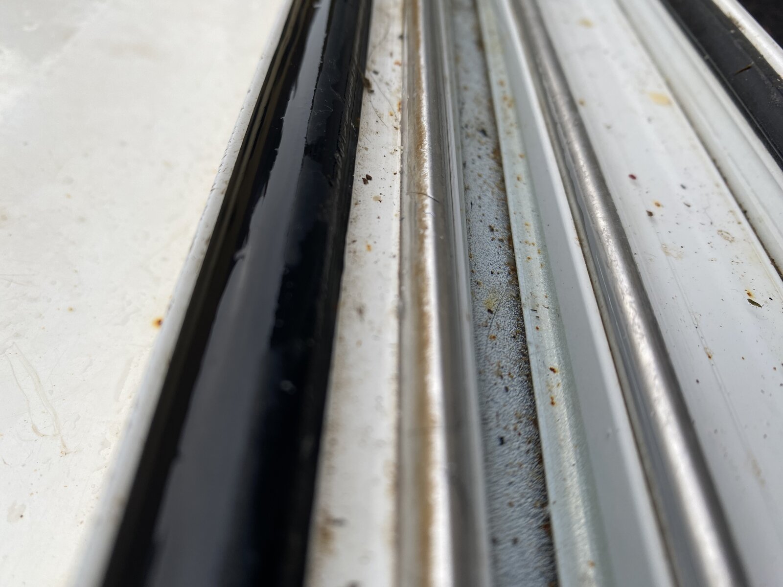

Hi,
The track on my bifold doors is holding water causing the rollers to rust. This started after the seal was replaced by the installers. The old seal was fouling on the bottom of the door making it difficult to open and close them (there is no up/down adjustment on the rollers). The installer’s solution was to fit a new shallower seal but it seems to let the water in. I cannot see any drain holes in the track but I think water should drain away through channels that run either side of the length of the track and exit through drain holes in the bottom of the frame. I think the company that fitted them no longer exists. Can anyone think of a fix? TIA
