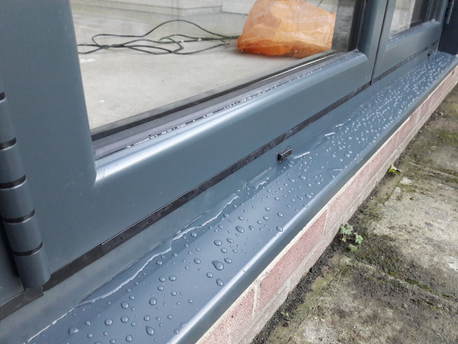

Hi
Had some bifolds fitted and after it rains we're finding that the water isn't draining off the Cill. So now I'm in dispute with the compnay that fitted and holding back 30%, since they asked for 30% up front. The solution they've come up with sounds like a bodge so now we're at a stale mate.
Any options seeing the attached photos ? I'd say the Cill isn't fitted correctly and they hwole thing needs redoing, but obviously they aren't keen saying it is and the water won't get inside !
I hate getting fobbed off like I'm stupid, but why do they do it again and again, maybe I do !!
Thanks In Advance

Although the water isn't draining off the cill, is any getting inside, and what is the solution they are suggesting. I don't think there's enough of an overhang to let the water drip off properly, but I can't see anything else amiss, but as the water is sitting slightly to the back, it's difficult to tell if this is flat, and therefore just a natural place for water to collects, or if it hasn't been set flat.

Looks like Smart's aluminum, I fit those myself. As long as they work correctly and no water is getting inside its all good.
Personally I would have gone with the DV176 combined threshold/cill but thats probably just my personal preference.
It's not set in correct probably by a few mm, alas the cill is designed to let the water drain off not sit against the frame and also to use to get plumb against any uneven cement or brickwork.
With this wet and freezing weather we have ice sitting there and water being water will get in underneath the frame and freeze too.
The DV176 is a good idea even if it was few mm out and it will still drain off correctly I'll suggest that to them Cheers

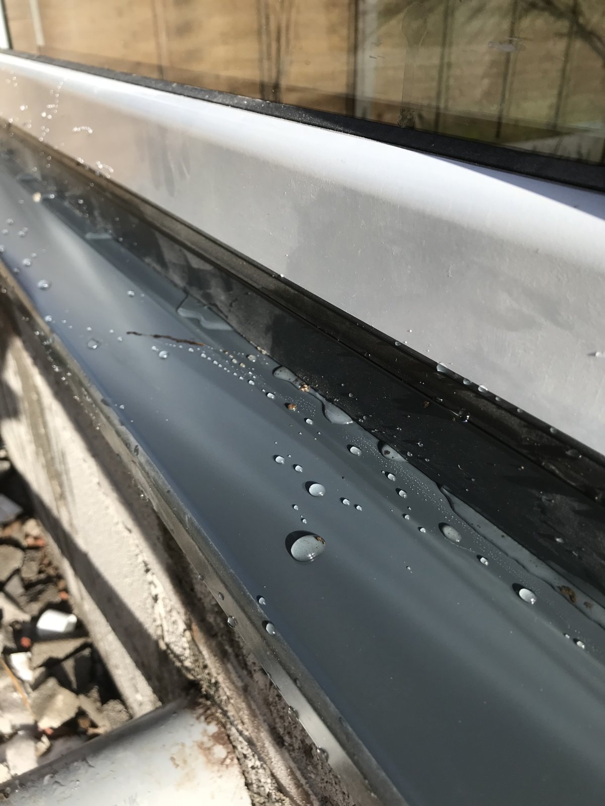

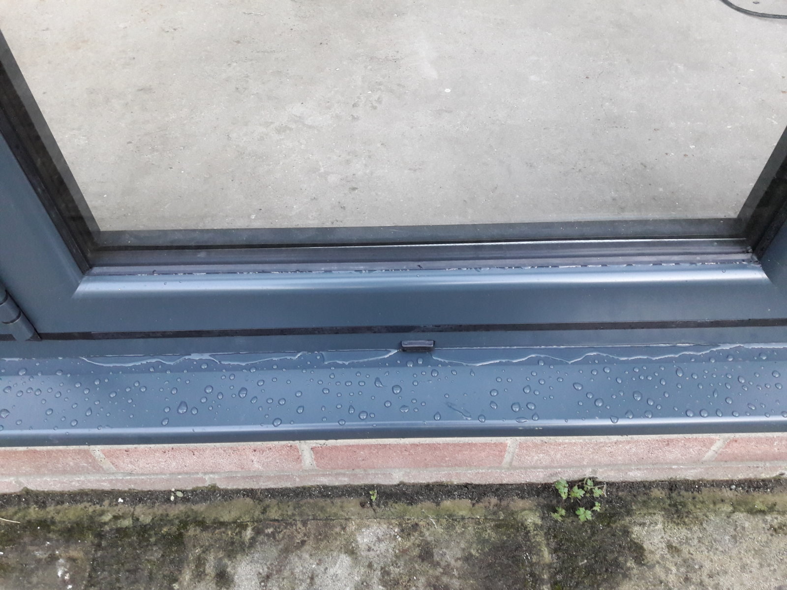

Those droplets are holding because of capilarity and the factory finish of the new plastic. It will wear off and then less drops will remain , but there is nothing wrong with what you have stated in those pictures.
You are not getting fobbed off, and that is not incorrectly fitted. The installers should be paid.

Yes, but the cill is not horizontal hence the problem. The drops aren't on issue its the water pooling against the frame due to it not being horizontal.

The sill is designed to drain, this is normal.
Had the manufacturers rep round, they're looking to change the cill they use as it's always a complain from customers.
With some off cuts of frame and cill we ran a few tests and even with the cill raised too high the water didn't drain off, which as said earlier is probably to be the lacquer from the plastic.
