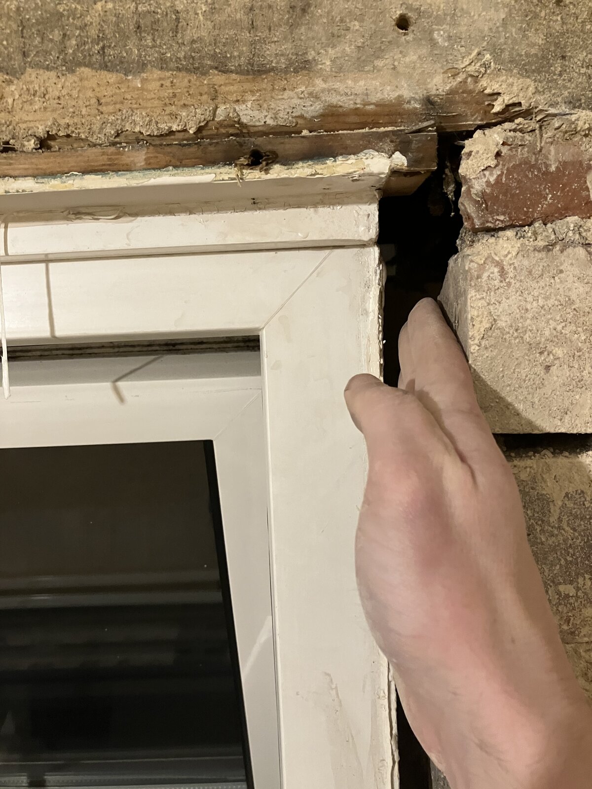

Hi all
Hope you had a good long weekend.
I've stripped our box bedroom back to brick ahead of getting insulated plasterboard fitted.
In doing so I've found that there is a big gap between the existing window frame and the surrounding bricks (see picture IMG-0410.jpg).
Is there a reason it has been left like this, or should I fill the gap with something? If you suggest filling, what should I fill with?
Andrew
Blimey, whoever fitted that window was an amateur, I can only suggest that you have another one fitted of the correct size or if needs must insert a piece of plastic board followed by a suitable sealant from a gun to stop any draughts.

Thanks for coming back to me Eccles.
I’m trying to avoid replacing the window for now as I don’t want to have one odd window that doesn’t match the rest of the house. My plan is to do the whole of the house with matching windows at the same time. But this includes two large bay windows so will be a large cost that I’m trying to put off for a few years!
if going for the temporary fix, would you secure the plastic board or just try and cut it to size and wedge it in?
Thanks again
You don't need to replace the window, fill the gap with expanding foam. Google 'expanding foam for windows' and take your pick.

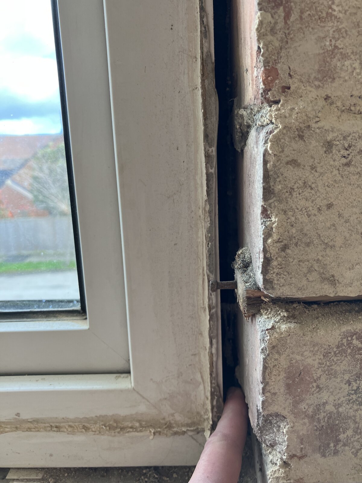

Appreciate everyone’s input. Here are a couple more pictures. The one I originally posted is the largest gap (top right hand corner). At the bottom right hand corner I can only get a finger in.

How's the gap on the outside?
Is it visible, covered with a trim or sealant, non existent?
That sort of gap is totally standard in older houses. As others, expanding foam is best (messy stuff though, if it's your first go with it well worth masking off the frame & glass so you don't get foam where you can see it)

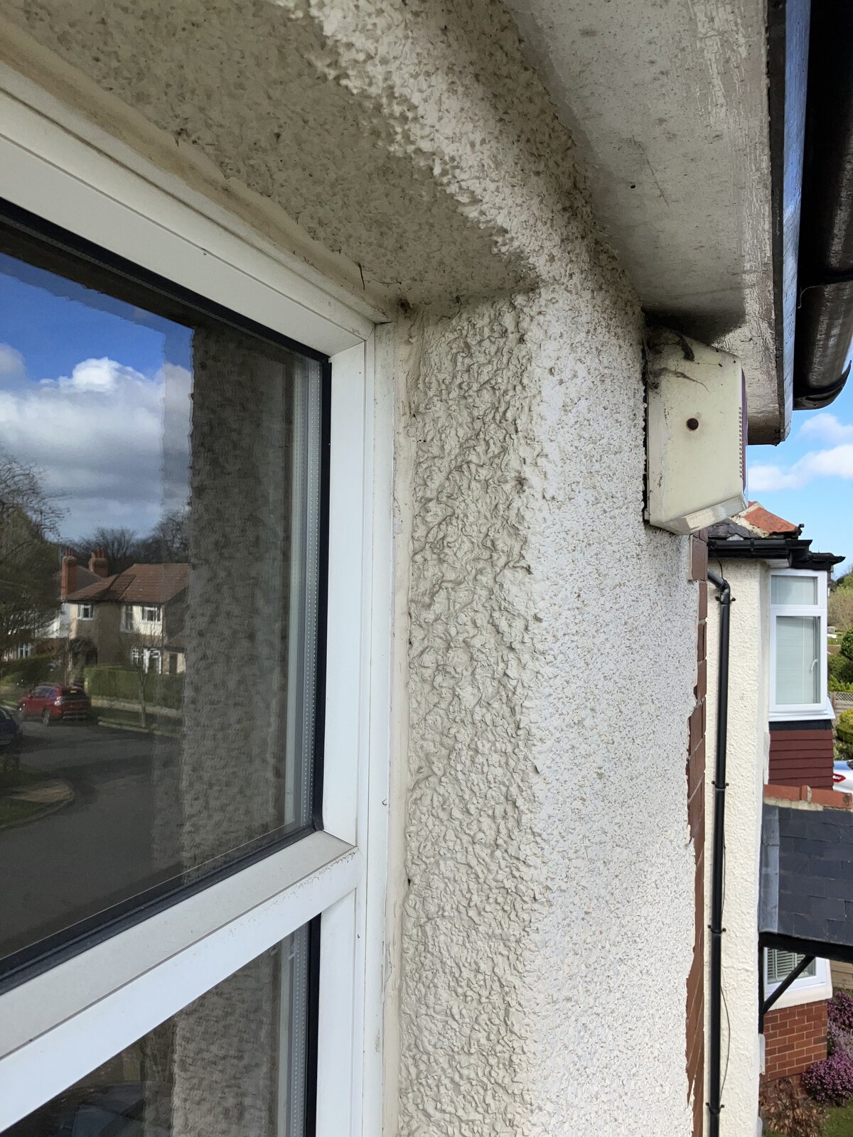

From the outside I can just see pebbledash / render and sealant (see picture).

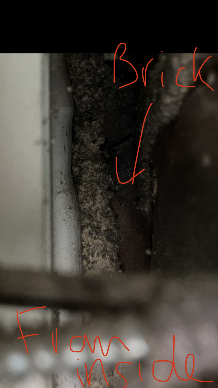

When I look through the gap from the inside there isn’t a lot to see - I can mainly just see what looks like glue and cement (possibly pebbledash?) - but where there are gaps in the cement I can see a bit of brick - so it looks like the outer course of bricks has a slightly smaller opening than the inner course of bricks.

Well, in that case, mask windows and walls around the gaps and use expanding foam to fill the gaps.
Careful with the foam, it expands a lot.
So follow the instructions on the can and spray a little all along the gap.
You will see it filling the whole space in a few minutes.
Have a little practice on a small bit first if you wish.
Once cured, cut all excess off with a flat knife or leave it for the plasterer to sort out.
In fact, plasterers usually have experience with expanding foam, so leave that job to them.
They shouldn't charge more than the cost of the foam.

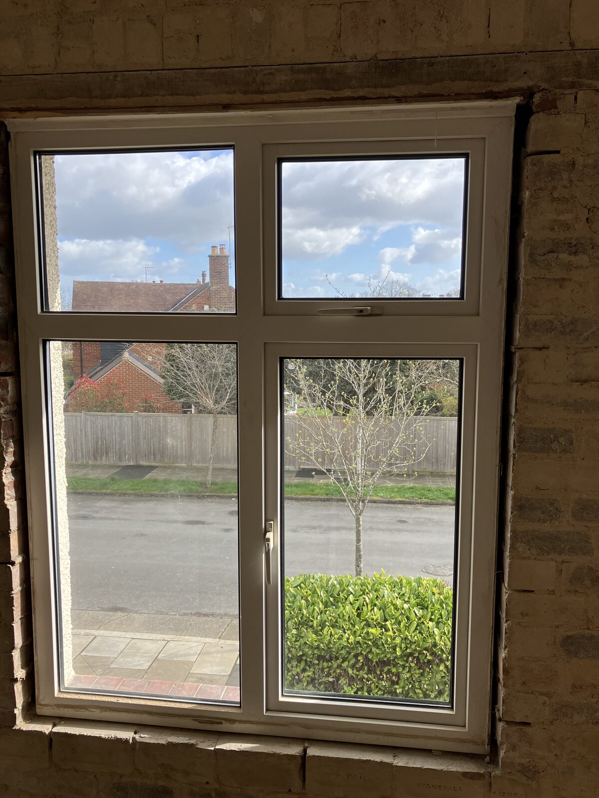

so window is the correct size
I guess you are having plastered walls internally?
in which case, fill gap with foam, use insulated plasterboard on the reveals to take up the gap
by the way there appears to be no damp proof arrangement on the reveals -I suggest some DPC vertically against the brickwork but bent around onto the window frame, then put plasterboard on, then once plastered cut back DPC

That's the inside of the window.
It won't be exposed to the elements.
