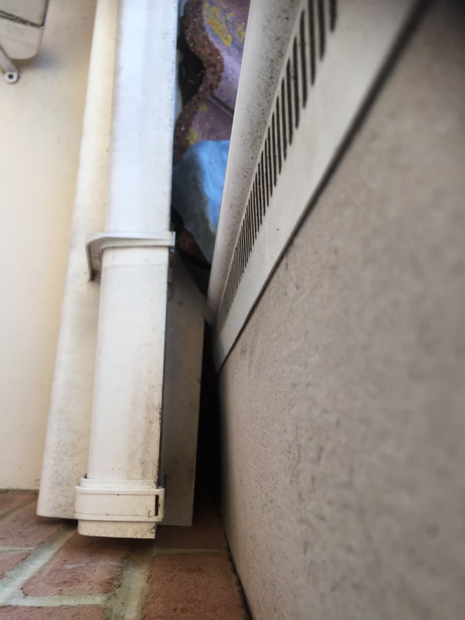

Since we moved in starlings have always nested under the tiles however this spring they have managed to work their way into the loft. I am on having the tiles refitted by a roofer and the cement reworks so there is no gaps plus install an eaves comb filler. Question is after doing all that will this gap in the picture give them access directly into the eaves and therefore the loft? What is the best way to fill this gap, it's about 20cm long and 4cm gap at its biggest end.

A bit of scrap eaves vent or any mesh could be grip filled or screwed into place
Or a bit of scrap upvc
Or random wire wool/ chicken wire stuffed in
Hello mate thanks for the reply. Ended up have a roofer come round and re cement a few tiles down in certain places!

I had similar problem 2 years ago Starlings waking me at 5am, I let the chicks fledge & used chicken wire to fill the hole.
