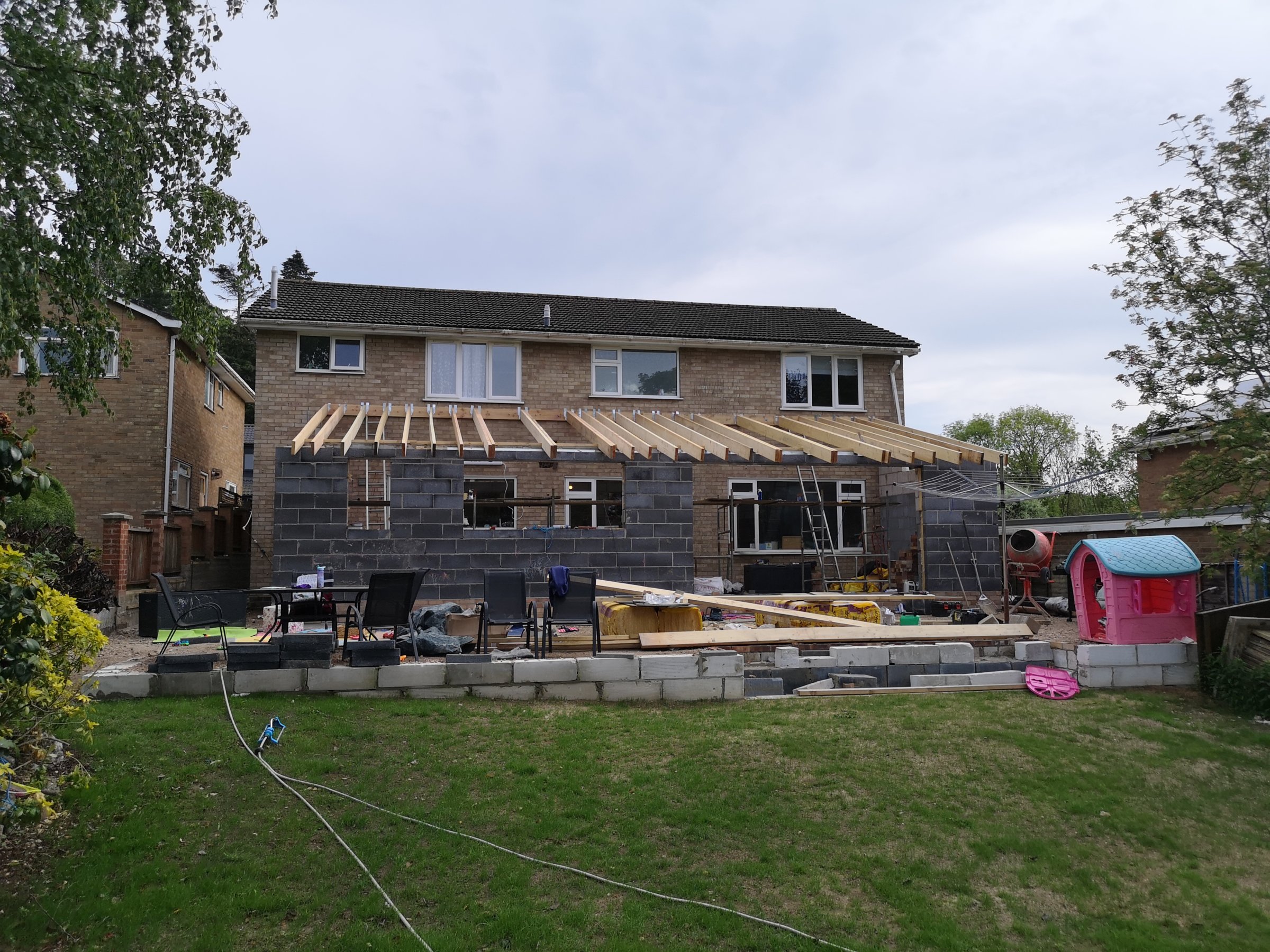

Is it really that simple? Isn't it about shear strength at the end, versus overall deflection, and the notch is only going to affect the shear?
What's the span on the rafters, ann20?
Yes I agree that it isn't as simple as what Woody says. The span extension is 3.4 meters so rafter length is about 3.5...
So looking at some tables it would seem that my span of 3.4 meters only requires a 150 rafter at 400 ctrs and I am using 197 rafters at 400 ctrs so cutting 50mm out as I have should be fine from what I can see.

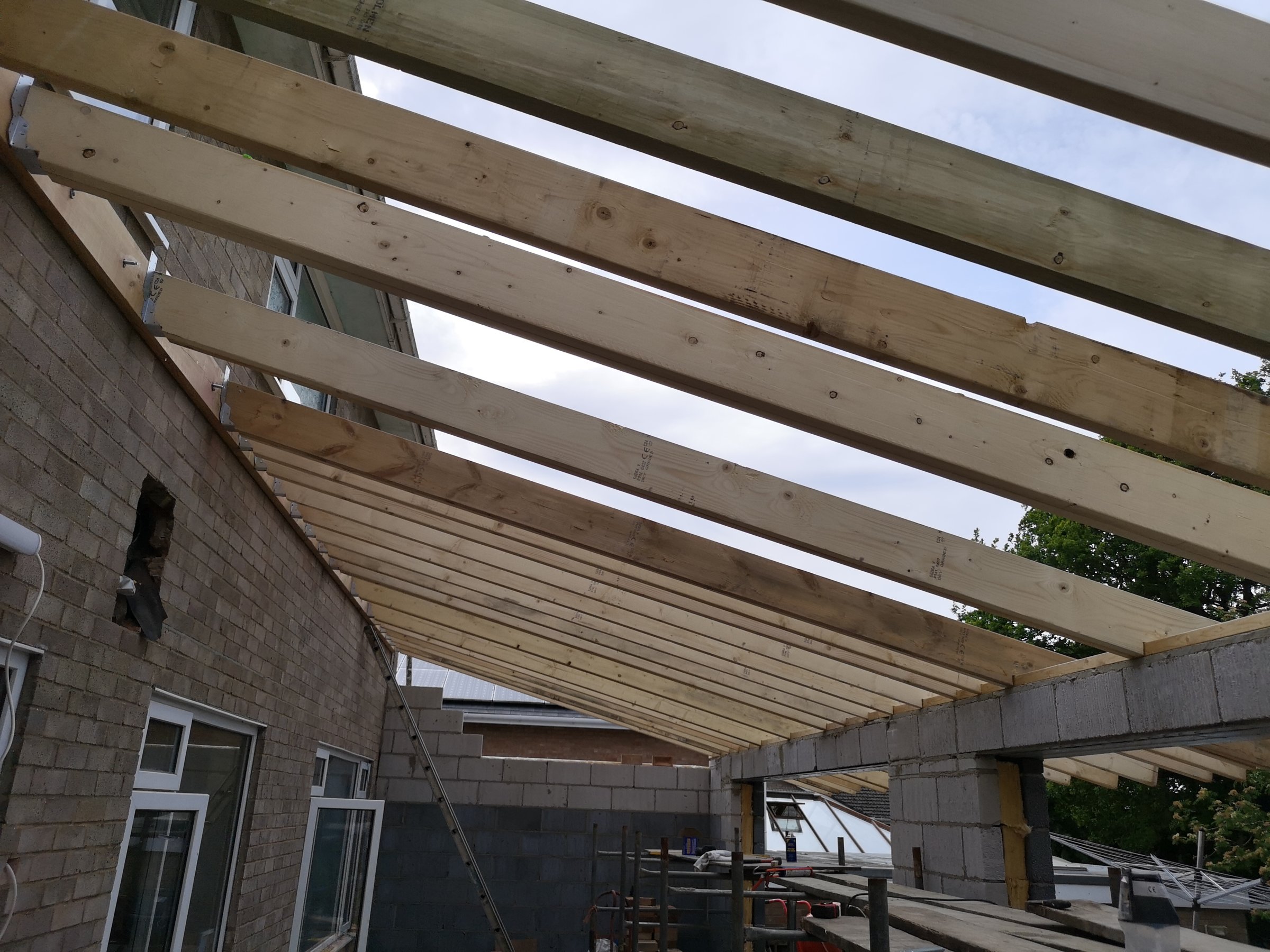

I was thinking.... Many people seem to secure the top of their rafters on a lean to roof to the header plate with 4 nails (two each side). This fixing method must have the same effect as my cut that I'm talking about as the nails do not pick up the bottom of the wood. I will be using hangers (which will need a small notch taken out of wood to work).

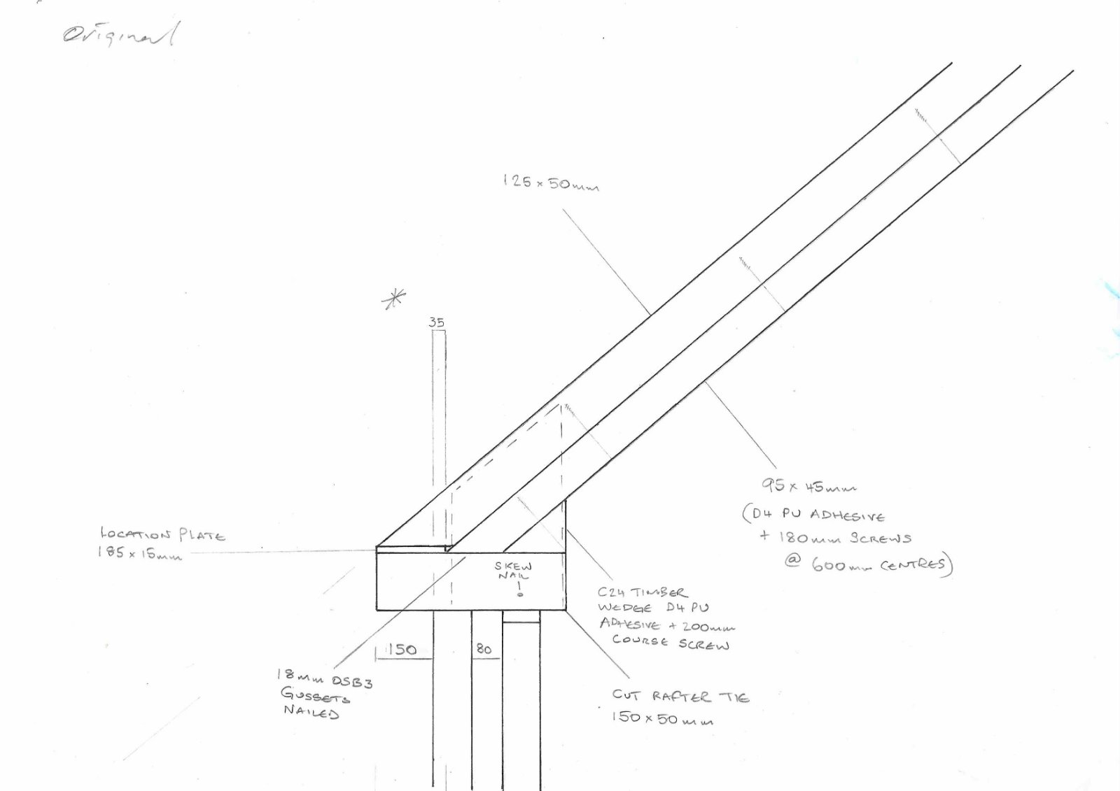

apologies for bringing an old(ish) thread back to life, but does this look okay or...? I've emailed this sketch to my BCO for his input. The house has a new cathedral ceiling and originally, the roof had lightweight cement tiles. I want to install CUPA H3 Slates which work out around 49kg per m2, opposed to around 18-19kg per m2 originally. I guess the important detail is how much of the weight the rafters carry actually transfers through what remains of the original rafter/ceiling tie onto the wall head - works out about 35mm, indicated on the sketch. The roof is at 40 degrees, the rafters are around 5.4m long and go over a chunky ridge beam (115x495) with small collars tying opposing rafters above the ridge beam. I just wish the location plate between the rafter and rafter/ceiling tie was wide enough to completely span the joint between the rafter/remainder of the ceiling tie but as seen on the image, it's short by around 10-15mm. I would value any input, while waiting for my BCO to reply
