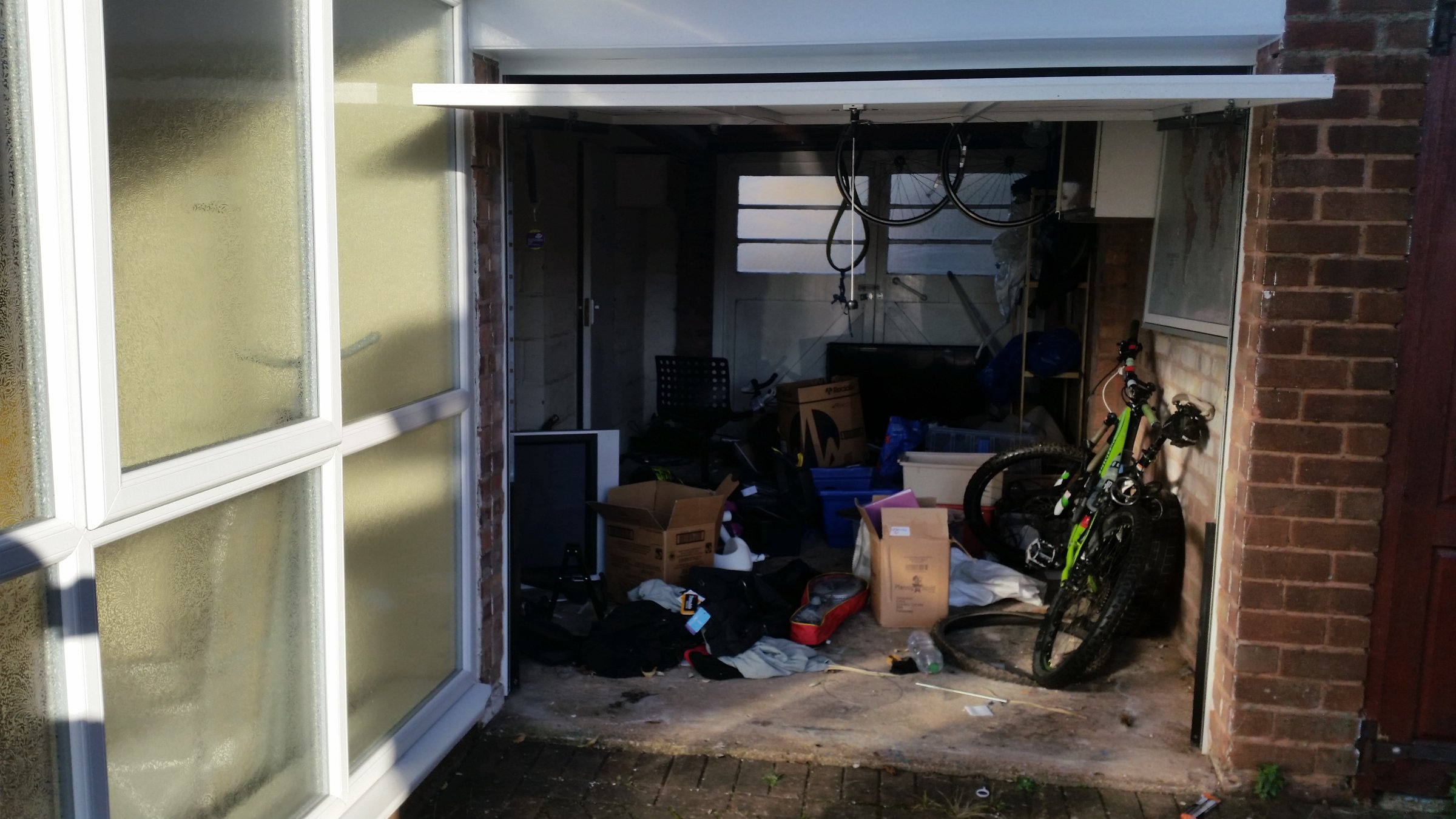

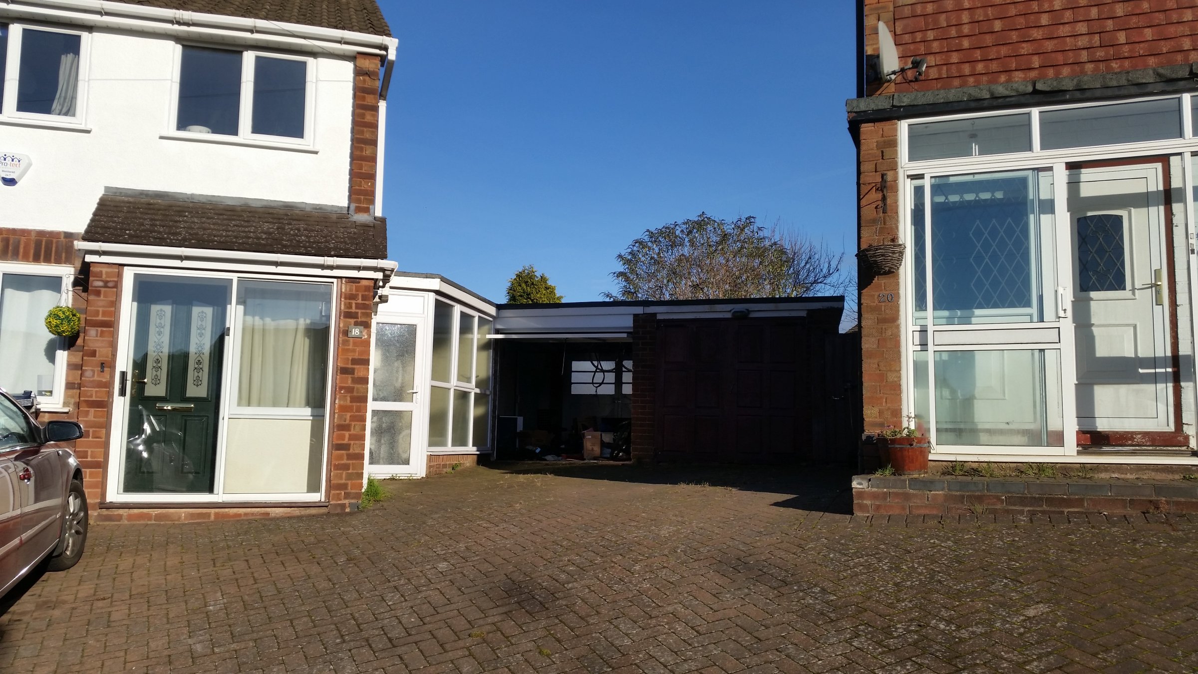

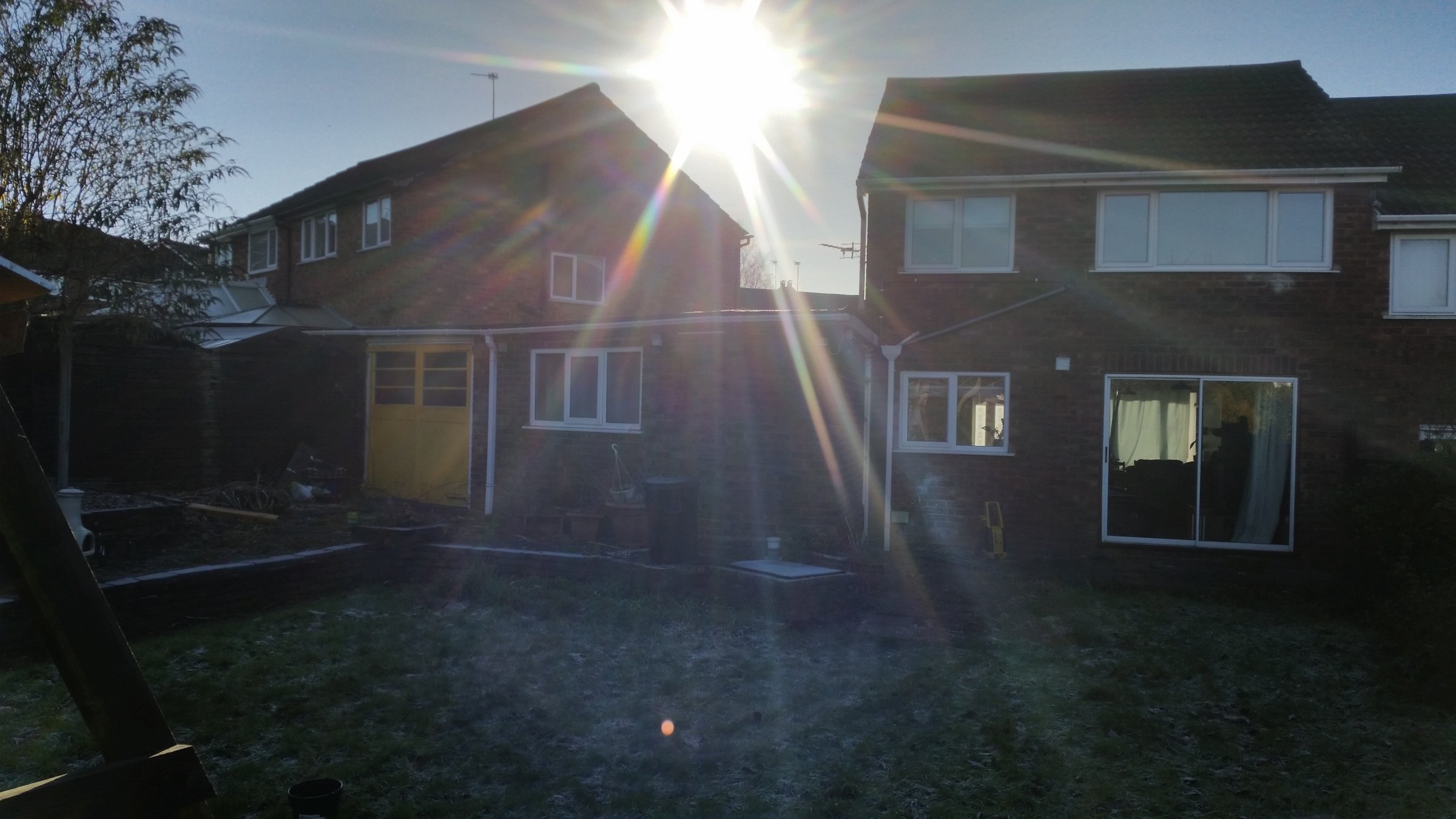

hello, id like to add a 4th bedroom and ensuite onto the house . i gues my options are aode extension over single leaf garage (steel beams to maintain width of garage and provide neccessary support?)
or a more expensive rear two storey extension ..

anyway, i just wondered what would be feasible ? ideally id like to get a forth bedroom with ensuite as economically as possible to add value, with a lodger paying for the increase in mortgage :)
so firstly i need to get an idea of feasability and a quote for either above garage or rear extension
would a builder be able to advise on this or do i need to go to planning /architect?
does anyone local have any recommendations?
kind regards :)
You will have big problems with getting a first floor extension on that garage past Birmingham planners, due to what looks like a very awkward connection to the house - ie it wont look like an attached subservient extension, but rather like a big extension distant from the house.
You need advice from an experienced designer first, who can comment on the planning aspect.
The technicalities of building it are relatively straight-forward.
