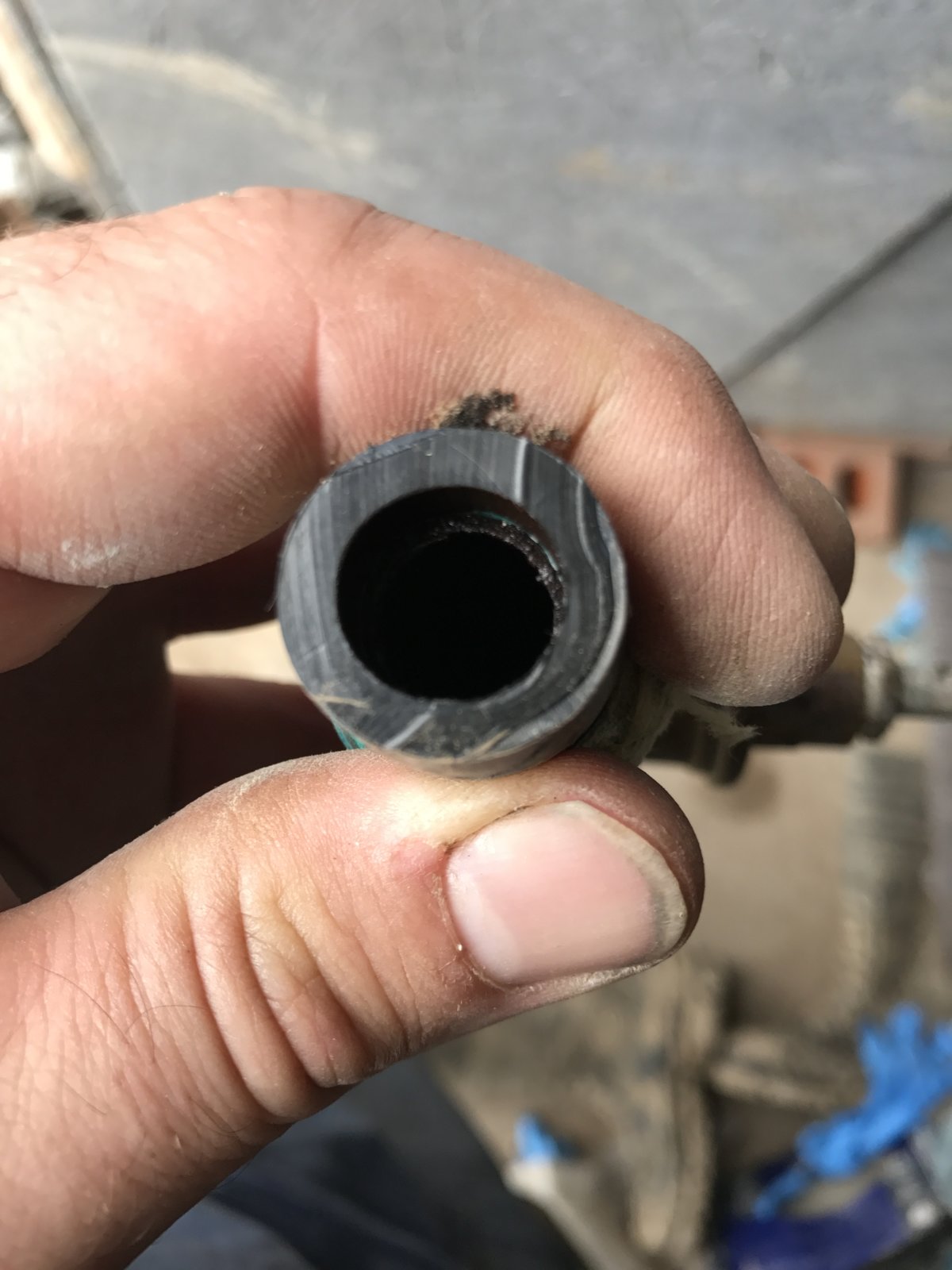

Black thick walled water pipe?

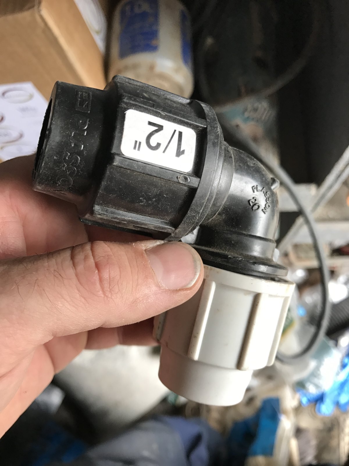

Does it look like this:
There are Plasson fittings that are made for the black, the most common size is called 1/2" but it's more like 22mm. I've seen joints on it that are 22mm compression fittings. When we repair the black we use these:
That's the one yeah!
Just having a look at the fittings, so much choice.
Does look like it could work? Im trying to find a connection where I could black pipe to copper or plastic water pipe for in my garage but the one below I could connect to a small piece of blue mdpe and then I can get the fittings more easy.

Those ones aren't as good. We use those for lead and steel.
