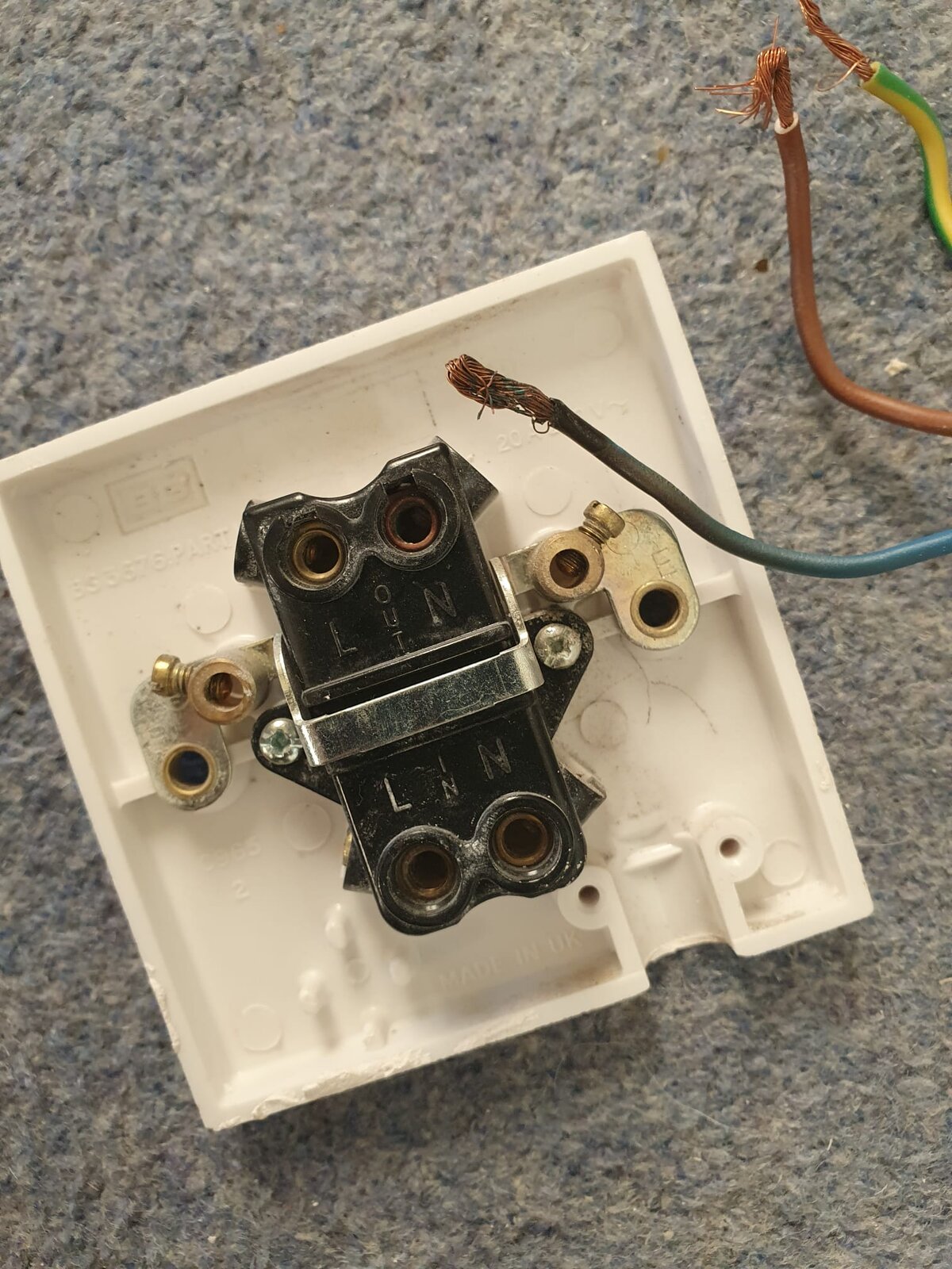

Hi, I've just had to move a storage heater temporarily. When removing the wiring from the switch I notice the live on the storage heater cable has blackened and stiff (see photo). Any advice on how to proceed? Can I troubleshoot this as a DIYer or is it for a pro to deal with?

Thats the neutral cable and yes the problem was overheating of the connection or contacts. Buy a new quality DP 20A switch, cut the cables back to good copper and re fit. Make sure your screws are tight!
Oof yes, neutral – brain fart typo. I'm not that stupid honest.
So the problem is likely to be the connection/contact and I can safely replace with new switch.
If I don't have enough existing cable what gauge do I replace with? Heater is 1.5KW. Current cable copper diameter is roughly 1.6mm but obviously stranded so not sure how that converts.
The incoming cable will most likely be 2.5mm2. The flex poss. 1.5mm2. 1.5mm2 will be fine for a 1.5kw heater. The sizes are the square area of the conductors not measured diameter. If replacing flex best to use heat resisting type, sometimes called butyl.

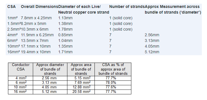

The first table below relating to T+E cables is the one I put in our wiki, and it includes an approximate estimated 'overall diameter' for the stranded live conductors of 4, 6, 10 and 16 mm² conductors (just 7 strands in all cases). As can be seen from the second table (which I've only just produced), the figure seems to be almost exactly 78% in all four cases. One would probably expect (despite the above!) the percentage to be higher (than that 78%) with much larger numbers of strands, such as the typical ~30 strands for 1.5mm² flex.
