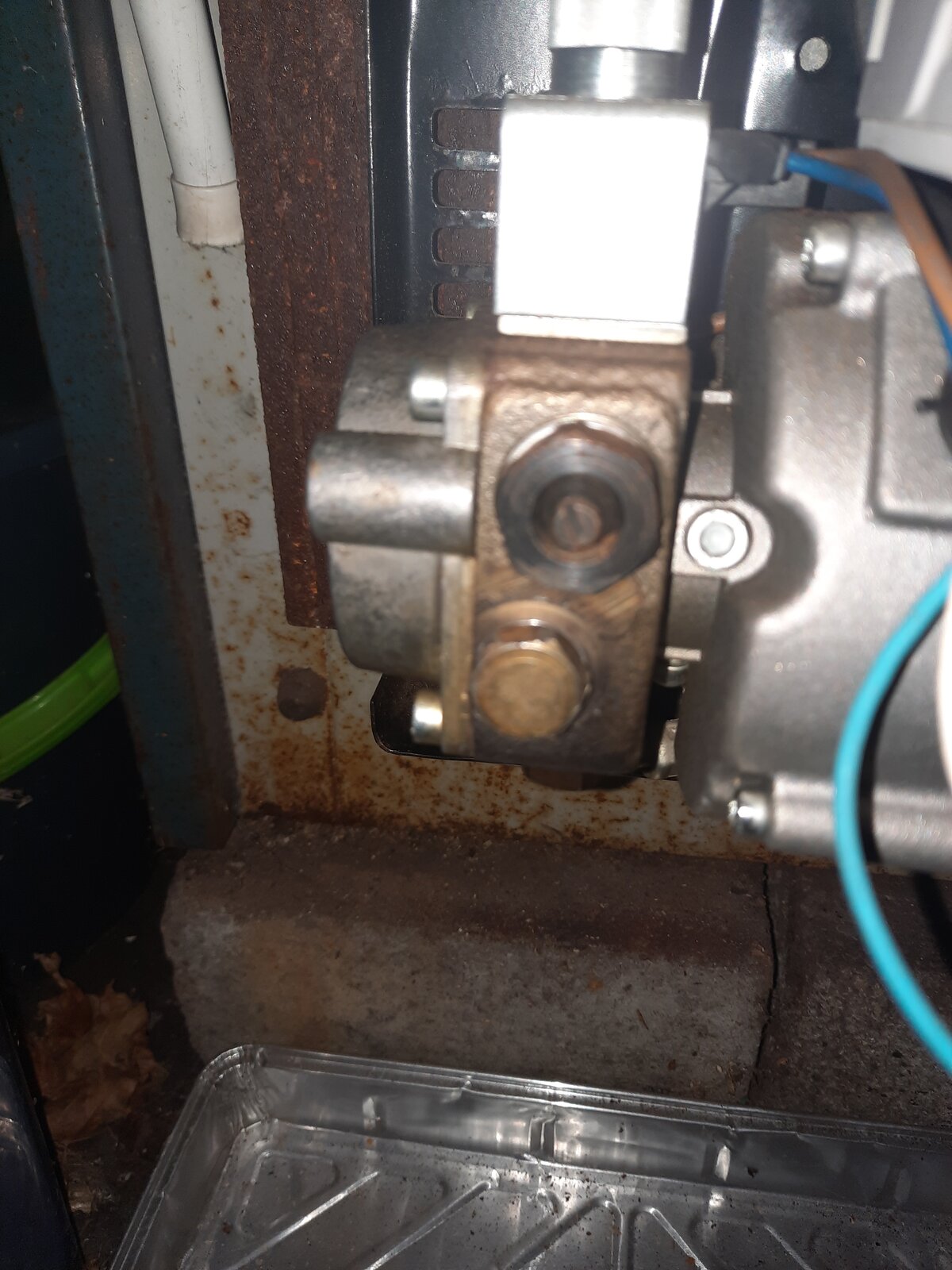

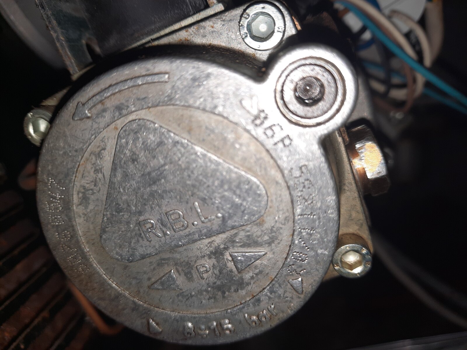

Hi,
We ran out of oil and got a delivery but the boiler still won't start. I've reset the burner and no luck. I've seen that it can be easily bled, but there's loads of different diagrams etc so not 100% which one is relevant to the burner we have. Can anyone let me know which part needs to be loosened, I think its the one in the second image? (Side of pump)

Yes, it’s the Allen screw you see on your second pic. Don’t touch the ones on the side, one is for pressure adjustment, the other for connecting a pressure gauge.
John :)
