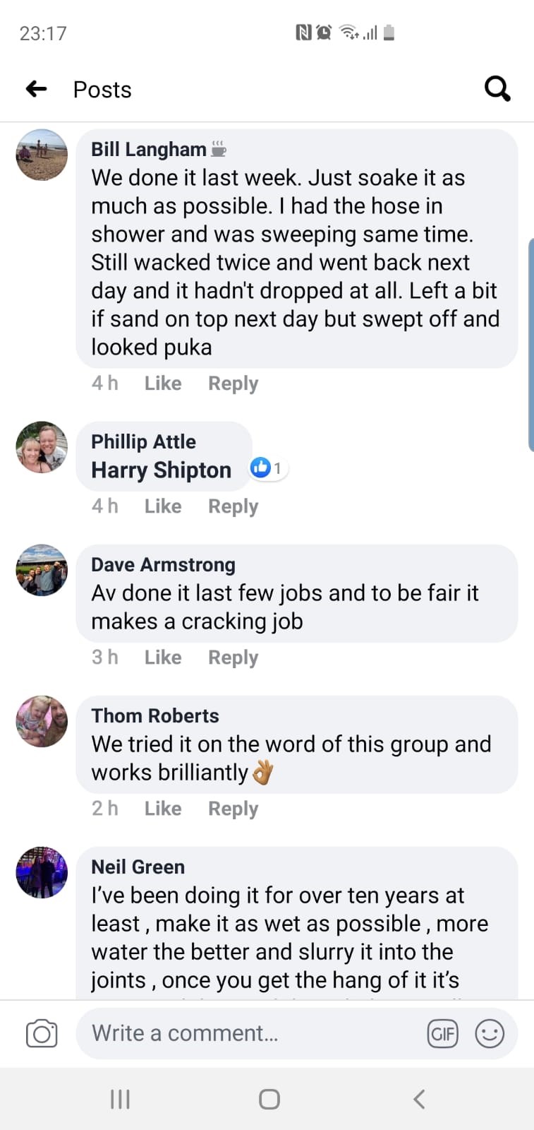

There is also a Facebook group - UKPavingTalkGroup that mentions the technique:
The problem I have is that the Drive will take at least a decent week of weather to dry, which I doubt we will get until the spring, and in the meantime we are parking 3 cars all around the cul-de-sac and getting heat from all the neighbours, but i still need to make sure the job is finished properly.

The sand needs to be dry when it goes in, else it forms air pockets. A slurry, funnily enough contains water which when removed leaves errr air pockets.
All this should have been done once the blocks were laid as the sand stops individual blocks moving and tipping. But here we are.
Work on drives, roads, paths etc goes on in winter and even after summer rains. Anyone doing this type of work that requires a surface to be dry will have some propane burners to dry the surface. Voilà. They wont refer you to a random internet post to validate they poxy idea.
